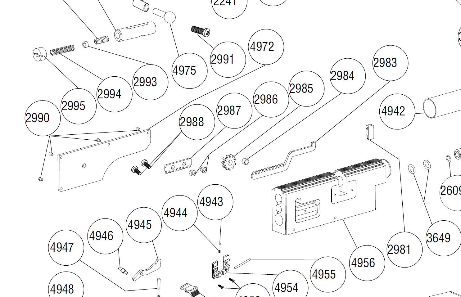

How did you get to the gears is that all accesable when you get to the hammer spring?, What would be the best grease for that stuff I have white lithium grease, fp10, ballistol, 3 in 1 oil should I buy another greas for this job I want my blitz running smooth an fast cant wait to get it im set on 25 cal them coyotes going down. Im trying to record footage of that with my one leaf would be fun full auto 41 round mag 25 cal.
Here is a picture from the exploded view document.
To get to the rifle cycling gear you need to remove part 4972, you just remove the 5 2990 screws, exploded view shows that it's 4 but look at picture below).
Once removed you will see parts 2983-2988, these parts together with the rod that goes next to the barrel is what cycles the rifle.
If I remember correctly the rod is connected to 2987, when it is pushed backwards the gear 2985 rotates and pushes 2983 in the opposite direction which pushes the bolt handle backwards cycling a new round in the chamber.
You can view the exploded view here: https://hatsanairgunsusa.com/wp-content/uploads/2020/12/Blitz-Exploded-View.pdf
In the picture below you can see the side panel I'm talking about. To the right of the Hatsan logo you can see the bolt that 2984 is placed on.
It's a very simple mechanic and once you see it you will understand everything I've described, pull back the charging handle and you will see it working.
all you have to do to get to the gear and where it gets contaminated with lead dust is remove the side cover.. I think it was 4-5 screws.. I wiped mine clean and used a thin high temperature wheel bearing grease from my shop..
to grease the hammer and sear it's one screw underneath to remove the stock and then two pins hold in the trigger group.. one is a little bit harder because it is also a spring loaded pivot point but it only moves about half a hole to the side.. not too difficult.
