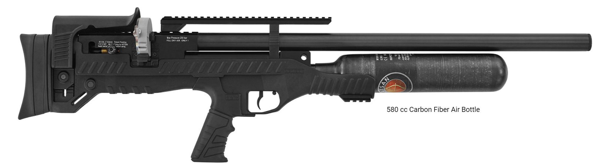

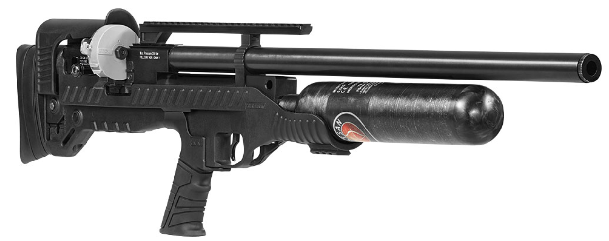

Here is info on the Blitz BP - https://hatsan.com.tr/product/blitz-bp/
I have the normal Blitz and it's basically a bullpup to begin with, it just needs another stock. I wouldn't be surprised if the body is identical and there is just a rod connected to the trigger mechanism like on most bullpups.
would be nice if we could buy the stock and try it on our own blitz.. I've personally never handled or seen any bullpup in person.. just pictures..
