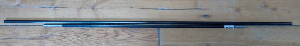

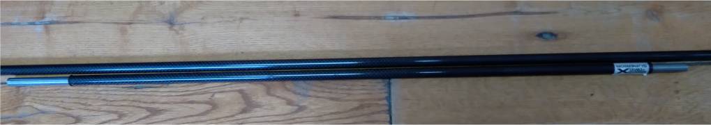

Big, here are my results using the cf tubing I got from Japan. Highly precise tubes. I put them on a Brownell's liner first, and later an Fx. superior Heavy. these in .218 FX and .223 Brownell's.
None are tensioned sadly.

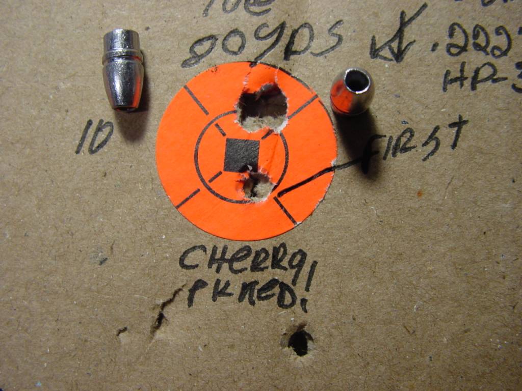

Group is at 80 yards. One shot for reg settling and 10 on target. My own hand cast from the NOE CC1 mold which I customized to be a hp mold.
The Brownell's barrel shot this group. It does like to throw a flier every once in a while. well, too often.
The FX barrel is just as accurate if not more so, but very few fliers. I did have to remove the choke for this type of results.
The Group is marked "Cherry Picked" which it is, simply because in a 10 shot group, it likes to throw a flier. The FX on the other hand does not have to be Cherry Picked. It doesn't like to throw fliers at all.
This was shot from the Raptor, 22" bbl, 930's with slug weight @ 34.7 average. The CF tubing really does make a huge improvement. Not only in groups, but day to day poi stability as well. ;<)
Mike/Knife
Bottom hole in one target was from another gun and target.
I did cull slugs which were much nicer than the ones shown. They are culls.

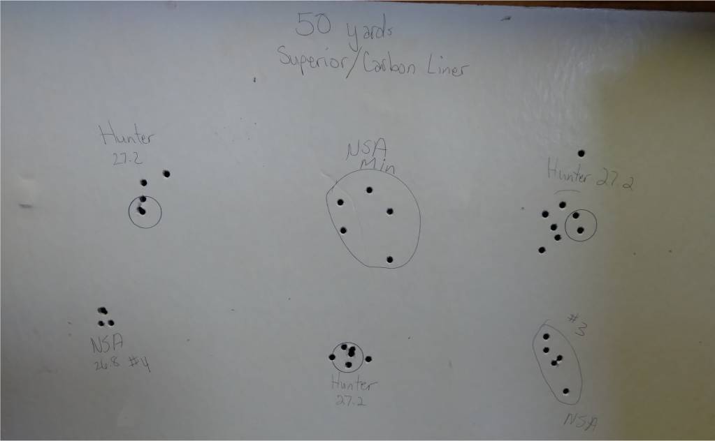

That NDA group looks really good! I know the superior liners like NSA slugs and that group might not open up much at 100!
try to do a 3-5 shot group per power dial setting, my experience is the group for the entire range tightened up considerably after the carbon sleeve for the liner. Before the sleeve some of my groups can’t really be called groups they were so bad.
