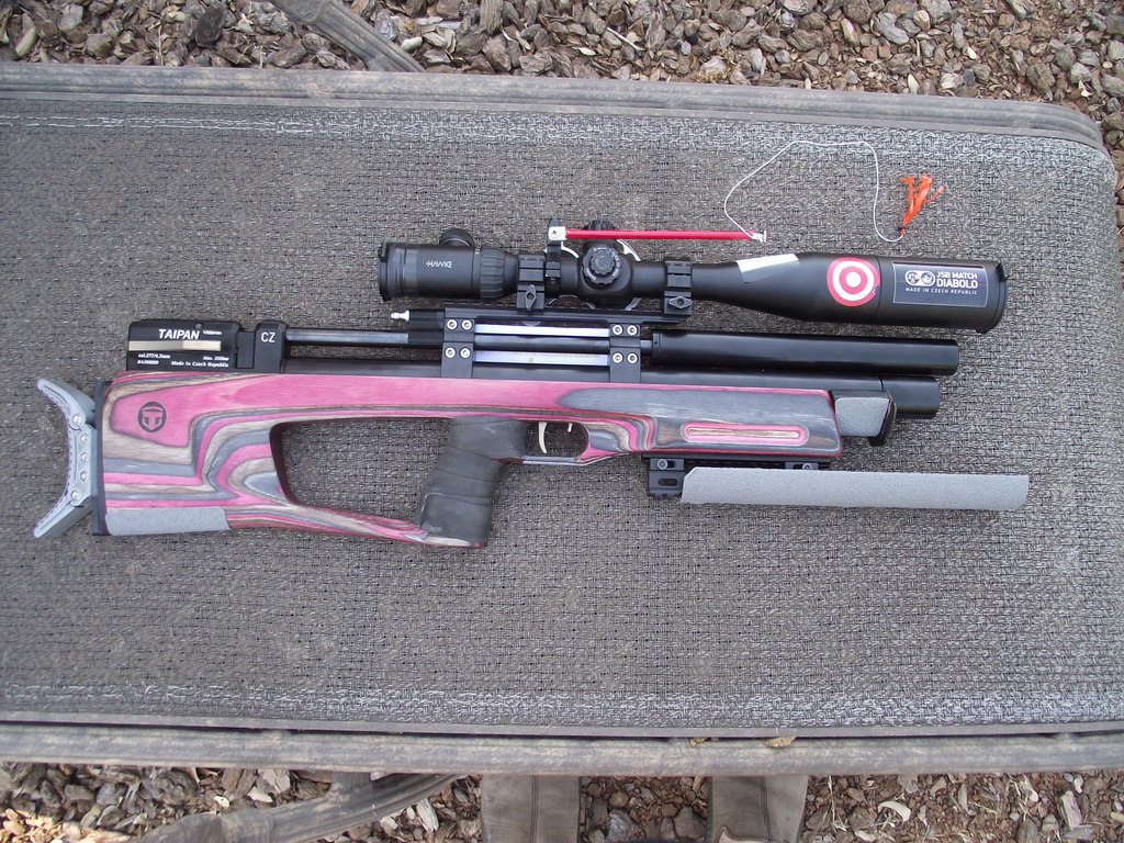

Does everything on my rifle look OK for HFT?
Hey all, not sure if this is the correct place for this. Just curious if a knee riser like the one I made is ok for HFT use?
Thanks

For Hunter you're allowed six inches of depth, from the center of the barrel to the bottom of the riser.
Visually, that looks close....
Is the peg to use as a stop for the bipod? The way the rules read, that peg counts against you for depth....But hopefully somebody else will come along with their interpretation of the depth rule.
"Fore end depth is limited to a maximum of 6 inches, measured from the center of the barrel to the
lowest part of the rifle forward of the pistol grip."

Yes it is for a stop, if I trim it to just the acorn nut I'll be under 6 inches from center of the barrel to bottom of the nut.
I appreciate the clarification about the stop counting as well.
