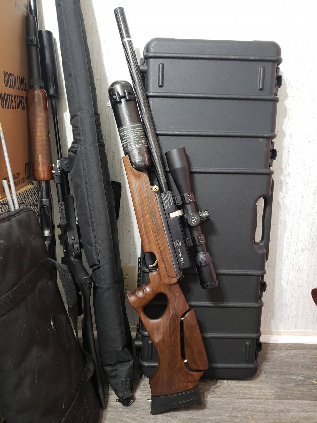

You are correct about the 20moa rail. They are nice so you can get the lowest bore axis possible with a magazine inserted. I have a 0 moa rail (Mk1 Continuum) and I ditched my adjustable rings and magazine for an even lower bore axis. I just use a single shot tray. Or a hatsan magazine, lol. Nova star mag fits over the barrel and is snug there, but isn't snug on the underside. Regardless, it stays put, and it works. And I can lean it way over on its side in the crown.

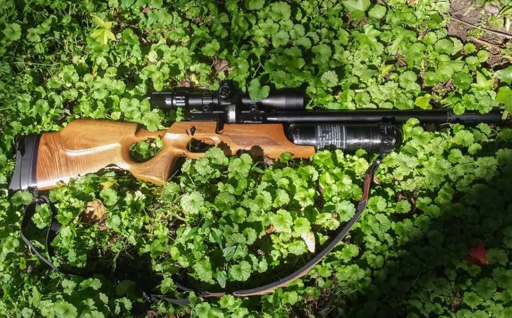

I run the eagle vision rings on mine and the wife's crowns....For me it comes down to being able to max out my "Up" adjustment. When I set my ZERO stop I like it less then 1 turn from bottoming out. Since I dial it makes it easy to get back to my zero without having to remember how many turns from the bottom I am zero'ed at. I have a Vortex Golden Eagle scope and for me to get 150 yards out it is over 2 full turns up....With the adjustable rings I have no worries at all, plus to use the FX mags the adjustable rings can be set up to the lowest possible position for the mags to fit under the scope.....We have never had an issue at all with the adjustable rings.
Everybody's "long range" is different. When I started for me it was 50 yards, now 150 is doable.
