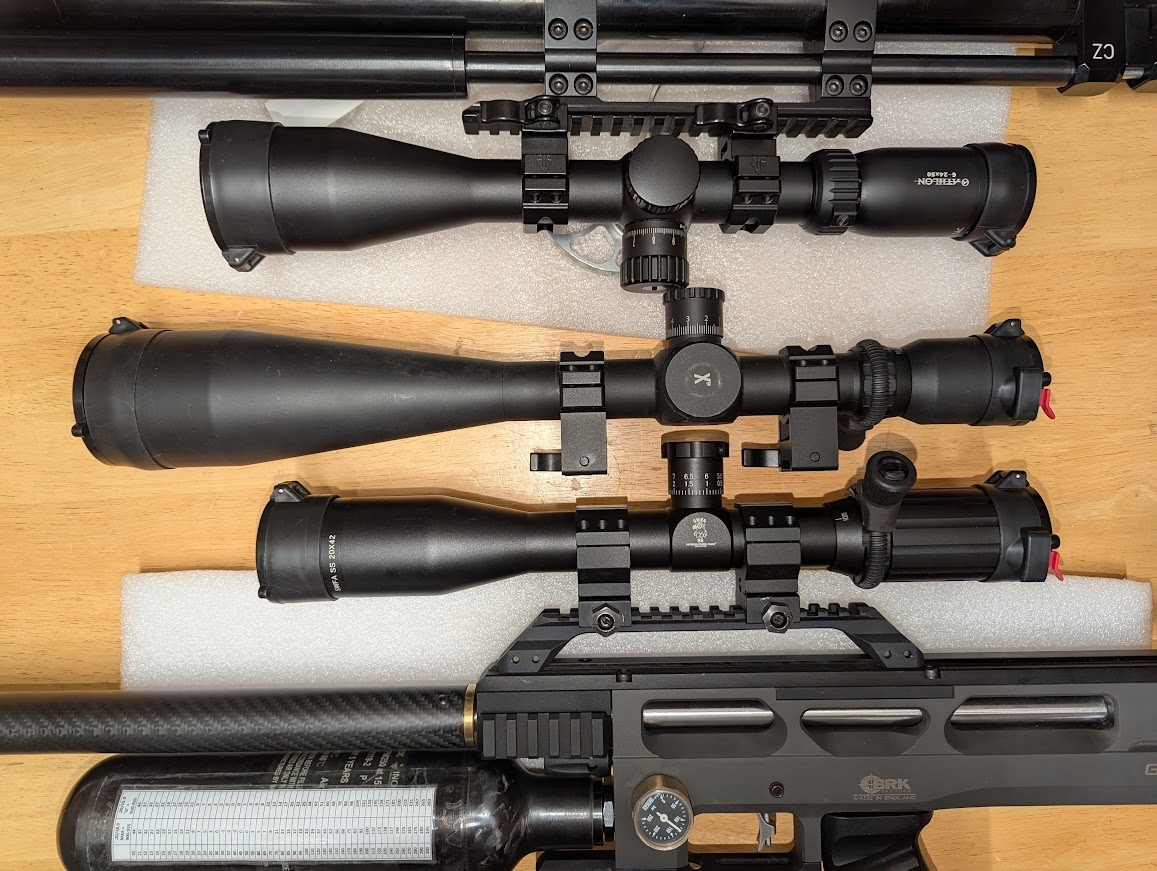

@Franklink ... have you put your eyeball behind the Sightron 4-20x50 S-Tac? It almost tics every box for you except as listed:
weight 25.6 oz - yes i know you'd like 22 oz but 3.6 oz is meh.
length is 15" - i know you'd prefer 14" but 1" is meh
.1 Mrad with 23.3 Mrad range of adjustment
no christmas tree - I prefer the MH4 reticle
ffp with IR
image quality, at least to my aging eyes is very good (at least for field target)
$can be had for $570. on sale or less in classifieds.

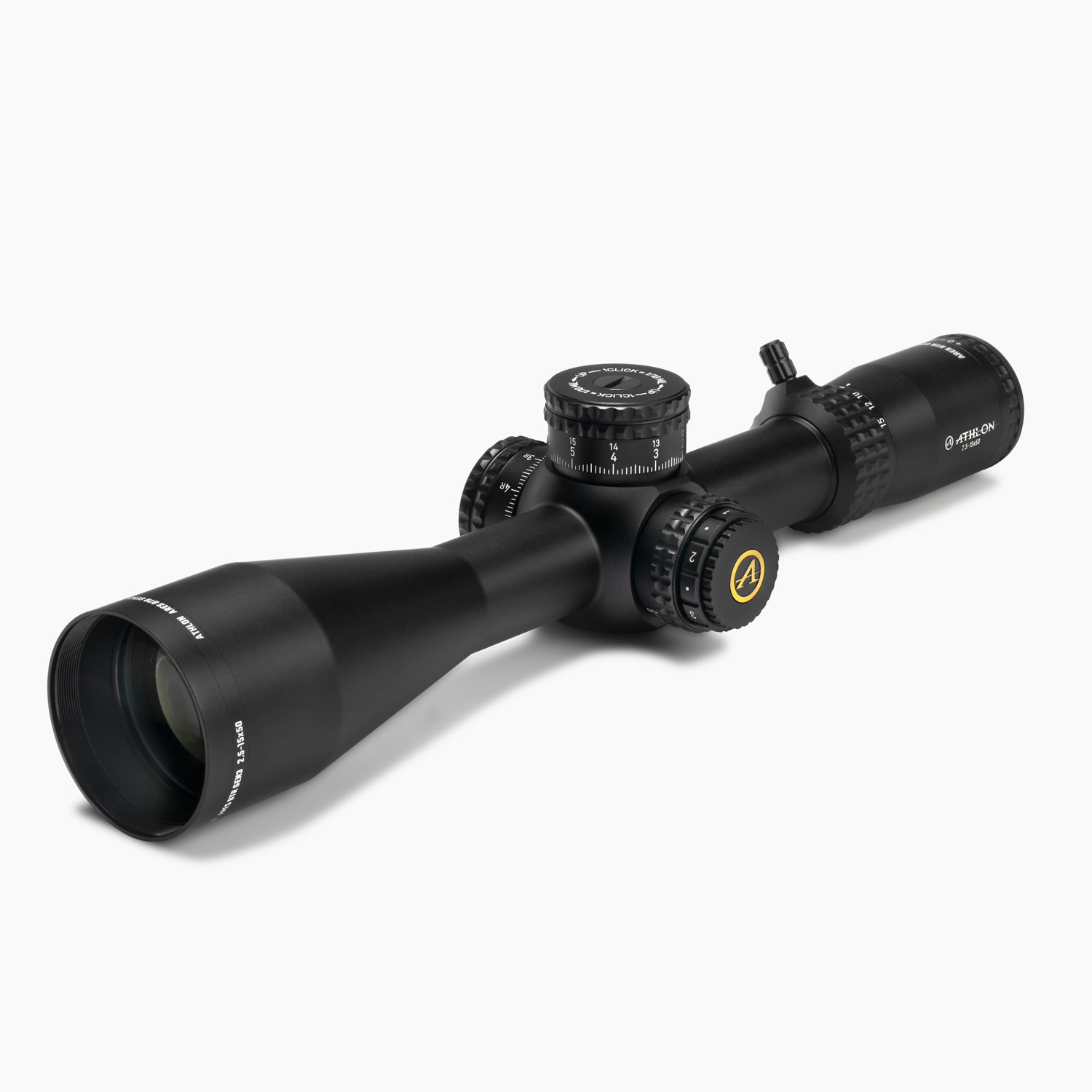

next up is a recent acquisition:
Athlon Ares 2.5-15x50 BTR Gen 3 FFP / IR
although a christmas tree type reticle everything else on this scope is to my liking
weight 27.3 - 5.3 oz more than you prefer.
length 13.8" - score
.1 Mil
amazing turrets
glass very good
disclaimer - i have not put a parallax wheel on one yet, but i anticipate it will spread out the numbers similar to all the other Athlons.

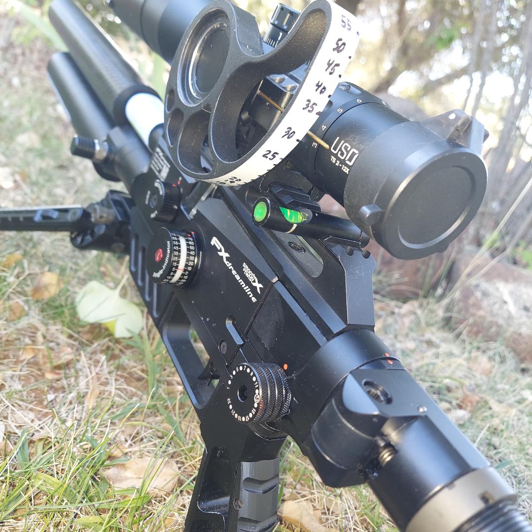

Although this is a 12X scope it is a much understated sleeper especially for HFT / EFT pistol class:
US Optics TS12X.
Magnification: 3-12x
Eye Relief: 3 inches
Diopter: +3, -2.5
Parallax Adjustment:10yd – Infinity
Field of View @ 3x: 100 yds = 30.41′
Field of View @ 12x: 8.33′ meters
Eye Relief: 2-3 Inches
Objective Lens Diameter: 44mm
Tube Diameter: 30mm
Overall Length: 9.6 in
Ocular Lens Diameter: 34 mm
Weight: 18.11 oz
Reticle Illumination: Non-Lit
Finish Color: Type III Hard Anodized Matte Black
Elevation Knob: Locking 1/10MIL
Elevation Travel: 30 MILS Total Travel
Windage Knob: Locking 1/10MIL
Windage Adjustment Range: 25 MILS (12.5L/12.5R)
Reticle: Second Focal Plane Triplex or First Focal Plane MHR

Ding ding ... we have a winner :love: (y)
It now resides on my Theoben MFR Hunter class FT pistolla

That new Ares BTR G3 2.5-15 is such a killer scope! Too me it came out great. Or perhaps the MT G2 which I suspect also being about the same in quality.

The “US Optics” TS12x isn’t a real “US Optics” scope…. It’s a Vector Veyron with USO badging.
