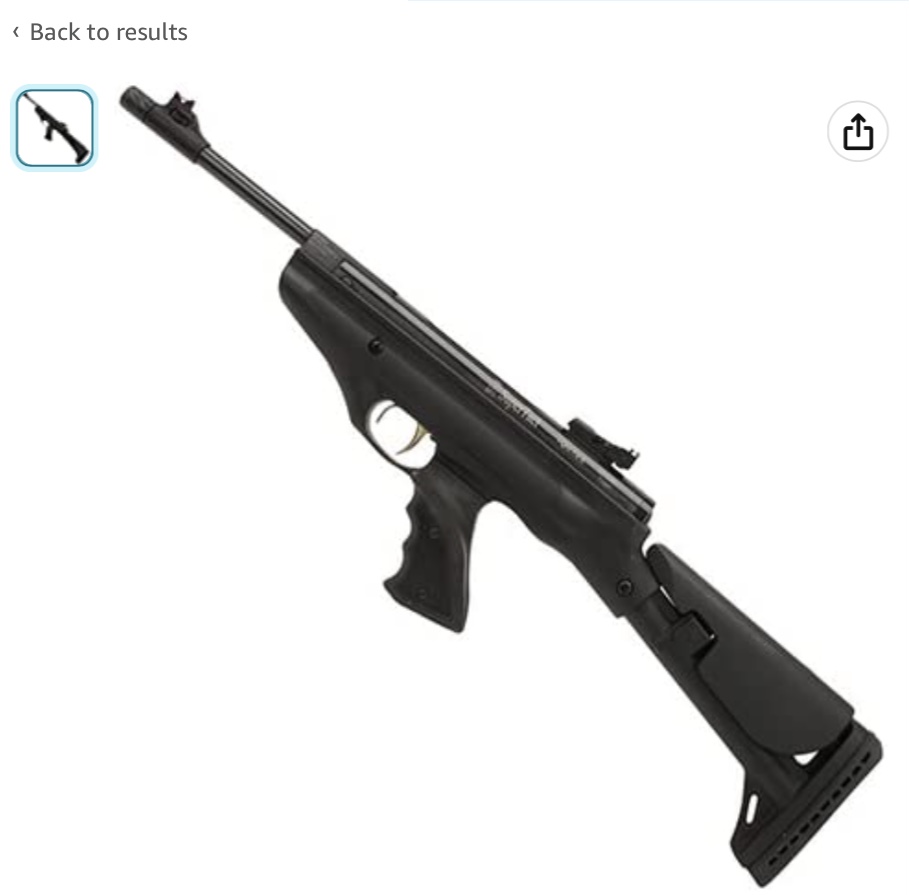

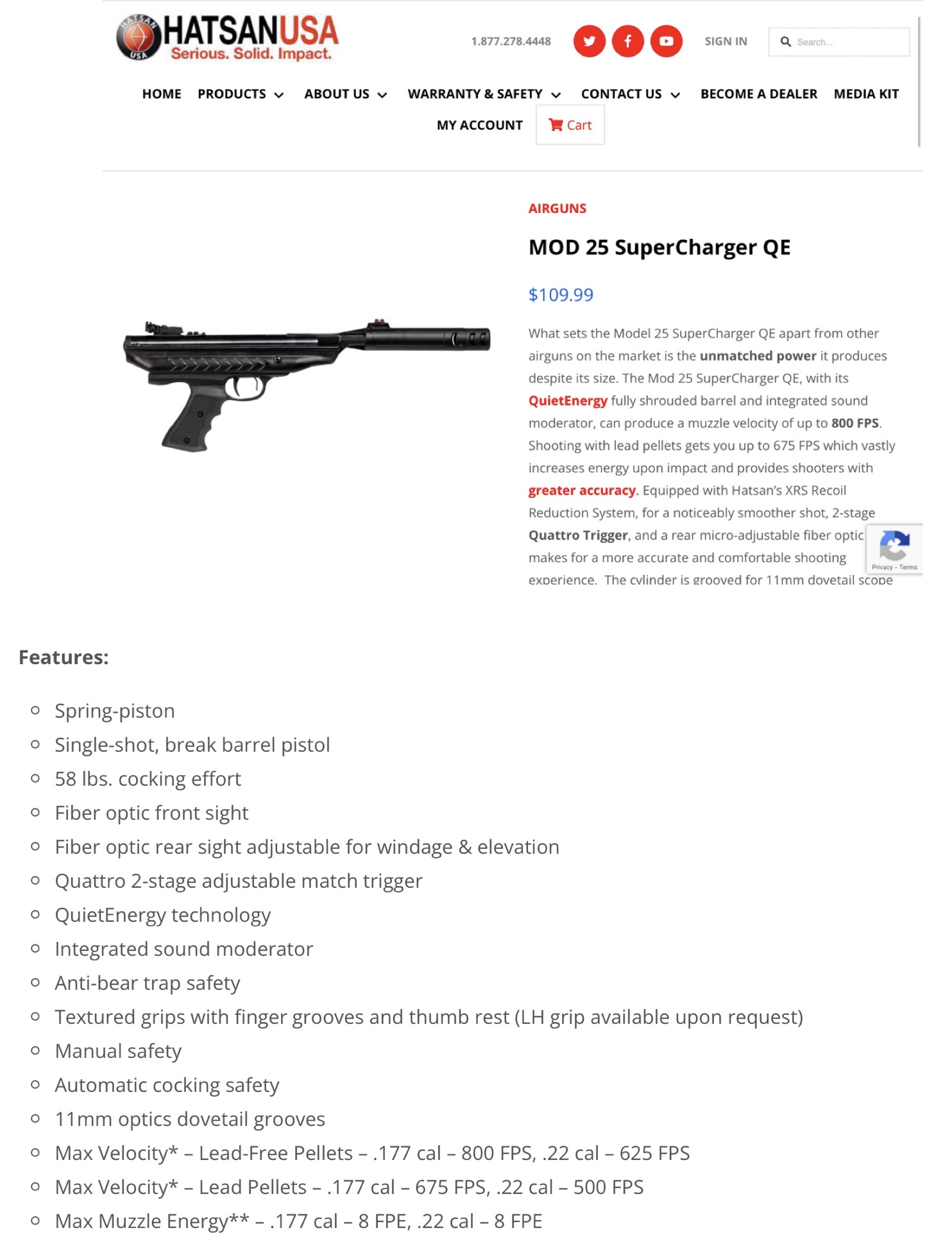

Most pistol power I know of in a barrel cocker. Quality or lack there of is the question. They are cheap though. Can be gotten in a detachable stock model also.
