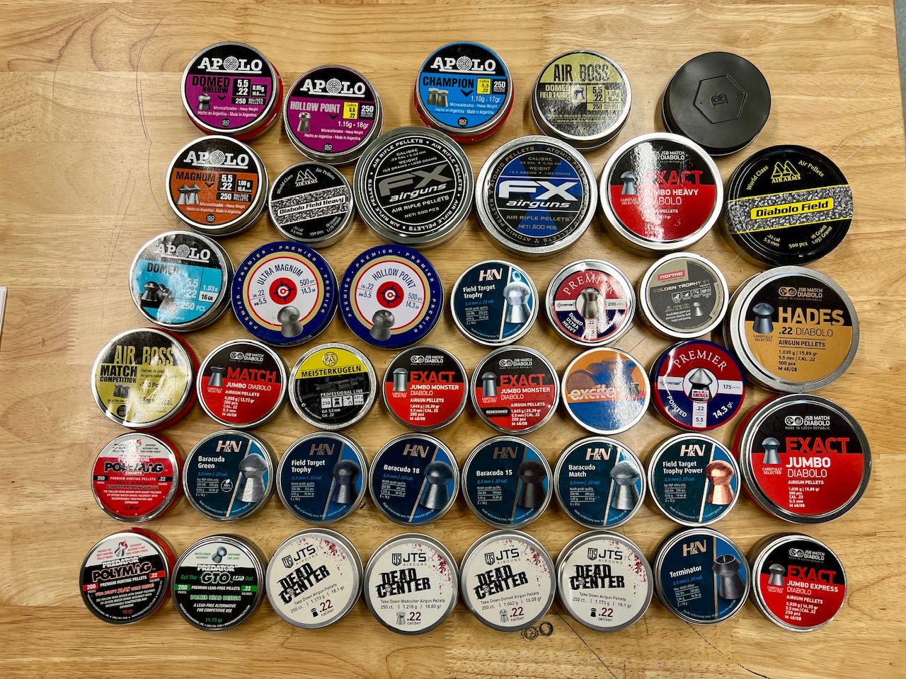

I do not have the selection that "Florida Man" has but I agree with his premise. I think it is important to test different pellets if you want the best accuracy your gun is capable of. I have tried before to make a gun like a particular pellet and it has never worked for me. In my experience you can make a pellet a little more accurate in your gun via a tune but if it isn't pretty accurate with a reasonable tune you start with then it is not going to be your best choice regardless of what you do. My largest experience with this was a cast pellet from a NOE mold. My Avenger and P35-25 both do not like this pellet much regardless of tune. I can cast them with more consistent weights than I find in my tins of JSB pellets and they look good but they just don't shoot. Others report great results in their guns which I can believe. I just wish I could try pellets from a mold before buying the mold.
As an example of why I think it's not a bad idea to keep testing is my P35-177. I shot a variety of JSB, Crosman, and H&N pellets in it. Probably some others I'm not remembering at the moment. I settled on H&H Baracuda Match pellets and shot a 194 on the 30 yard challenge with them last year. Then I noticed H&N Baracuda FT pellets and decided to try a tin. My best with the FTs is a 197. Not a huge improvement but an improvement over a pretty good pellet in this gun.
But it hasn't always worked out that way. My P35-22 put three pellets into exactly the same hole at 25 yards during preliminary pellet screening using H&N Baracuda Match pellets. Later it did exactly the same thing with the other head size of these pellets. I've tested others (including all the older weights of JSBs) and none shoot close to as well. I could have just quit with the initial screen and Match pellet selection. I've shot a 200 with this gun and pellet (using unsorted unwashed unlubed pellets straight from the tin through a Carm magazine), my only 200. I am not actively looking for a better pellet for this gun but if I try a new one in my Caiman X (also a 22) I usually test it in the P35-22 too.
I've head size and weight sorted pellets for the P35s I've mentioned above and recently did it for the Caiman X (best pellet so far is the H&N Baracuda 18). I think I found a weight, an uncommon weight, that the Caiman doesn't like as much but that is the only case where testing indicates the sorting may be worthwhile. I'm only shooting at 30 or occasionally 35 yards so I might have a different answer if I shot longer range. I still think sorting pellets occasionally can make sense if a pellet from a new tin doesn't perform like the previous tin. I found that on Crosman 10.5s. I had one tin shoot about at the same level as the H&N Match so I bought two more and they were much worse. I ordered a head size gauge and checked the new tins versus a few dozen I still had of the "old" tin. The old tin had consistent head sizes over a small range of sizes. The Crosman tins has pellets of every head size on my gauge. They were all over the place. I don't think the variety of head sizes was the issue, I think it is just a symptom that they were not well made pellets.
I've said it before and I will say it again here. I think that people who only shoot a particular brand of pellets (typically JSB) fail to get the best accuracy from at least some of their guns. They are the best in 2 of my 6 guns but the other 4 do not shoot them as well as H&Ns, You can make a gun a little more accurate with a tune it likes but you cannot make it like a pellet it doesn't care for. So you have to test at least until you get accuracy consistent with your goals for the gun.
