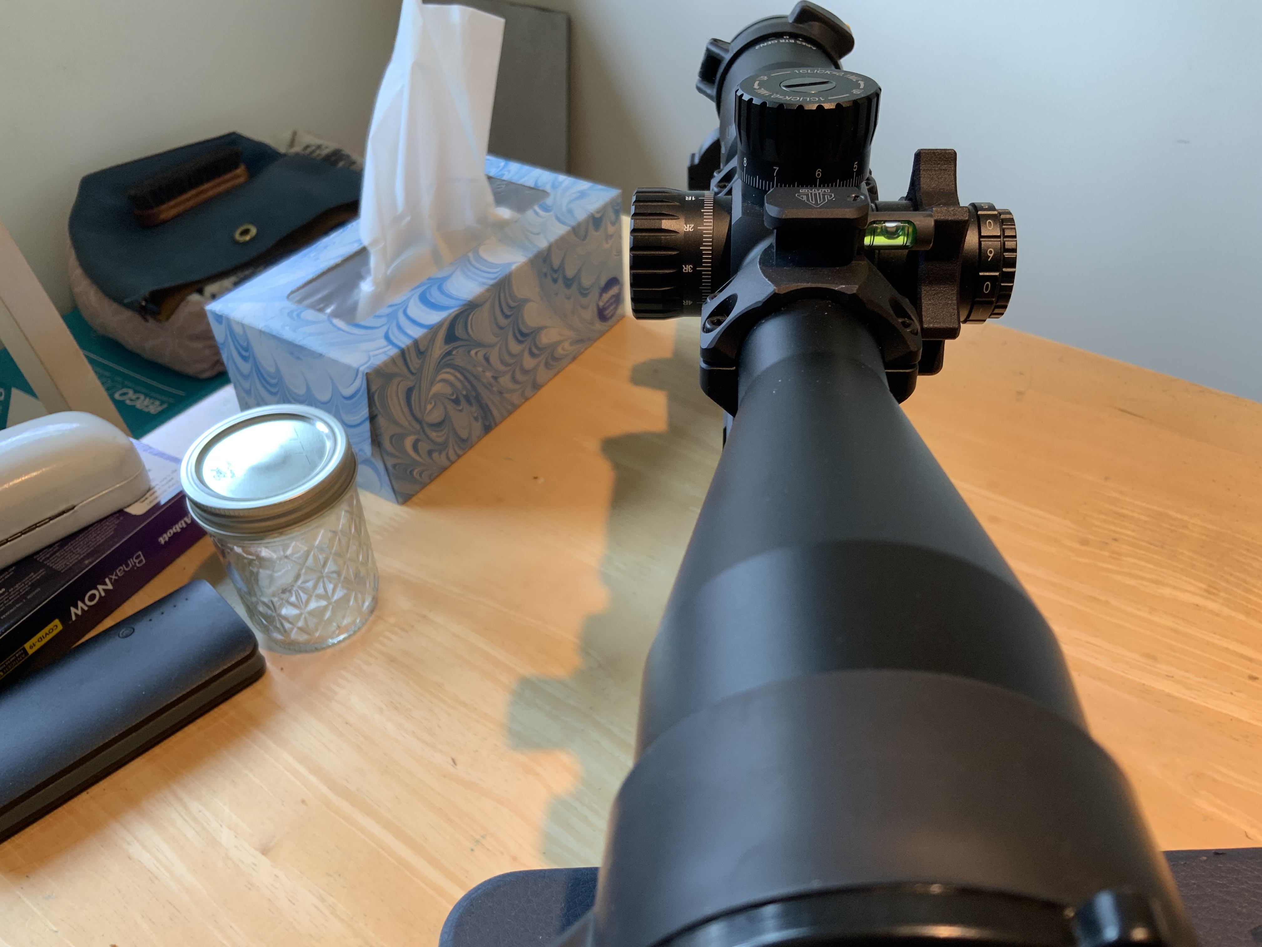

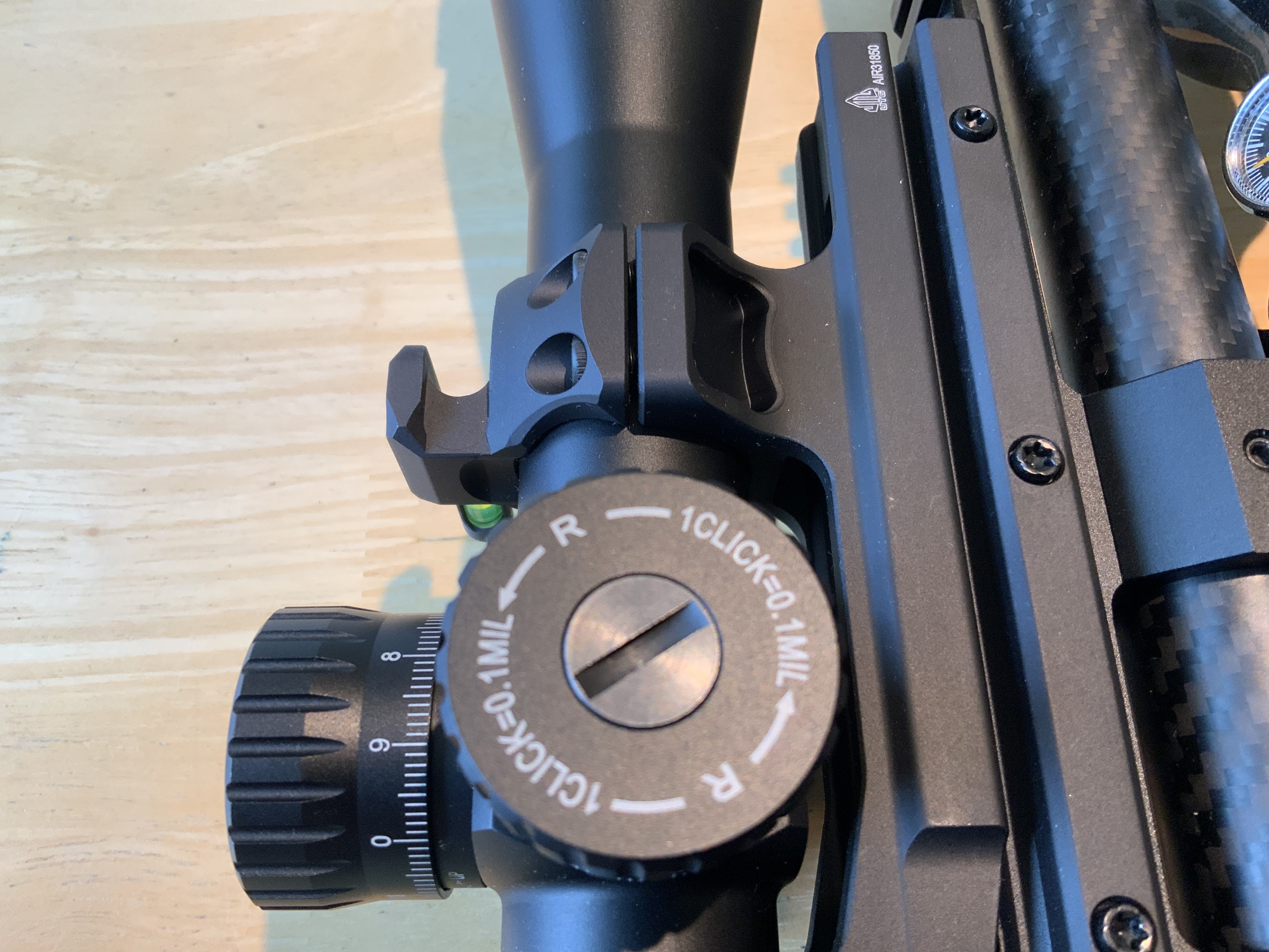

I have a couple rail mounted levels, one is a very nice billet level. These are not even close on any gun I’ve tried them on, so it’s either file to fit, or shim in some fashion. Scope mounted levels are best for me. There is this option, if it’s available for your mounts.
I have a couple rail mounted levels, one is a very nice billet level. These are not even close on any gun I’ve tried them on, so it’s either file to fit, or shim in some fashion. Scope mounted levels are best for me. There is this option, if it’s available for your mounts. View attachment 332528View attachment 332529
those look like the utg accusync,
i have the one piece utg accusync mount coming.
does not look to be adjustable though,
as its position looks fixed but the level can swing out.
i need to be able to rotate it to align to the crosshairs.
There is some adjustment, by way of favoring one side or the other when mounting this strap. There is still some clearance when tightened, so that gap is potential adjustment. Poorly worded, but I think you’ll get what I’m saying.
This one is on the left side of the picatinny rail. They also make one that fits on a picatinny rail whose bubble is centered, you would mount it on the very back of your rail.
unless im seeing it wrong there would be no adjustment available.
i need the ability to align the level to the crosshairs after i align the crosshairs to the bore.
i may be looking for a unicorn lol
