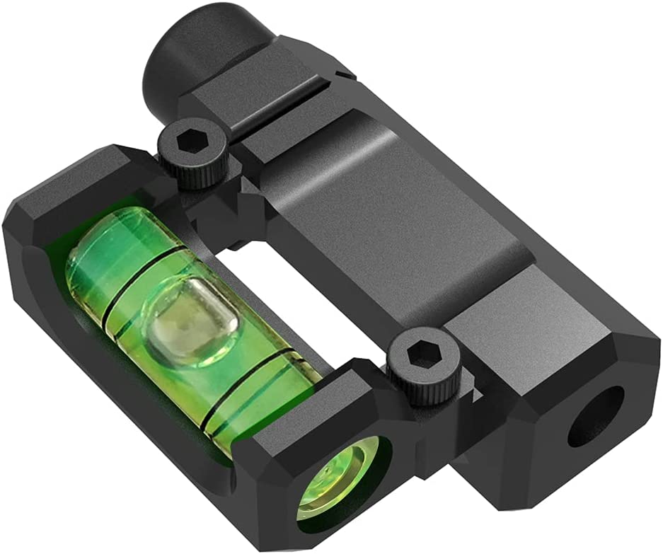

does this exist? an adjustable scope level that does not mount to the tube?
well........after searching and searching and searching.......and searching....
i found one :eek:
picatinny mounted level that is adjustable for cant. SCORE!
only bad thing is its 40 bucks lol

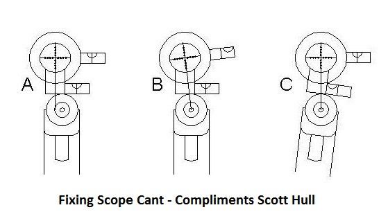

So what ur getting at is with the scope lined up to a plum bob and a rail level mounted to the gun the bubble wasn't lined up am I thinking correctly?
correct.
because the scopes crosshair will be aligned to bisect the bore of the gun,
then inevitably the gun will need to be tilted ever so slightly left or right to bring the crosshairs back to level,
which in turn throws off the rail level.

Levels are for ensuring that you haven't canted/leaned the rifle to either side. If you do, the further out you are shooting the further off the POI and POA will be.

I think the point is you don't have to have a level mounted to your scope full time. Use a level to square it up when you first attach your scope and you are more than good to go IMHBAO.
Actually, the opposite is more generally true. There is no need (read: no use) for a level to mount a scope. Where a level comes into play is to help the shooter know he's holding the scope level before pulling the trigger.
