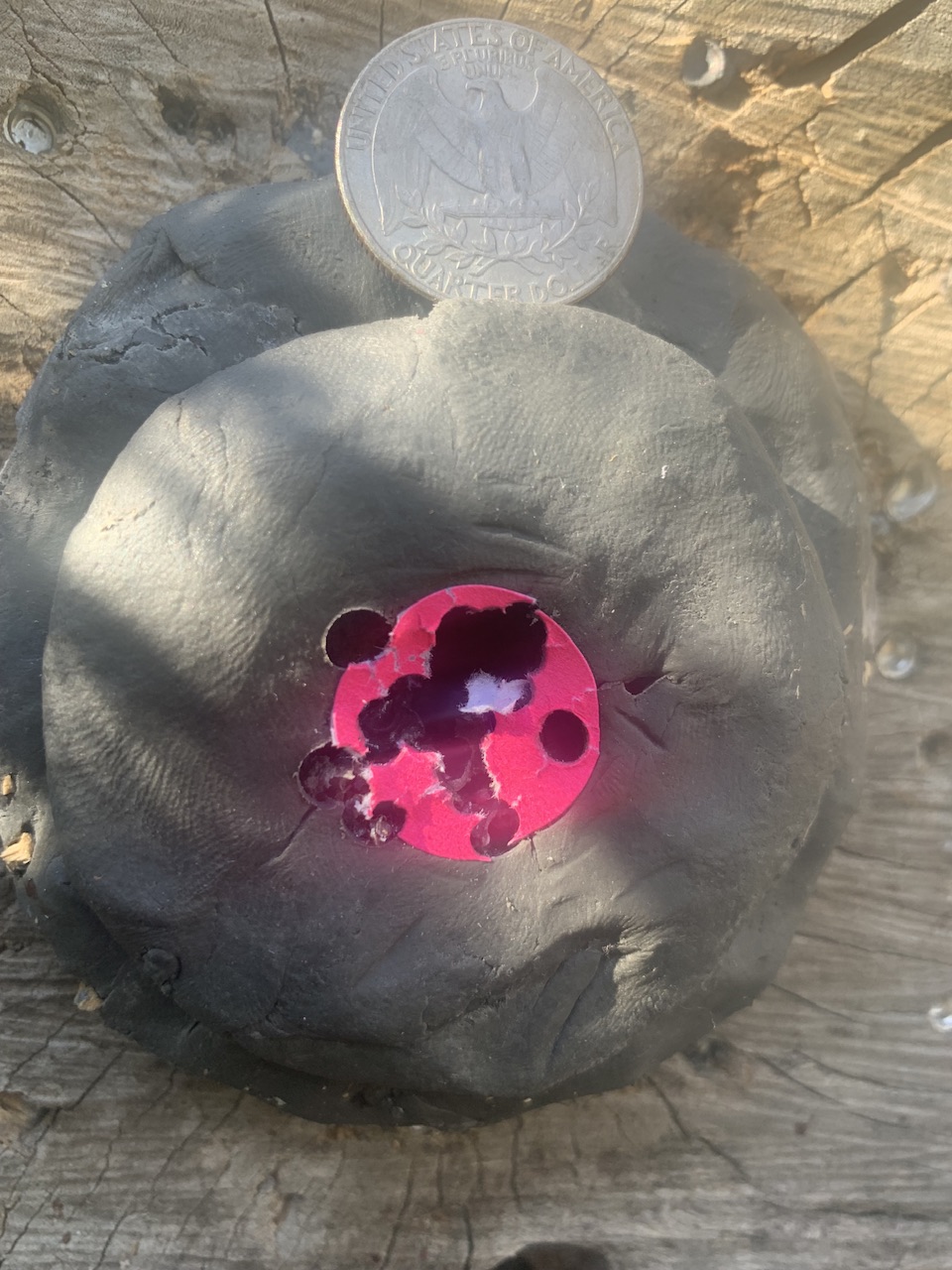

I decided it was time to retune my Panthera 600mm 177 for use in my yard during the winter. It has been tuned to shoot (on the knee) 20grain Zan slugs at 980fps and has been magical, but that’s too much juice for my yard. Before a proper retune, I decided to see what it could do running a jacked up/wonky tune. So I left the reg at 150bar and just dropped the power wheel setting until it was shooting 13grain Zans at 980fps. The ES was just as good as it was on the knee, so I proceeded with a 10 shot group at 58y. I hadn’t shot it for a few weeks and was really enjoying it so I extended the group to 20 shots. Here it is:
I think it’s pretty solid for a wonky tune and moreover, it’s really quiet and efficient. I fully expect it to suffer from a bit of speed loss resulting from creep but I’ll just find the necessary power wheel adjustments to compensate for the first couple shots. Anyway, while I agree that it’s optimal to be on the knee, it’s certainly possible to use the power wheel to adjust to different projectiles with no appreciable loss of accuracy. It’s just a matter of having a good regulator (or two). I’ll stick with my jacked up tune for now and I don’t think the rats will be any better off.
That's impressive.
