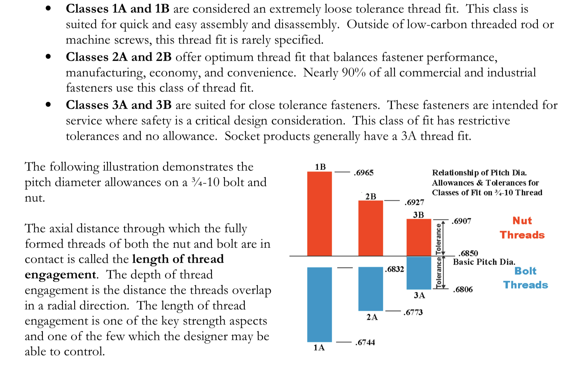

While true the industry standards are as listed for SAE sizes. The op was asking specifically about thread pitches in relation to air rifles vs firearms. My post was to address his specific query and not be pedantic...
Of my many many class 3 devices I have absolutely none that use any thread pitch other than industry standard...ie 1/2 x 28 class 3, 5/8 x 24 class 3 etc... in SAE. There are a couple others but the pitch escapes me, like the 3/4 dia version.
How many do you own and details that are for firearms and in a different pitch? Not including metric like 18 x 1 LH?

My reply was neither snarky nor intended to inhibit the sport. My reply pointed out that thread class is a descriptor of thread fit. Which may or may not apply to firearms. The descriptor "Class" can apply to threads throughout industry. My point is that your use of Class, as pertaining to firearms is not adequate and inaccurate by itself. I further suggest that without very expensive thread gages, you could not identify thread class in any case.

Class 3 refers to a category of firearm. In this case, suppressors. Most have threads that attach to barrels and those threads have sizes. IE 1/2 x 20, 5/16 x 18 etc.
It can Jeff, if he referenced the NFA of 1934, but he did not. He referenced threads, not firearm classes as defined by the NFA. Hence, my appropriate comment.

Actually Steve is correct. The threads used for suppressors are called class 3 threads and have a different design and way the pitch is cut than machine threads or acme threads. This is critical in firearms suppressors to maintain concentricity to the bore axis and avoid baffle strikes or endcap strikes which can be, but not necessairily, considerably more catastrophic than airgun strikes.
The best info I can share is in this link.

Pedantic at best. Thread pitch gauges are neither difficult to come by nor expensive for quality accuracy.
Class 3 is in fact a spec and an industry accepted as an descriptor. Especially when replying to an OP to try and make a useful and direct correlation to the OP's question. There was no need to address an elephant that was not in the room by flexing an apparent knowledge that would do nothing but confuse the OP. In a 2 dimensional interface for commo it usually is best to keep it sime for dumb a$$es like me, simple crayon eating Marines than to dazzle the community at large by flexing what you think you know...
See above like to TBAC for clarification thats what I use to cut threads to spec...

I am trying to be nice, A thread pitch gage will not identify a thread class. There are special expensive inspection gauges that are used for that purpose. Secondly, mounting threads never assure proper alignment of anything. Precise alignment is always achieved with a register of some sort machined into the mating parts. In most cases clipping is caused because there is no register to the barrel especially when the moderator is attached to the shroud in the case of many air guns. Let's also be clear, this class discussion was caused because you used the words "class 3 threads". What you wrote, I suspect, is not what you meant.

Somehow we are on exactly the same page but different frequencies. I have been cutting threads of all classes and most other types of machining operations for 40+ years and am intimately aware of the differences. My replies were possibly to concrete in logic. I saw no reason to go into that depth of discussion when the question was for the poster that asked directly about pitches. It referenced only pitch so clearly he was concerned with pitch vs. class of thread In relation to difference between FA vs AG devices. I used the phrase Class III as a catch all as it is commonly used in the world of FA, poorly articulated and agreeably a bit lazy I will give you that. The poster I replied to was not concerned (at least in his query) with strikes, only the different sizes commonly used between the two sporting endevors.
