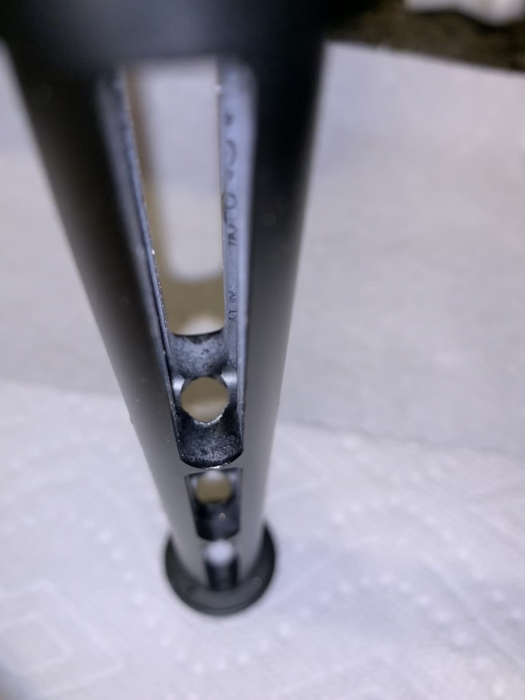

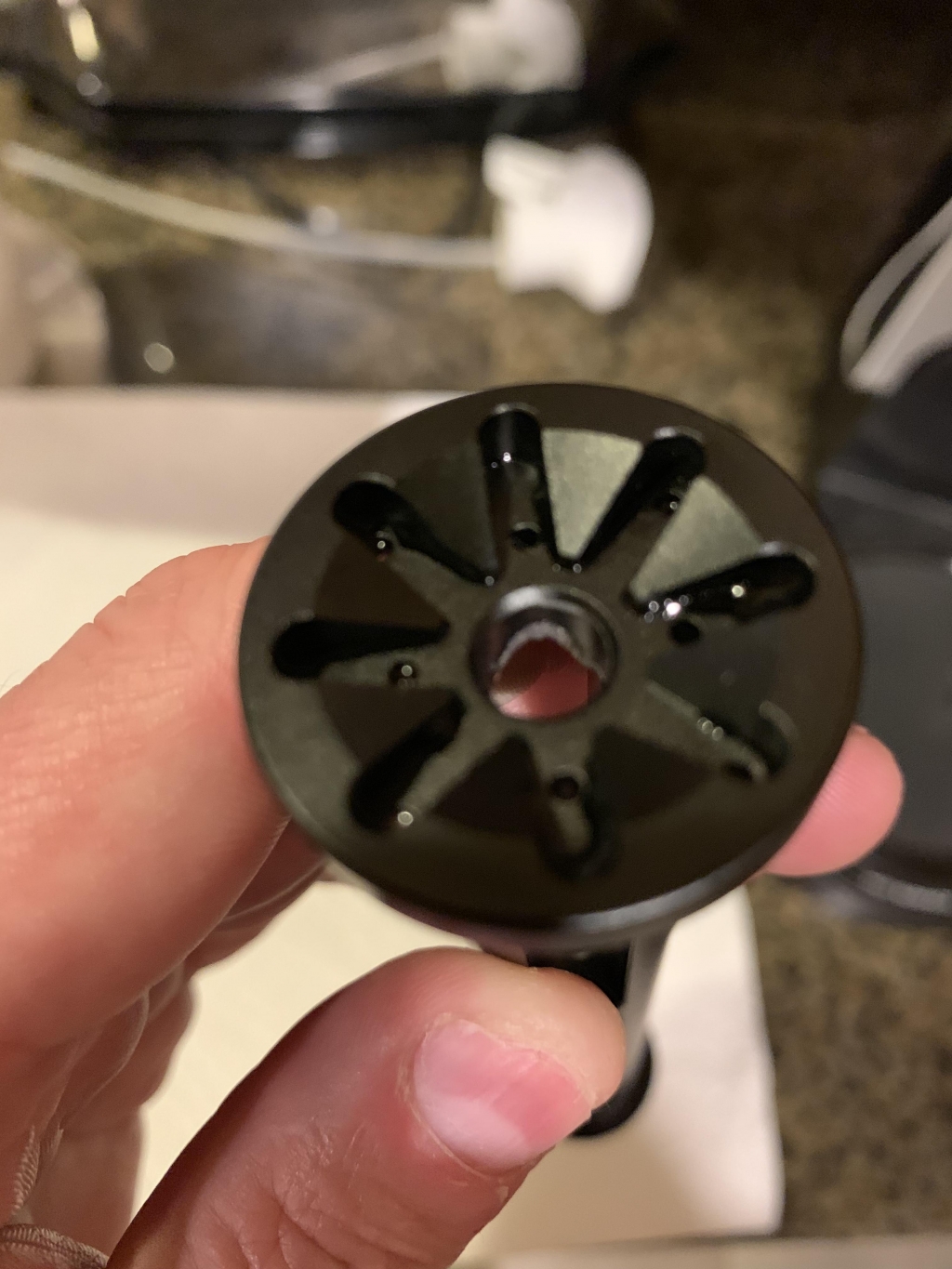

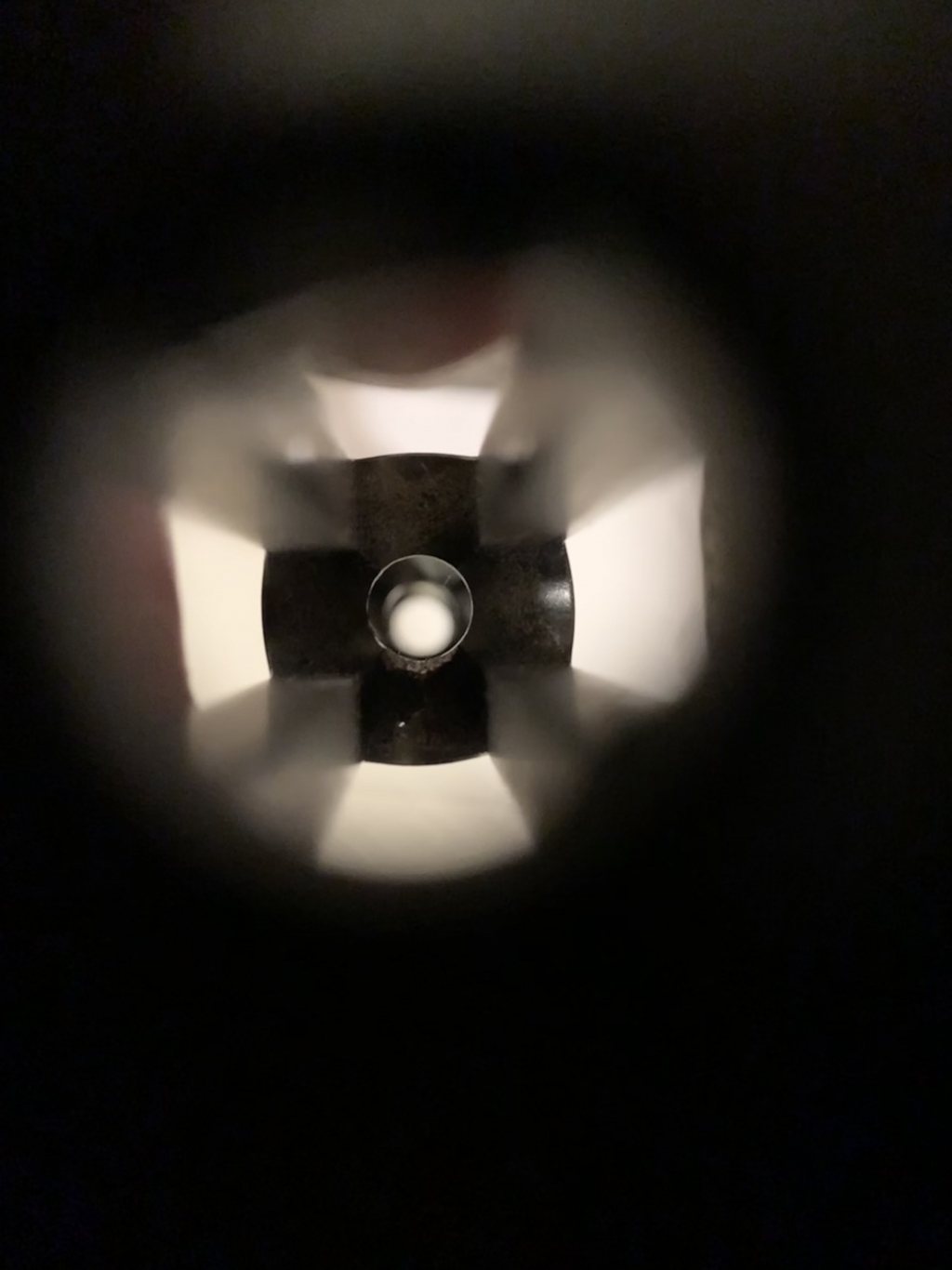

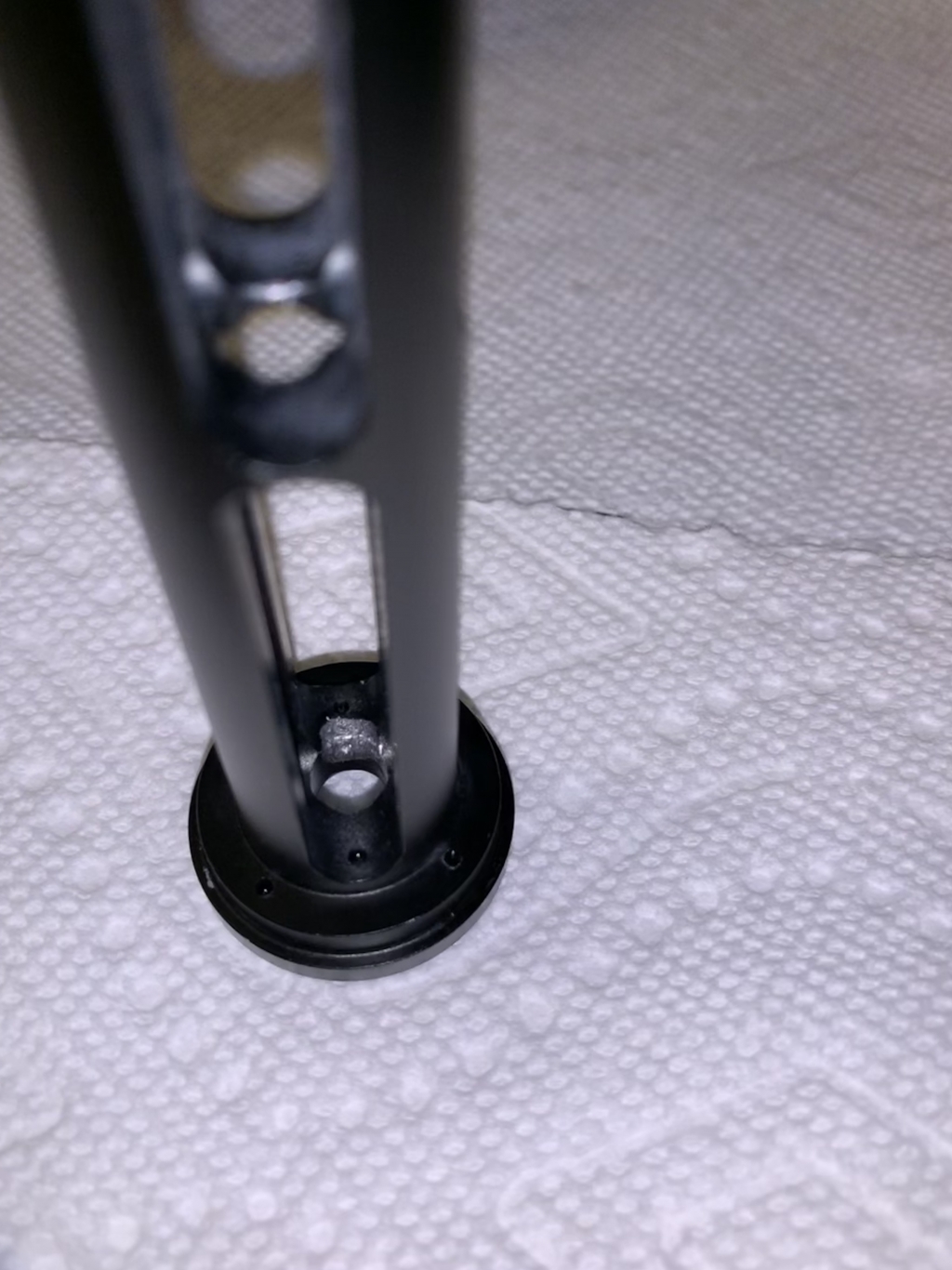

At least you caught the issue before any damage was done. Me on the other hand, actually Destroyed a DFL Fatboy and Muzzlebrake, plus really damaged my Koi (which I was able to salvage, but got another 1 anyway). Come to find out, my pellets were clipping the inner lip of the shroud on my FX Crown upon exiting. Took me a hot minute to find that problem and correct it.
