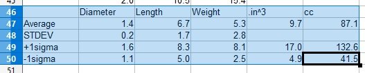

I just did a quick spread sheet using your data. I only used moderators for which you had all three columns filled in (diameter, length and weight). I counted 45 units. With 45 units in the sample set this data is unlikely to ever change much. Except where otherwise noted units are inches and ounces.
These are the average dimensions with one +/- one sigma:
Reactions: JungleShooter
