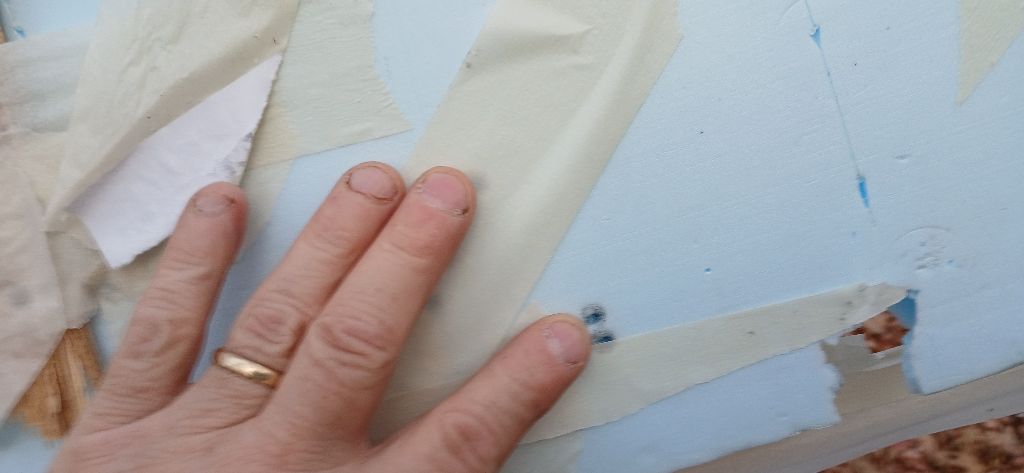

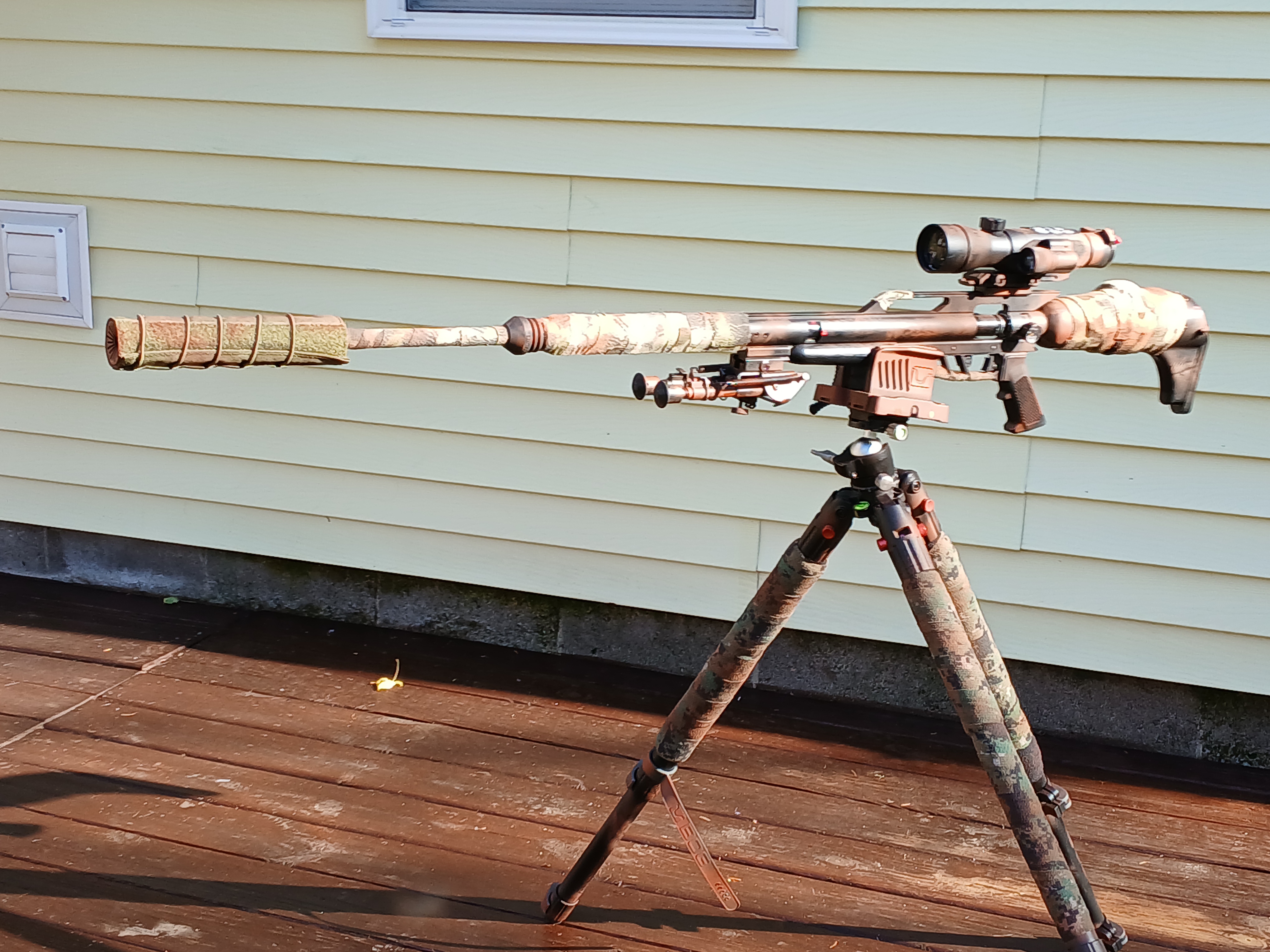

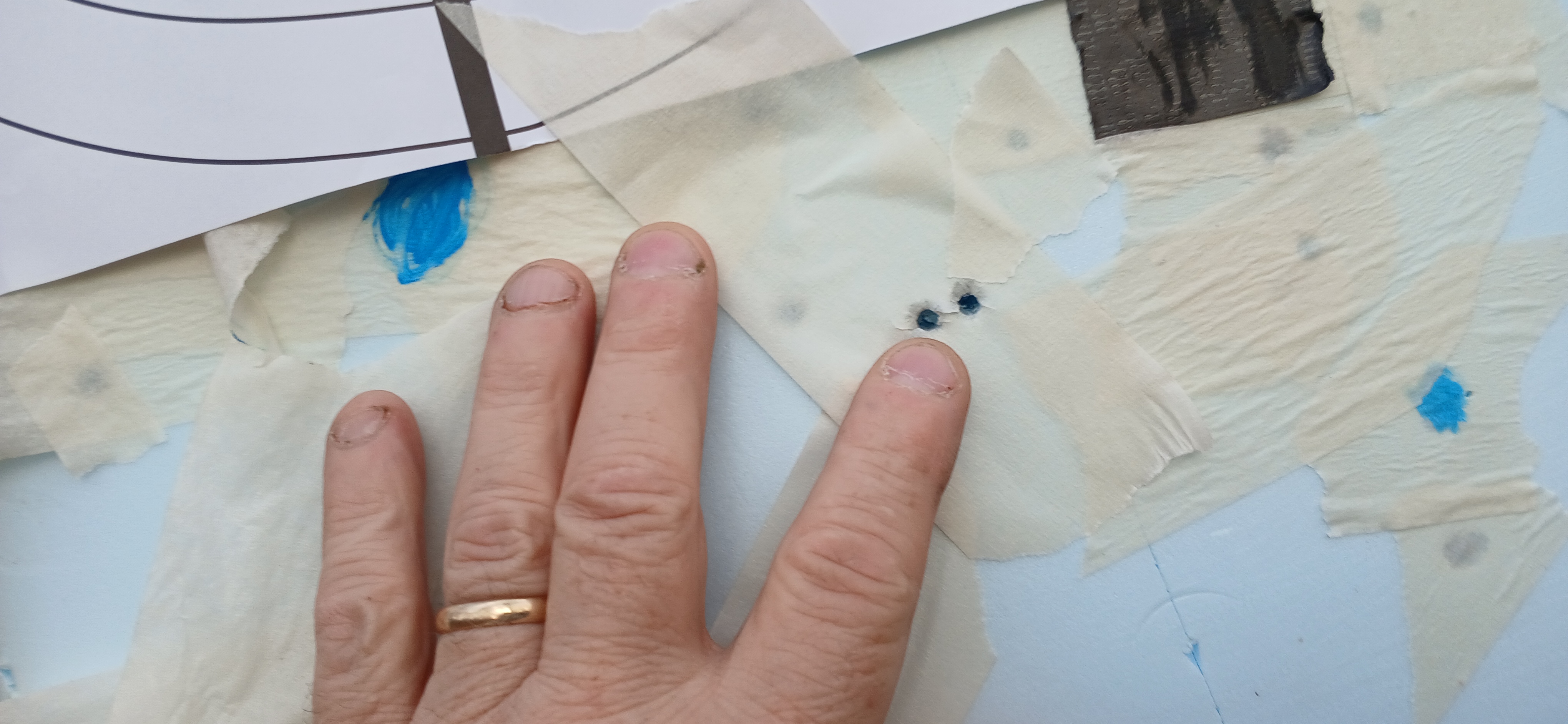

I've equipped my Yokozuna with the Quick Disconnect, and it's mounted on my .308 Texan without any problems at all. 2 shots with 150gr slugs at 100 yards. the tape over the shot was just to market, and then to more from 100 yards.
