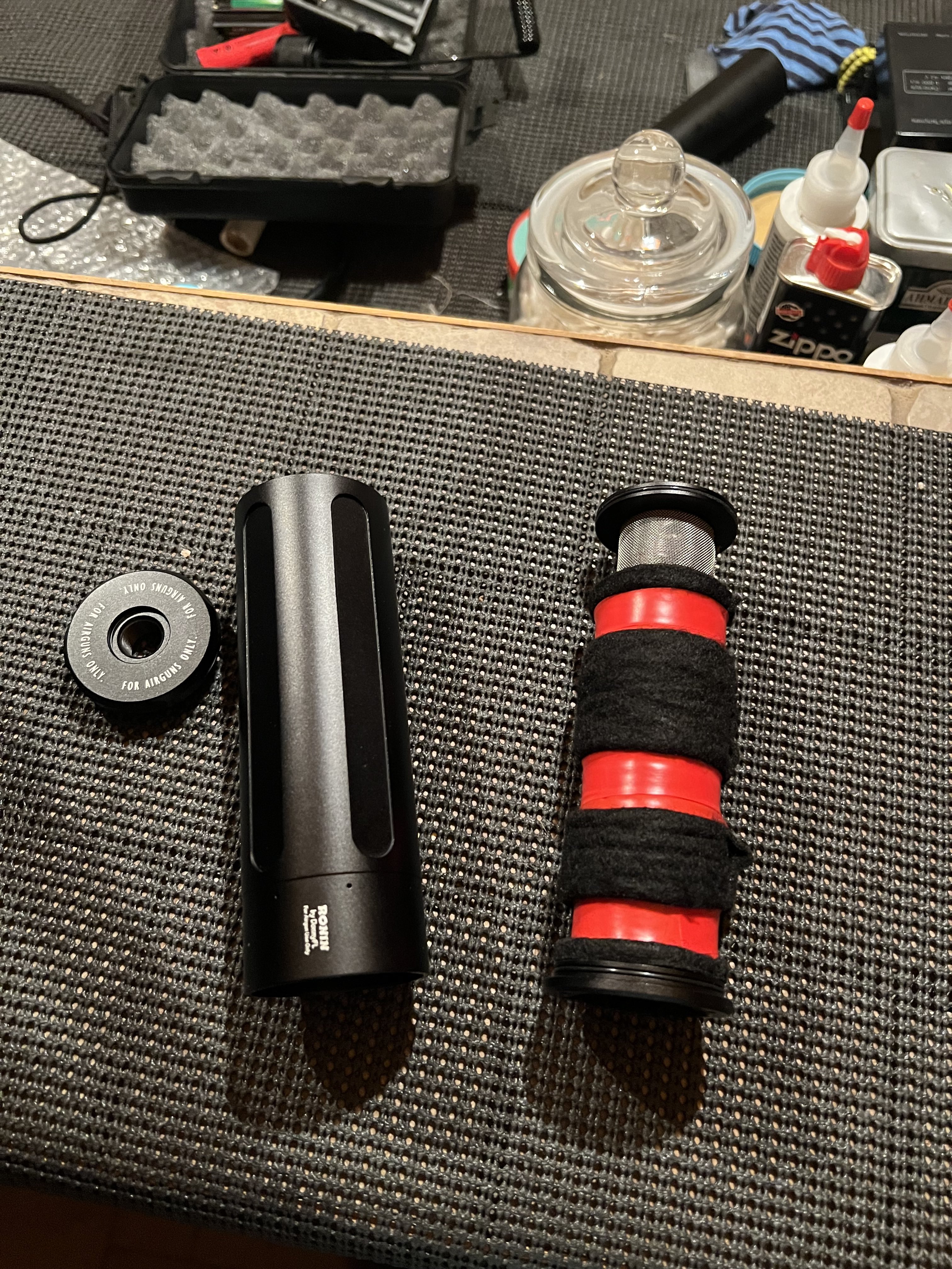

I am using DonnyFL RONIN moderator (as suggested) for AEA Challenger .30 32" barrel. The felt inside the moderator is getting pressed to one side after every shot. So basically Supression is working only for one shot.
What am I doing wrong?

Hi Petrenko_usa. The stuff you are calling "felt" does not look anything like felt to me. I have a donnyfl ronin on my fx maverick 30 cal sniper putting out about 110fpe and I have had my ronin apart. I didn't take it apart for any other reason than to see if it was dirty. So my ronin has the fine mesh screen like on yours, but then it has a sheet of dense felt wrapped around the screen. I did not put the tape back on when I reassembled it just to see if it made any difference. Without the tape I could not notice any difference -- it works really well for my 30 cal.
If that ronin of yours is brand new from donnyfl, then I think you should email donny with this picture attached and ask for the real felt that is supposed to be in the moderator. If your ronin is not new from donnyfl, then I think you should order replacement felt from donny and use real felt.
Honestly, the stuff in your moderator looks like knitting yarn.

Hi again Petrenko_usa. I just checked donny's site and it is down. However, I did see that my local walmart has 9"x12" felt sheets in stock in the store. They are really cheap -- less than a dollar per sheet I think. I don't know if it is as good as the stuff donny sells, but I wouldn't be surprised if it's the exact same stuff -- it's just polyester fiber that has been crushed into a sheet. You'd be saving a lot of money and time. You can check other places you might have locally like Michael's (craft store) or Joanne's Fabrics.
Cut the 9x12 inch sheet down from 9" to the length of the core. Wrap the screen around the core first, then wrap felt around the screen until you have enough on there to fill the space between the core and the inside of the cylinder shell about 85% of the way. Cut off the excess. It will try to unwind while you are wrapping the stuff around the core and once you have the outer shell on, the screen and felt will unwind all the way and stay in contact with the inside of the outer shell -- unless you use tape. I chose not to use tape and it seems to be just as quiet as it was with the tape.

That shelf liner that you have the Ronin resting on in the photo works as a better replacement to DonnyFL felt. Cut an exact size piece to fully cover the mesh and make it long enough to do 2 -3 wraps. The tape is just to hold it in place for reassembly. Twist the core in the tube continuously as you put it back together, you don't want the material to bunch up. It only ends up being a decibel or two better, but better is better, ...and you already have it!
Hi PumaCarl. I'm sure my wife has the same shelf liner around here. If it works better, then I want to do that -- better is better like you said. So when you say 2-3 wraps, is that leaving some "empty" space, or would you suggest filling the entire space (non-compressed of course)? And I'm interpreting what you said about the tape to mean to not leave the tape in -- is that right?

Use the tape to hold it. You will need it. You should put enough material around the core that it goes in tightly and you will have to spin it so that it doesn't catch and scrunch up (like the one in the photo did). Hold the core with your thumb and index finger wrapped right around where it enters the tube, to help compress the material and twist and push in an 1/8" at a time. It shouldn't happen easily or all at once, that's too loose.You are going to have to experiment with the right number of wraps a few times probably. You will understand what I'm saying after you have done it a few times. Good luck!
p.s. To answer your question about compressed or uncompressed, compressed but doable. If you get a chance, watch Earnest Rowe's video on what he does. He used one inch open cell foam in one of them and that looked like a major pain. We are dealing with a big puff of very high pressure air here, loose or easy won't cut it.

Thanks PumaCarl. Now I know what you mean. That shelf material is kind of grabby. It tries to grab onto itself while wrapping and tries to grab the shell while assembling the parts. I'll get it right with a couple of attempts. I'll check out Ernest's video too.
