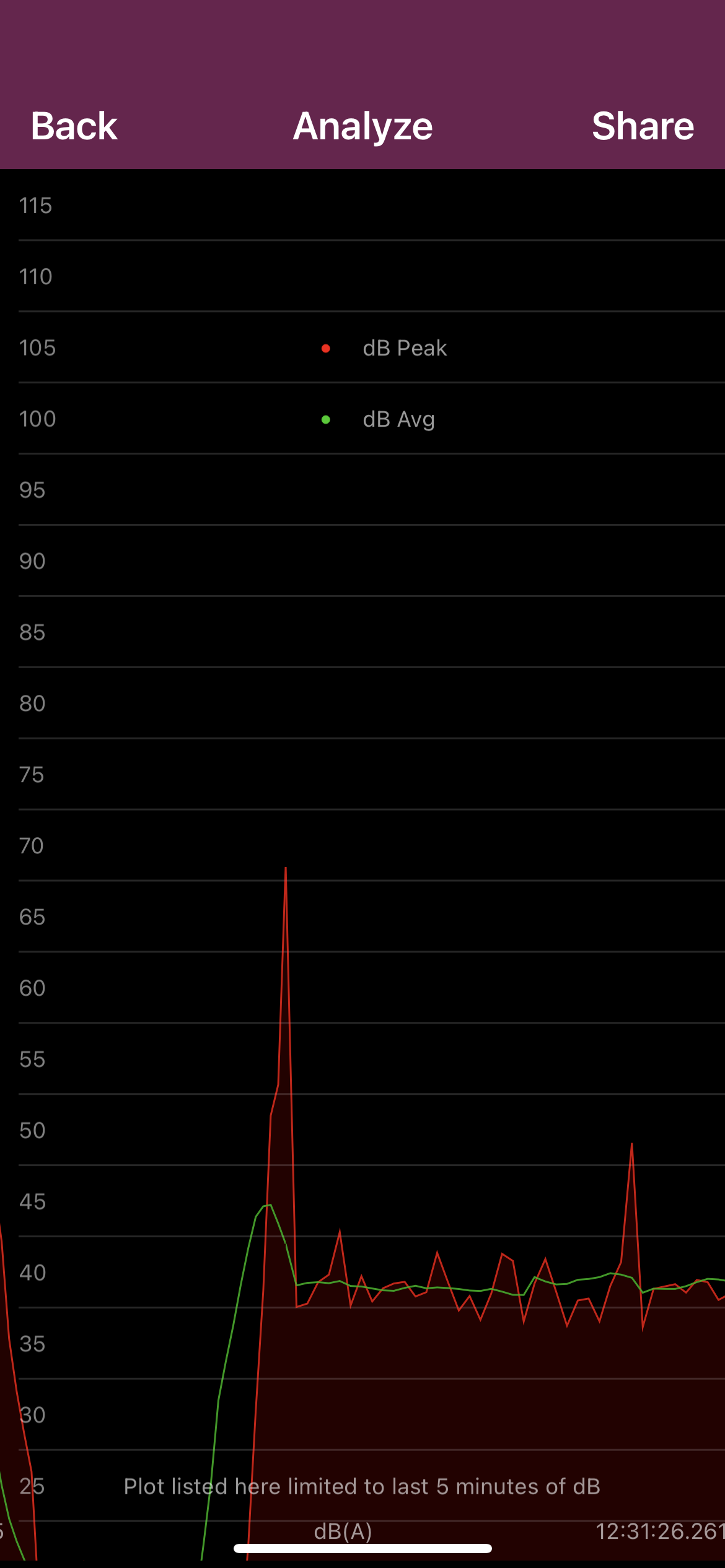

To my ears, the Huma was more mellow and the DFL had a hard to describe metallic sound. The Decibel Meter dB app shows graphs with a double spike for the DFL Yokosuna. This same pattern existed in both the .22 and .30.
Here’s the .22 screen grabs..for DFL Yokosuna
Here’s the .22 screen grabs..for Huma40
Here are the .30 grabs..for DFL Yokosuna
And the .30 grabs..for Huma40

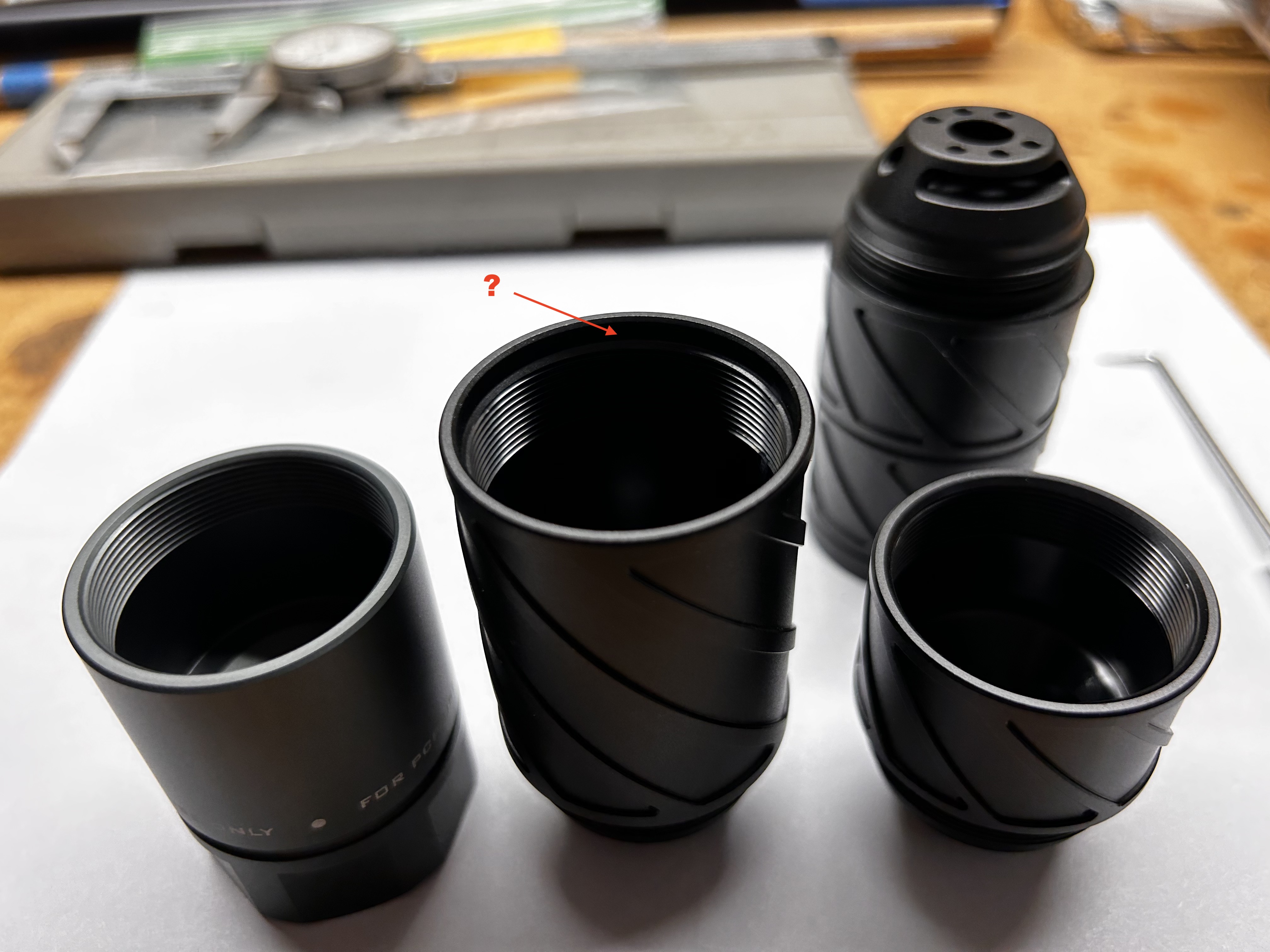

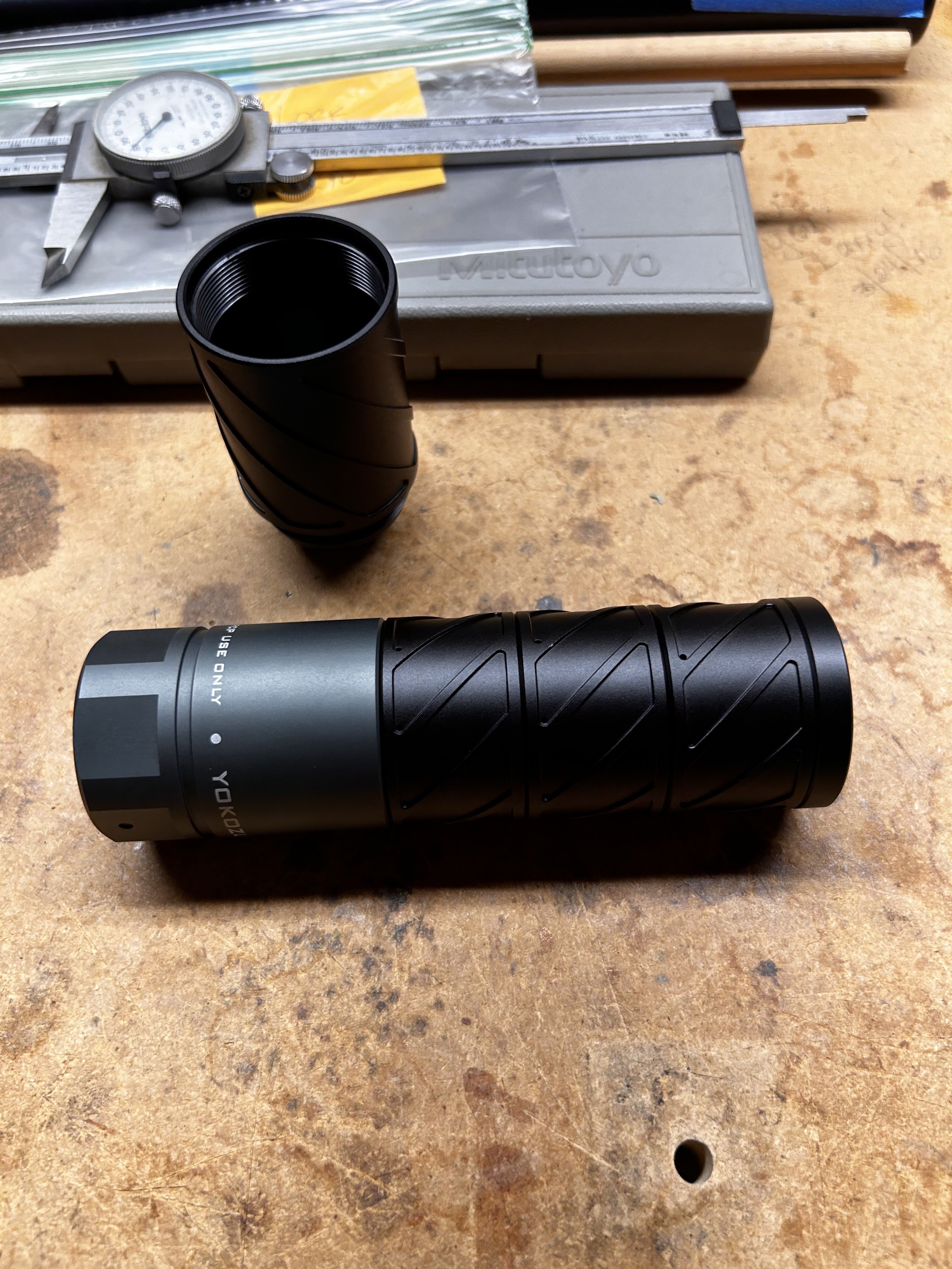

I was curious about the metallic DFL sound, so I unscrewed all the sections to do a quick exam. I could tell there was a difference in the way the moderator re-assembled. The “normal” feel when screwing the sections together was a bit of o-ring drag on the threads just as the section started to snug down. When screwing a small section into the larger, empty, “blast section”, there was no drag feeling..just metal to metal contact when snugged down. Hmmm. Wonder if this is the source of the double spike?
Notice the difference in the larger DFL section??..see the red arrow..
I’m pretty sure the area without the threads doesn’t allow the o-ring to contact anything when a small section is screwed into the blast section. Maybe this creates a micro-reverb chamber..IDK Not sure if this is supposed to be normal. Does anyone else have a Yokozuna or Ryu they could disassemble to check? I’d be curious to see if there’s a difference between what I have and what others have.
Just for grins, I took the blast section out and made another shot..just to test my theory..
Screen grab for DFL..without “blast section”
Double spike is still there but spike number two is greatly reduced and, to my ears, sounds a lot more like the Huma. If you believe the app, actually a little quieter, too.
