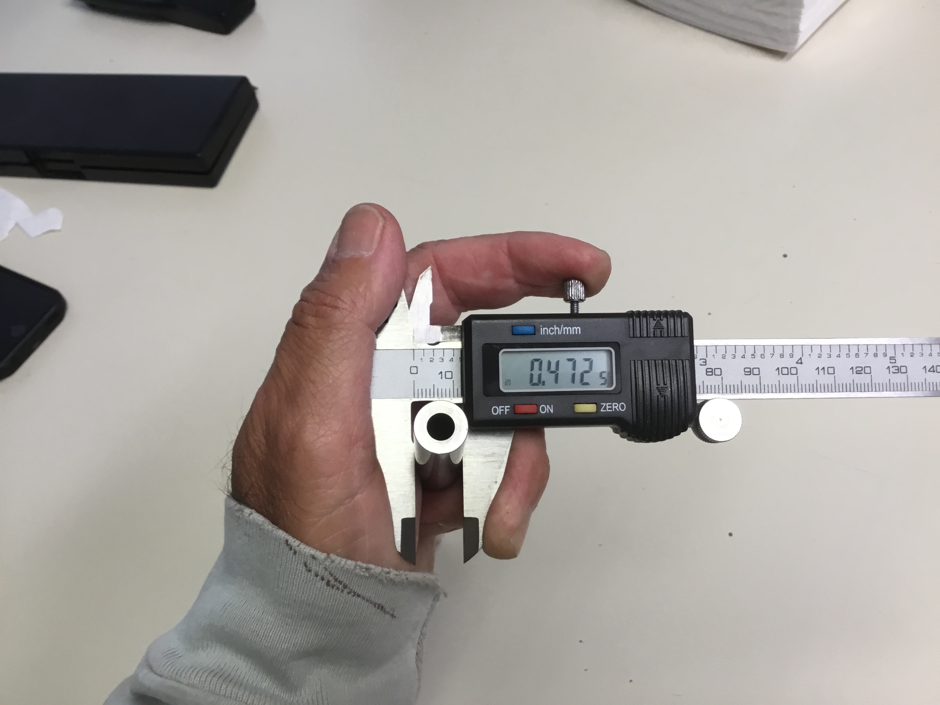

Finally getting some raw materials in. Looks like 15mm will be a go. Wanting to gauge the interest in a 15mm. @Dairyboy you had mentioned you were interested what other guns use 15mm? I think RAW is 15mm as well. I do currently have an 18" and 24" blank available in 1/2" OD if anyone is interested. 14mm is in the works getting raw material has been a pain. FYI when hammerforging the raw material needs to be a specific ratio of OD and ID of the raw material to get a specific final OD. If it's not within that ratio the OD is off and requires the blanks to need ground between centers to reach the desired OD which adds significant cost. I'm trying to avoid that so the barrel cost can stay reasonable but the down side is the wait for matching ratio material means the no barrels during that wait so it's a tough decision.
Are there any other cuts or grooves or screw divots needed

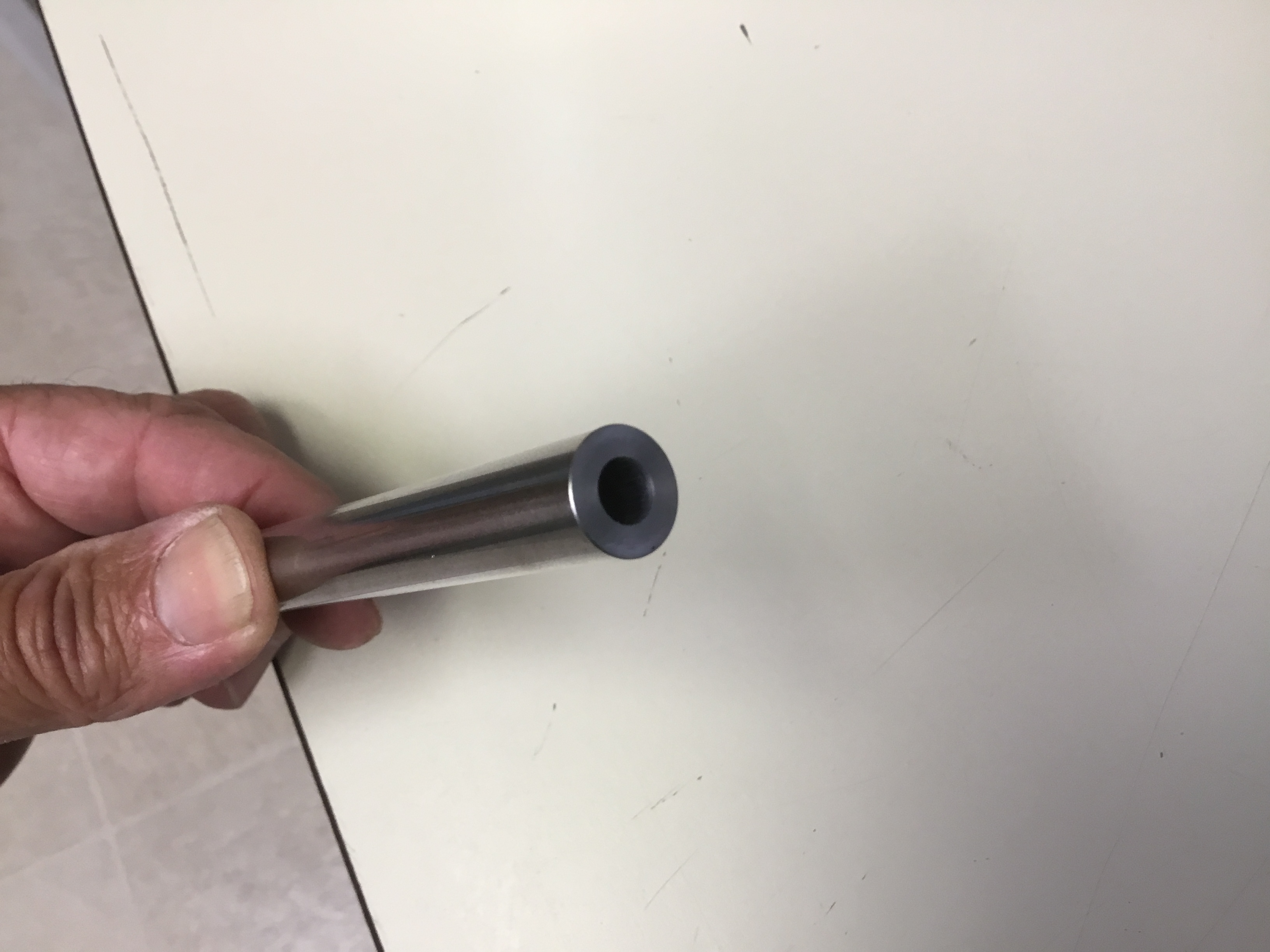

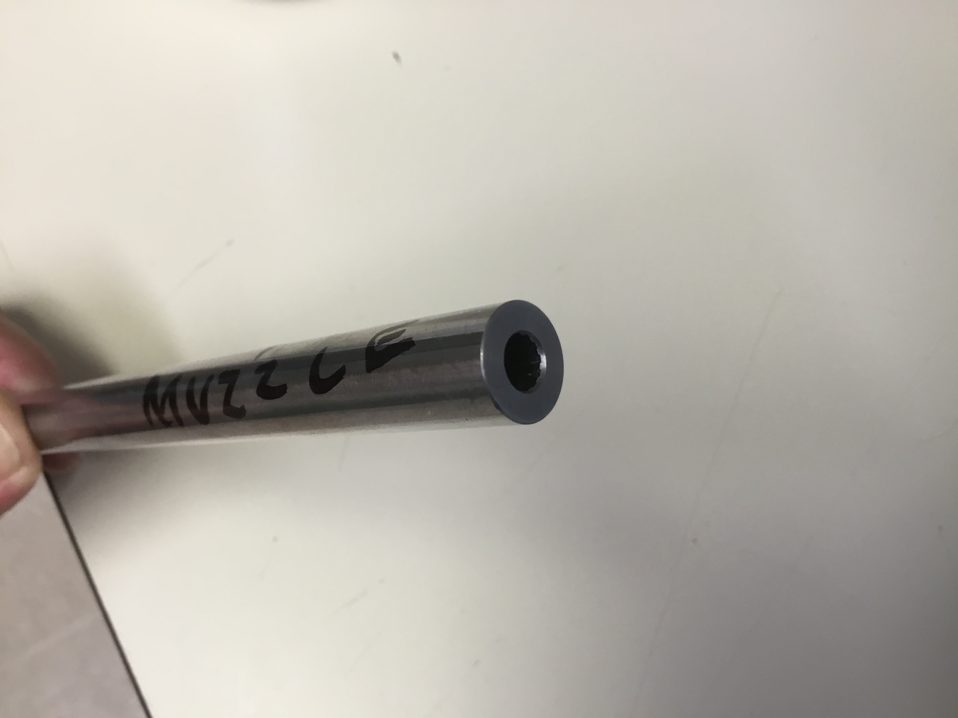

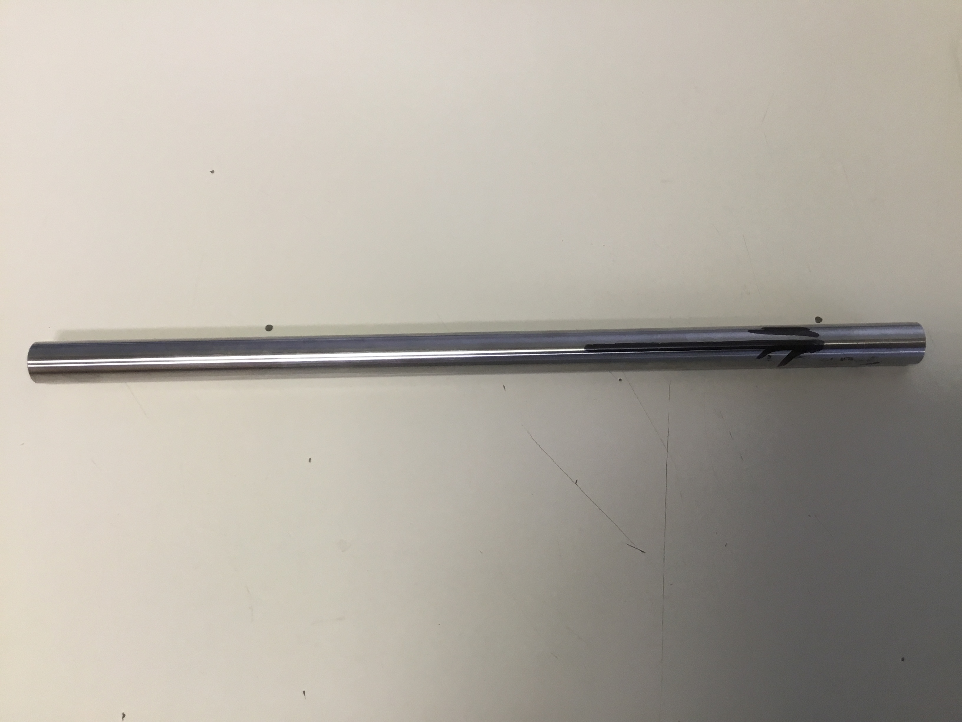

Here’s my 250mm barrel:
Nothing needed for the O.D.
Real nice crown on the muzzle end
And the breech end has a nice bevel for the pellet entrance
