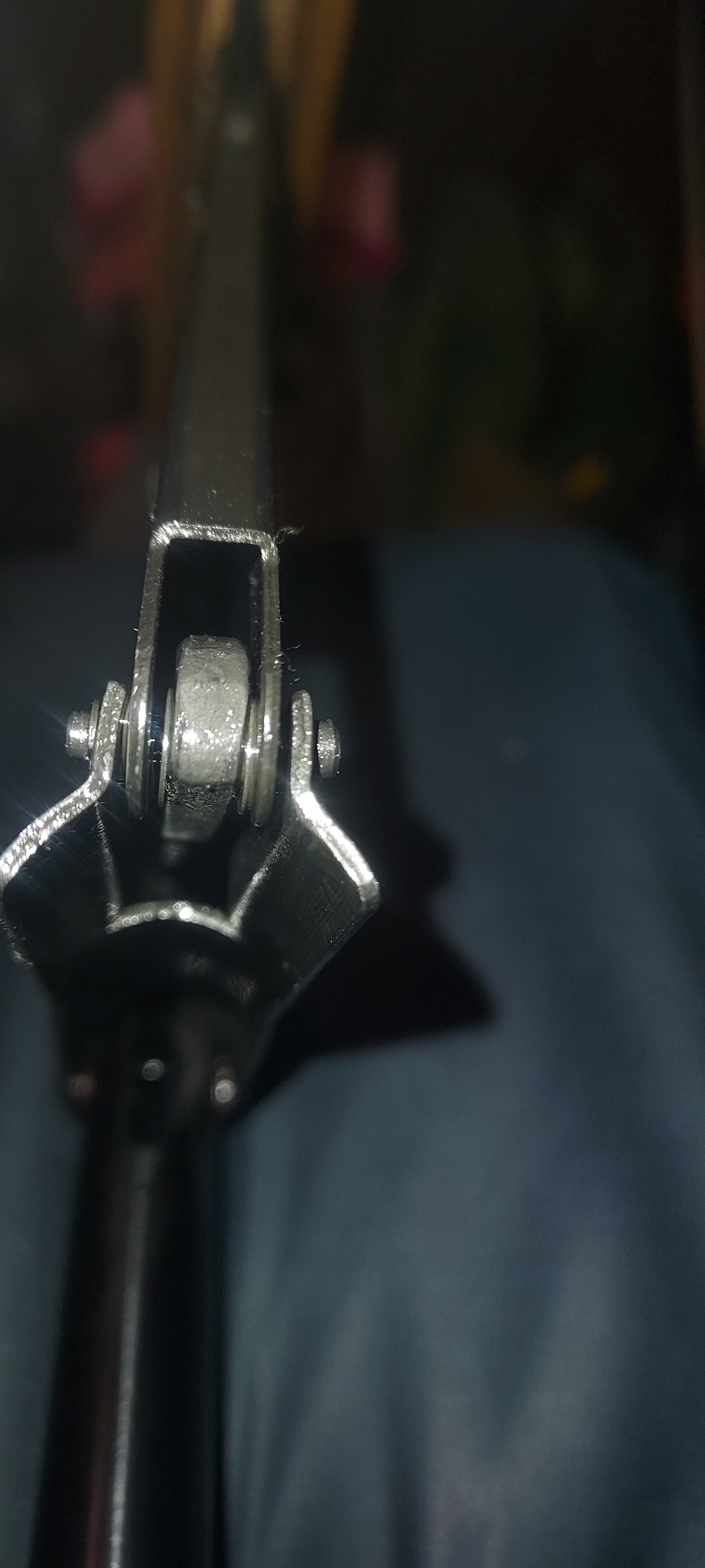

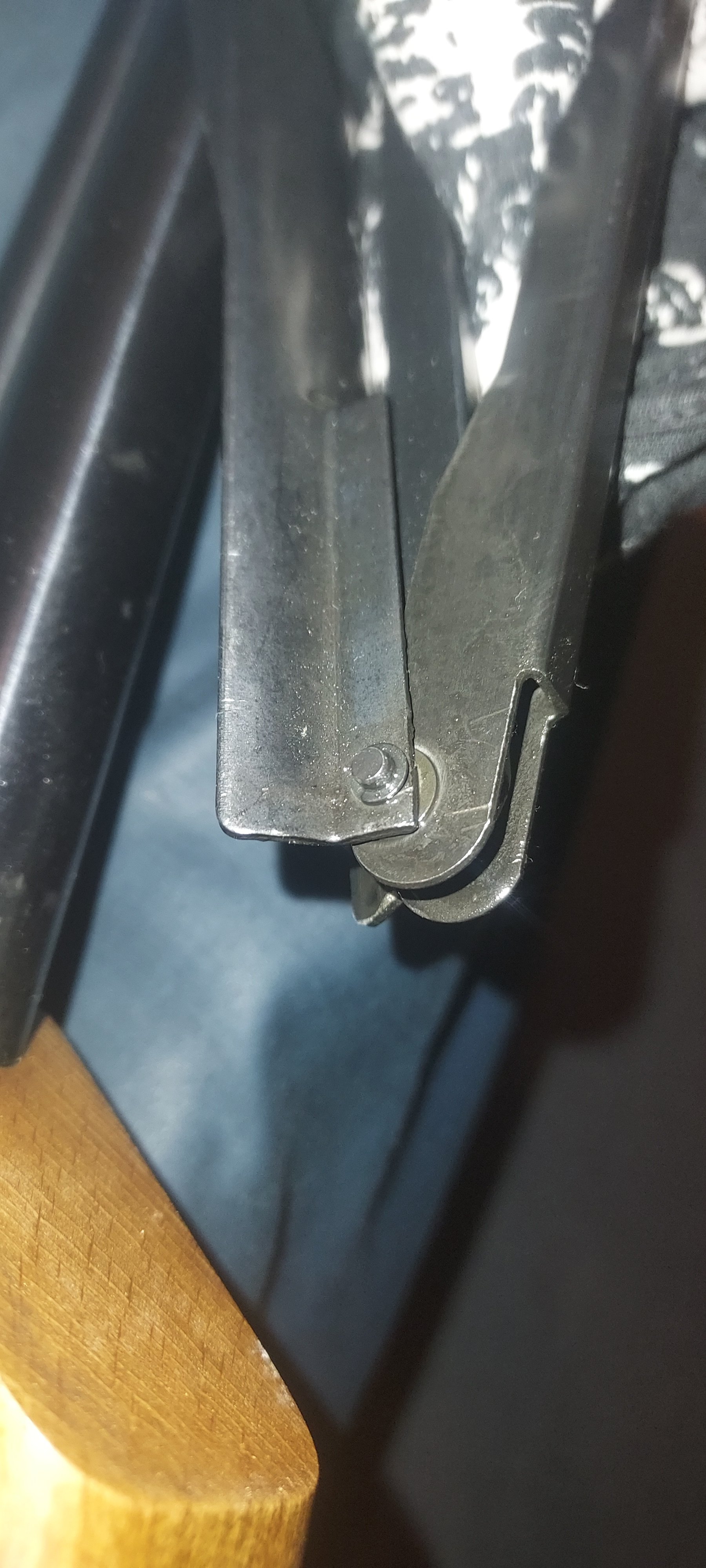

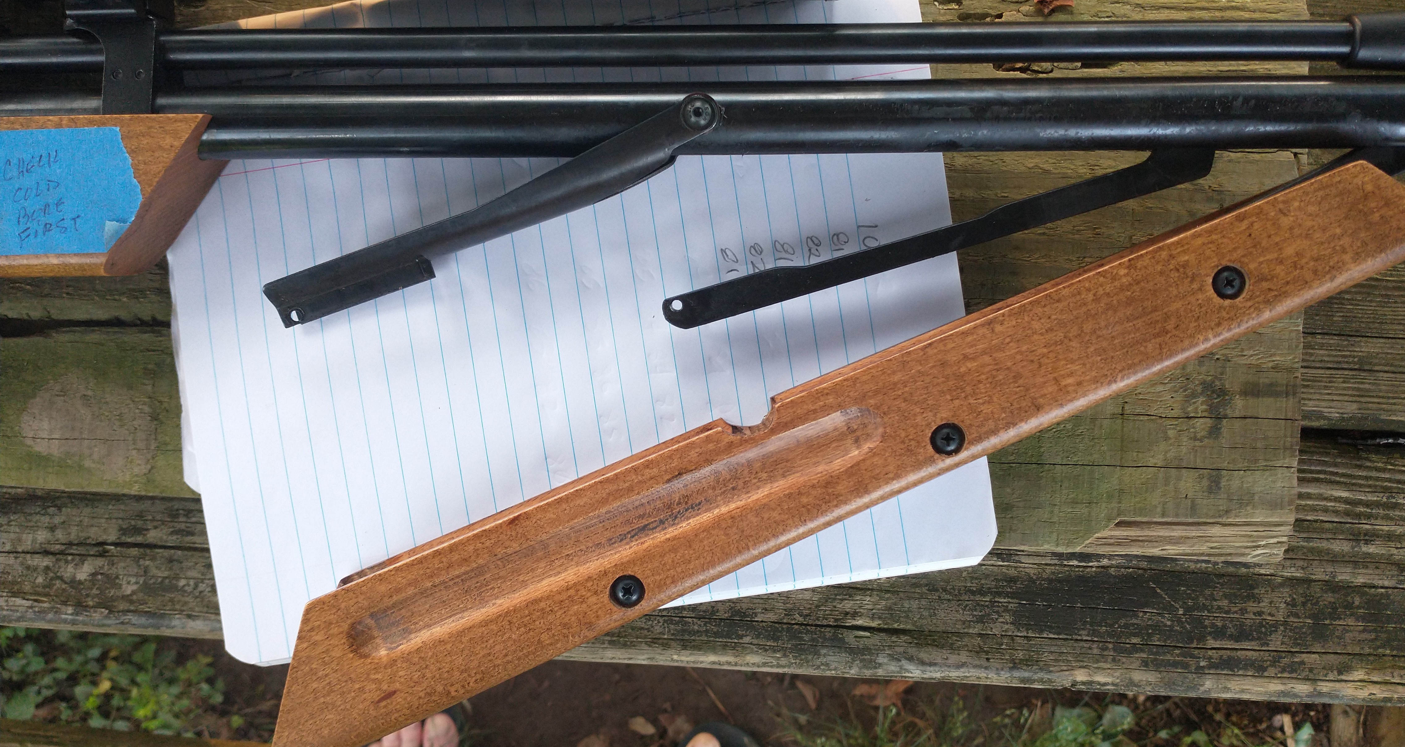

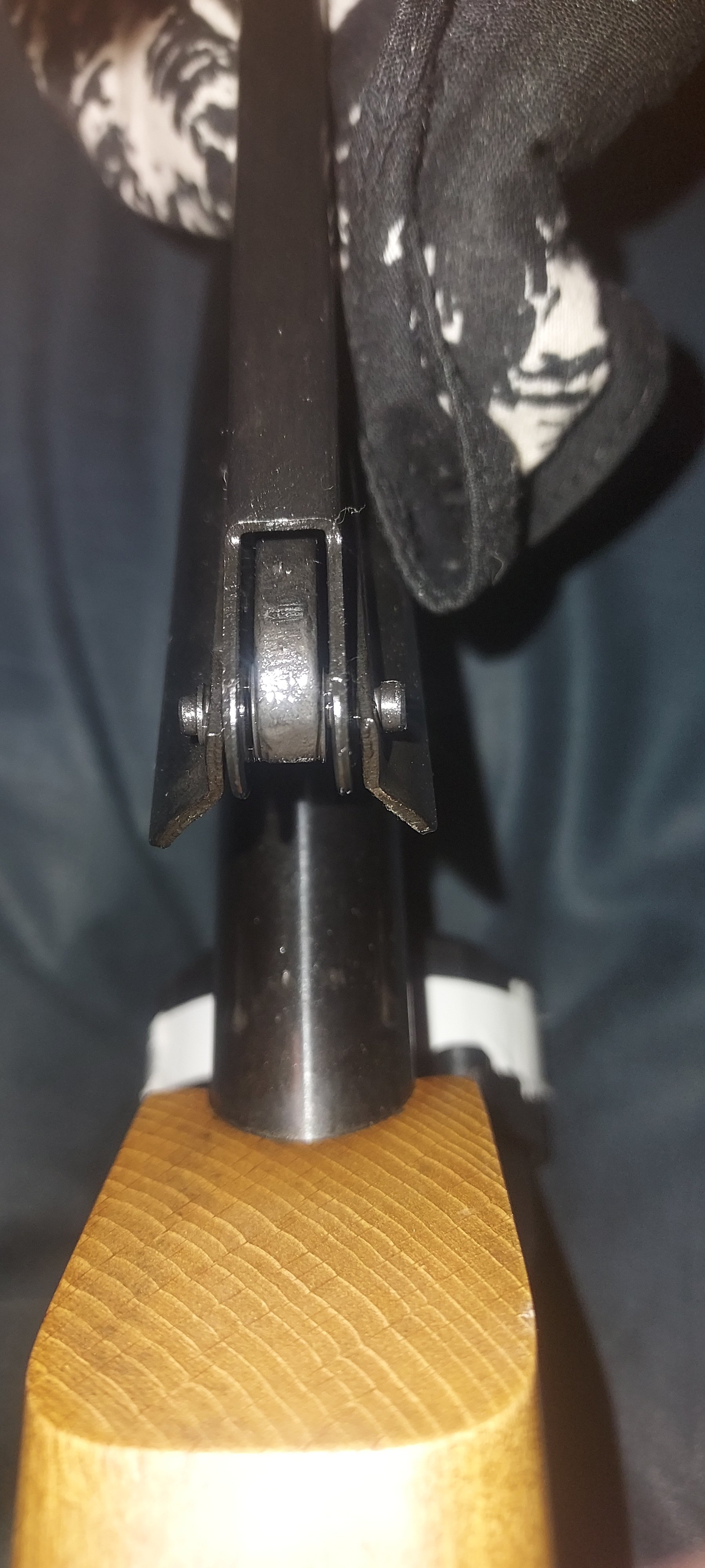

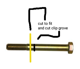

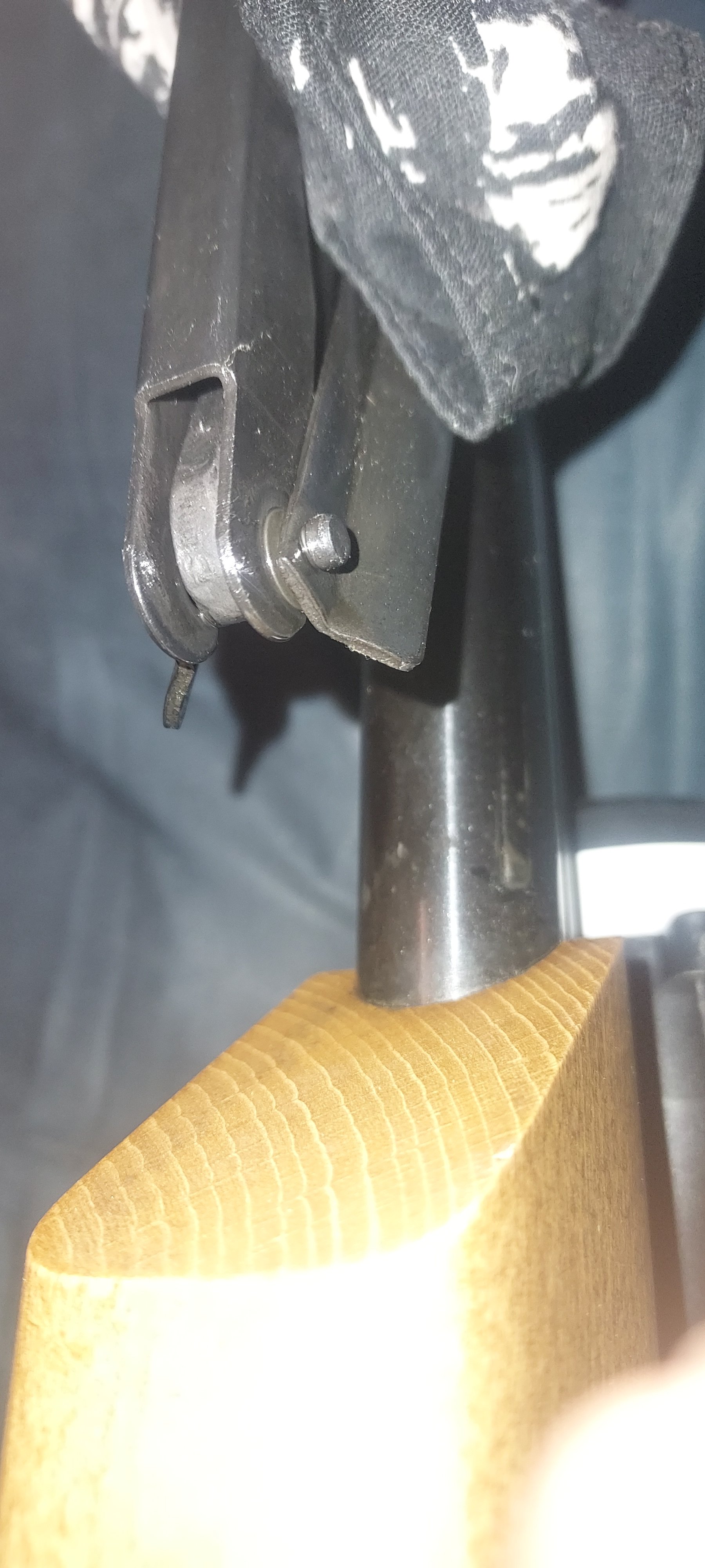

This part has failed again. The actual pin itself failed.
Beats me... I'm left handed could that be it?
Looking at them holes seems wount be long before the hole in the linkage wares through that thin side of things .. running short on metal in that area..
As far as the pin maybe you could harden it with a torch and oil quenching .? Maybe that linkage around the pin holes need that as well ..lol
Reactions: HPP-Mechanic
I think you are right. I will just temper it all after final assembly.
