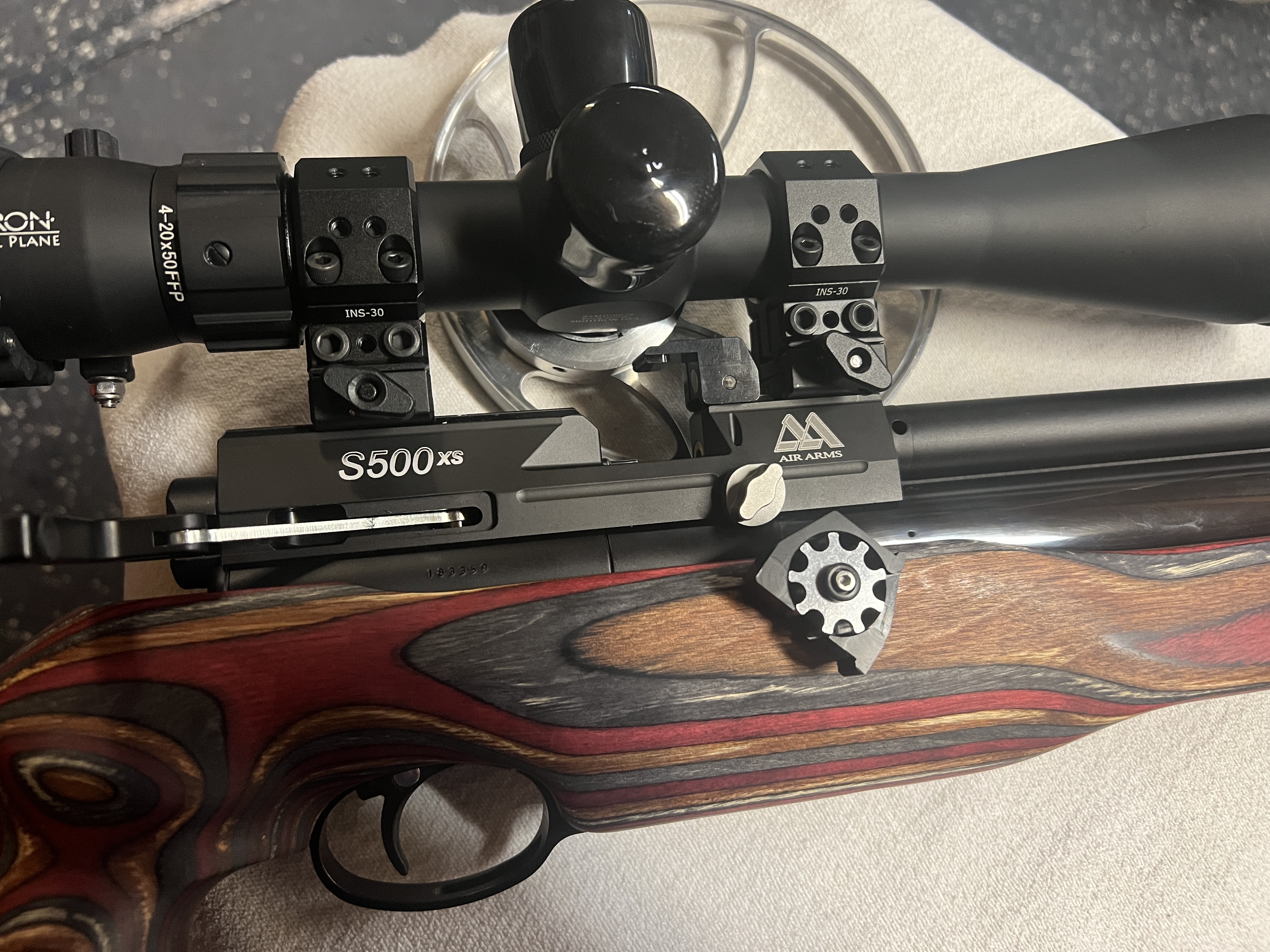

I love the S500 but I am concern the power level is from 20-32 ft lb and I can’t exceed 20 ft lb . I would like to turn it down if it’s sending the pellets out of control. Is that possible?

5 power settings - im shooting 10.3’s at 905 fps on pwr level 4 so plenty more to turn down. See airgun detective on YouTube

For the AA 500 lineup you can add a 8 shot manual rotary mag from Rowan Engineering... a nice feature.
One funky thing about AA lineup is their stupid proprietary fill port. Easy fix... simply buy a QD fitting from Best Fittings in the U.K. for less than $20. You degass the gun by loosening the gage, or cracking the fill port fitting, and in less than 10 minutes you'll have a standard Quick Disconnect Foster Fitting. Easy Peasy
