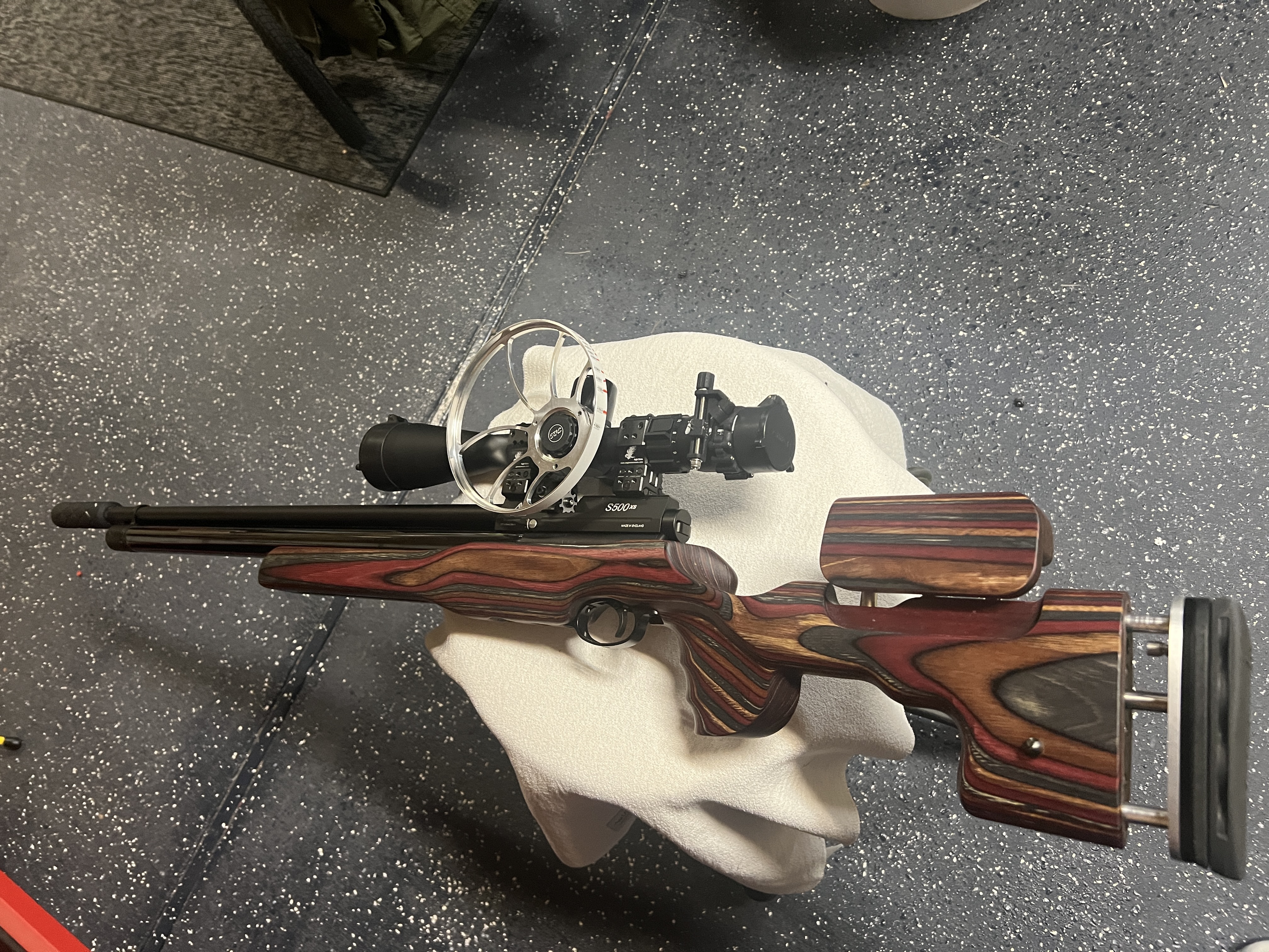

Looking again at a couple HFT 500s. There are a couple in the classifieds. I sent some PM messages. But there has not been any response. The one is completely modified. The other is in like new condition.
The modified has everything I want and is professionally tuned.
Now I am playing a waiting game.
A HFT 500 regulated with a LW barrel definitely qualifies as a dream gun.

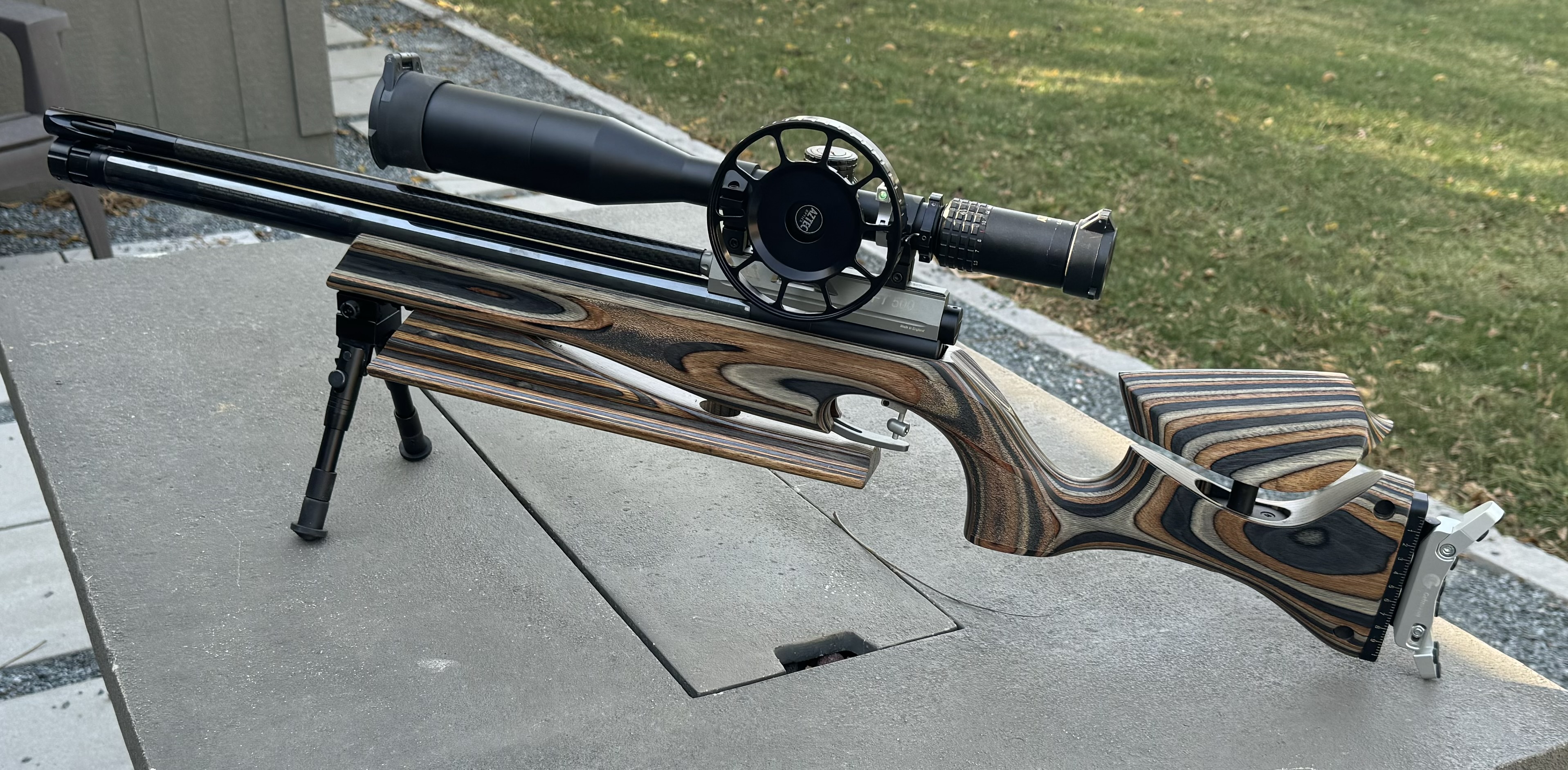

Want a fantastic piece of art. I am just blown away by this gun. Not only is it my dream gun. It shoots real good. 😗

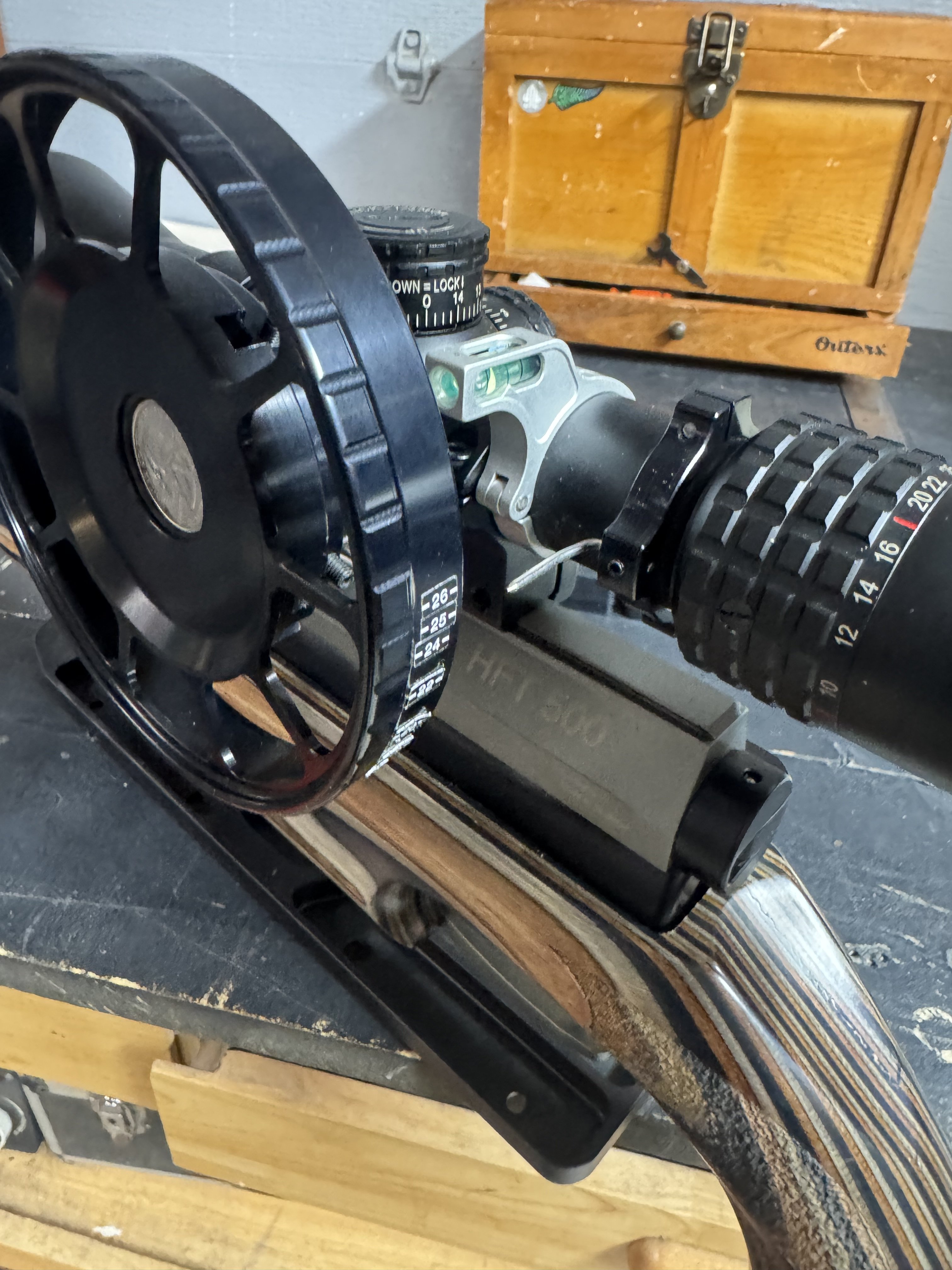

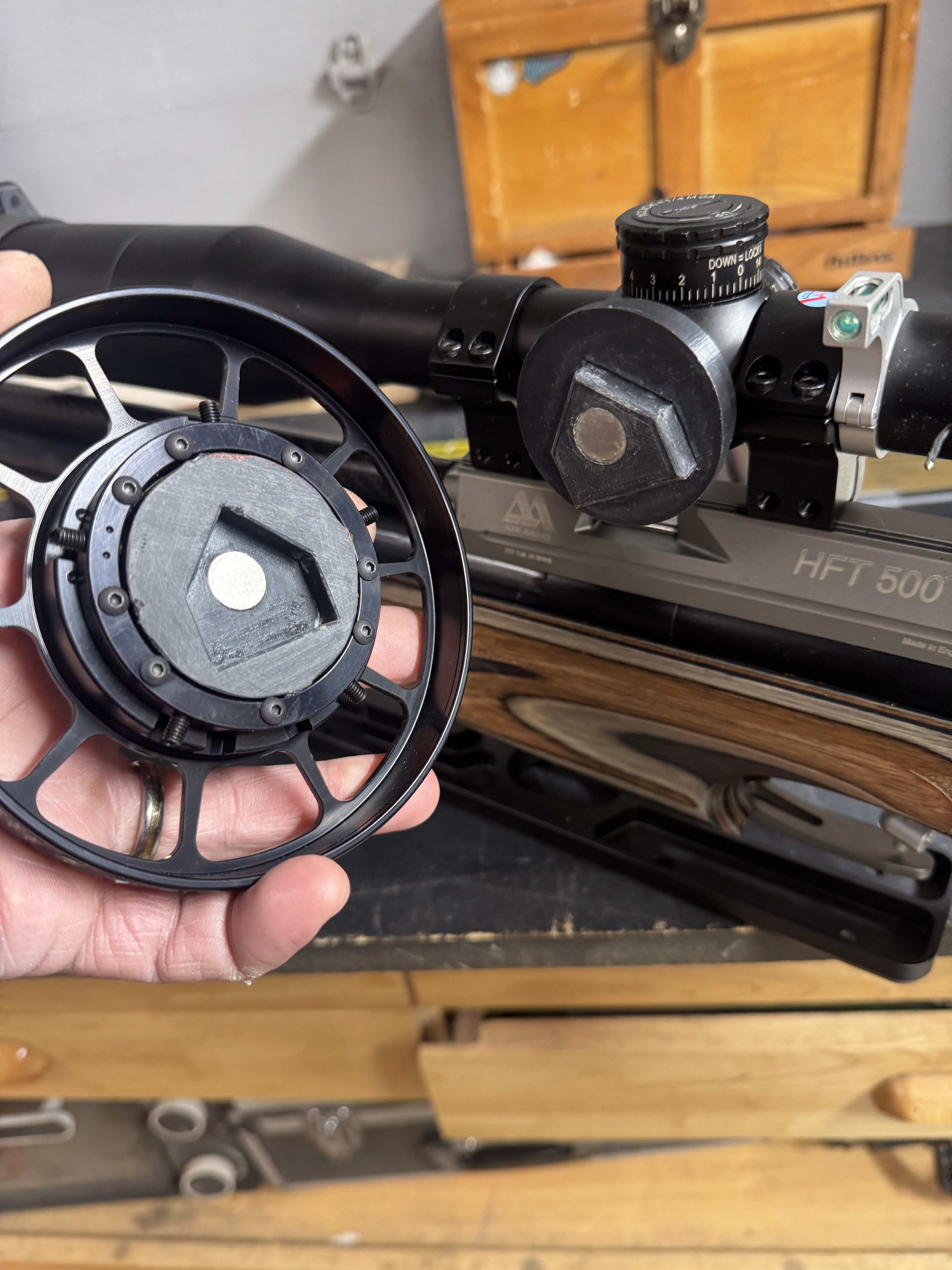

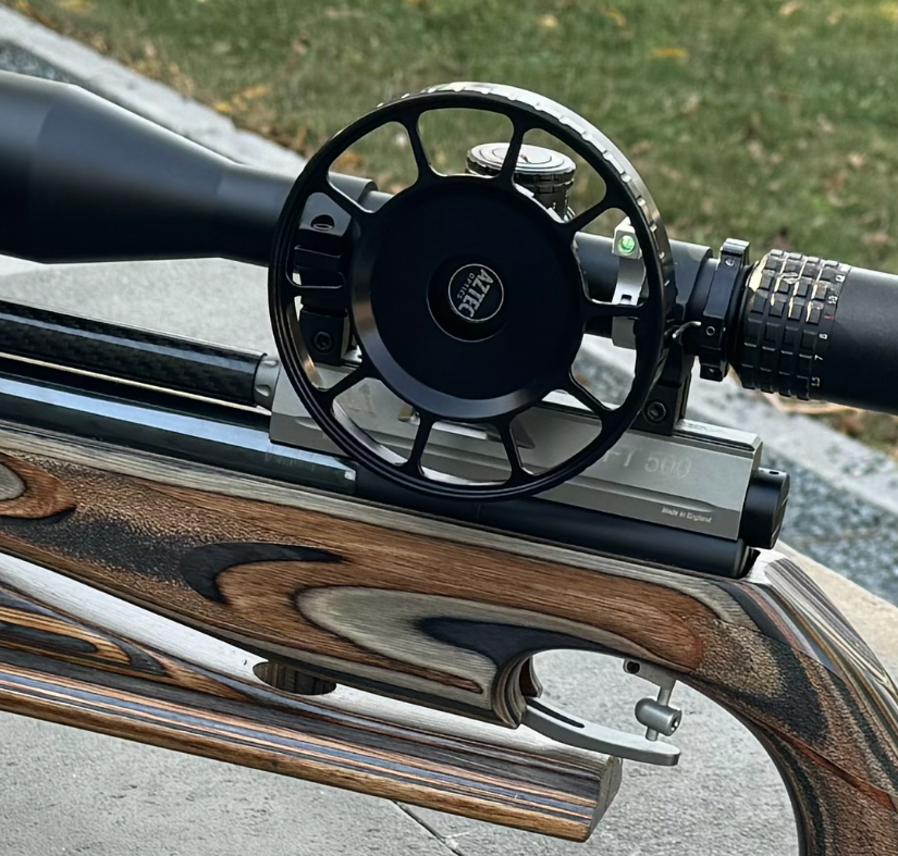

I am not a fan of 3D printed parts. Nothing wrong with them but I am an old school machinist and prefer metal. So I got a new 125mm Rowan engineering side wheel. I spent some time yesterday and set up the side wheel with the numbers out to 24 yards. That is all I have in my back yard.

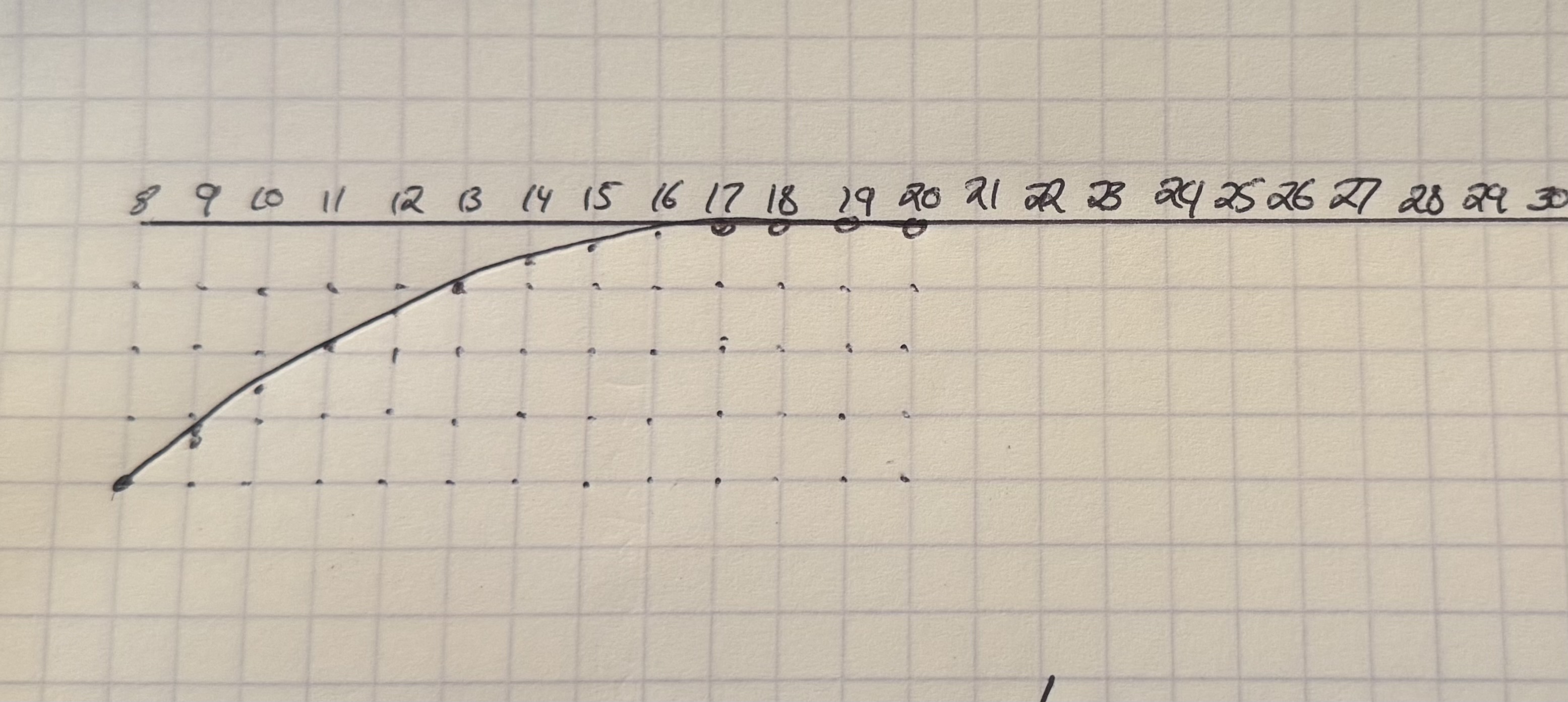

Today I started to make a dope chart. I pumped up the 2800.
I tested this gun on the chronograph. It shoots 10.3 Diablo fields at 880 fps and has a standard deviation of like 1.
And a 300 cc air tube with the regulator so this was beyond satisfying. .

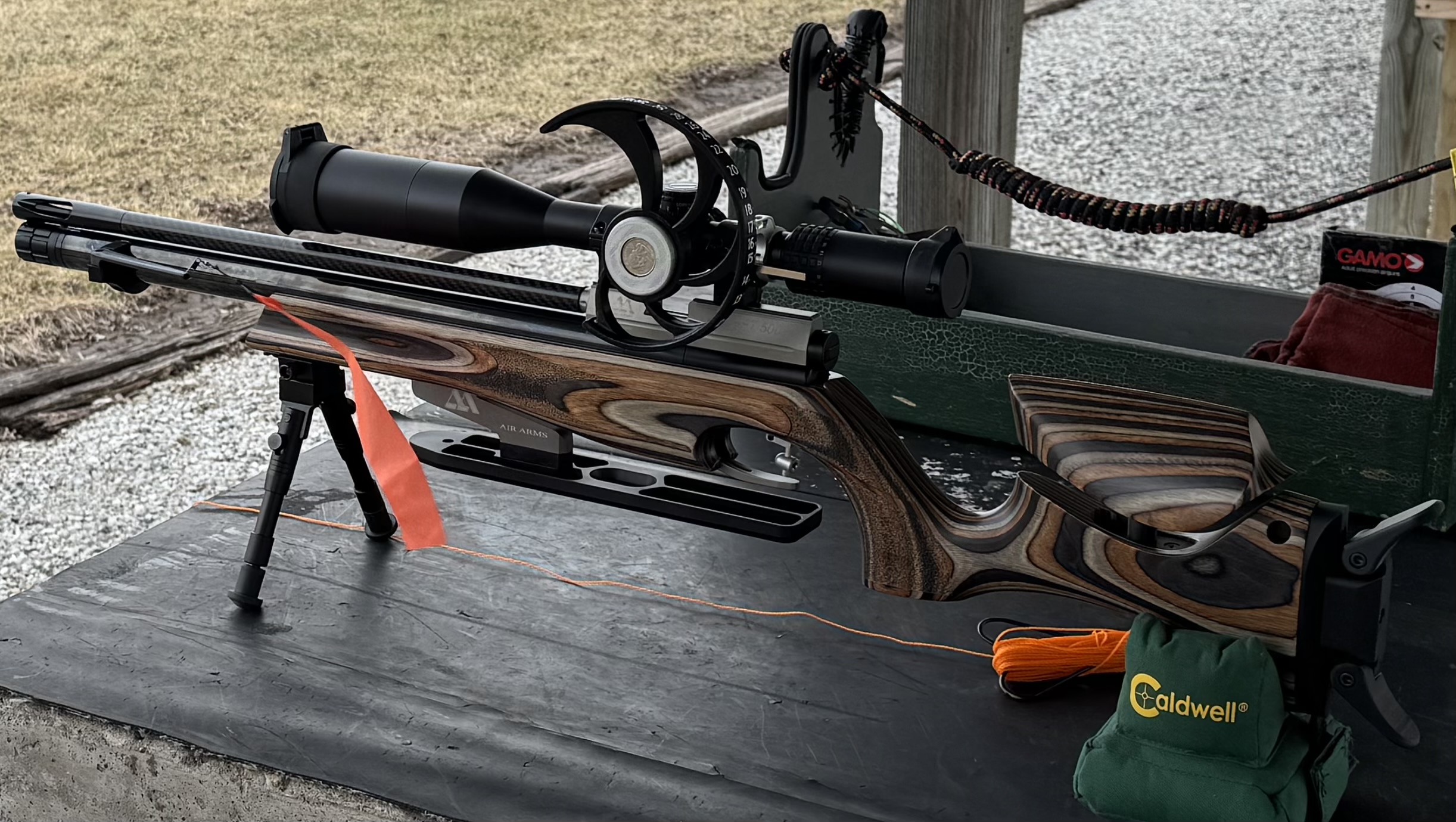

I started at 8 yards and guessed four dots down. BANG right on . Then three more into the same hole. It did this like nothing to the zero of 17 yards and held the zero out to 24 yards. I am not sure when the zero will end so I get to do more testing. But seriously every shot was spot on. The sad part is I will let this gun down in competition. No way I can shoot as good as this gun is capable of.
The only caveat is the scope . Absolutely nothing wrong with it. But I can see the advantage of a lighted reticule. The super fine etched crosshairs are difficult to see on a black background.

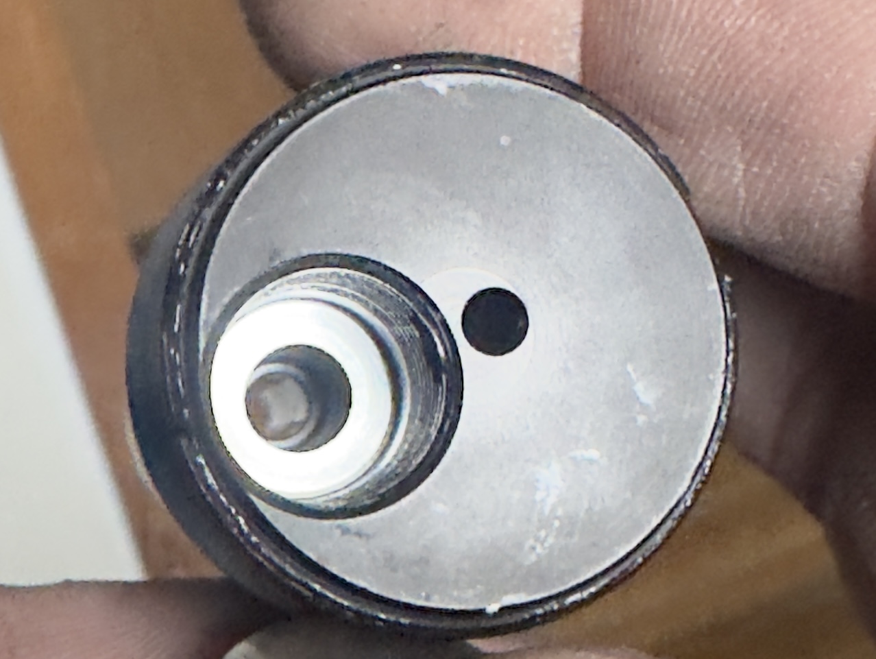

I had a bit of an experience this week. Sunday night I was saying goodnight to my airgun . Just to tuck it in and read a bed time story. When I noticed it was empty. I tried to pump it up but it would not take or hold air. I cocked it and it pumped up . But when I pulled the trigger it lost the air and and and would not pump up. After some investigation air was coming from the bleed hole.

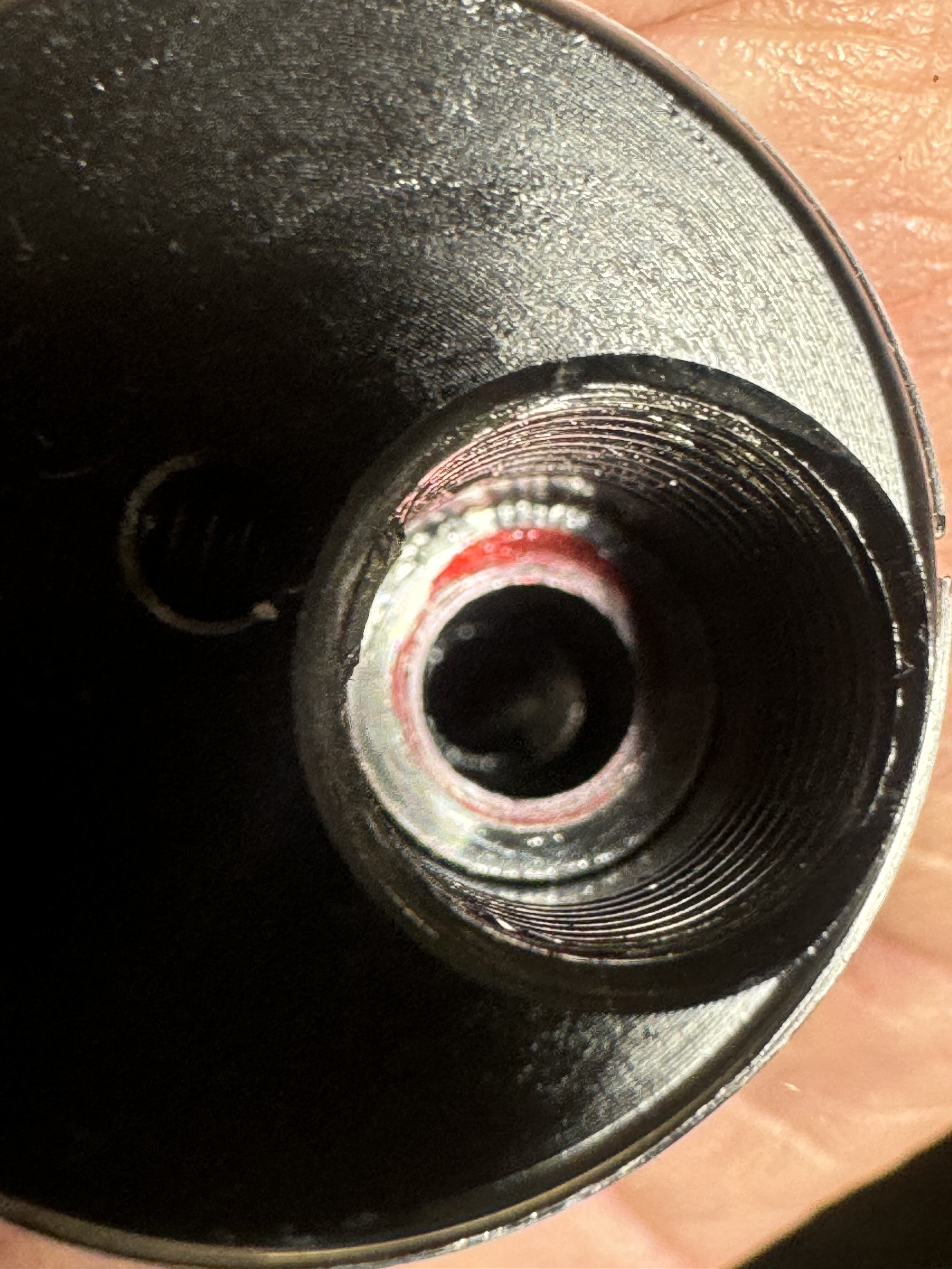

I disassembled everything over a two day period of testing and found the regulator seals are hard. I believe the regulator might have moved and exposed the bleed hole.
But after fully servicing the regulator . Air was coming out of the barrel . It had been all along I had to remove the stripper to feel it.

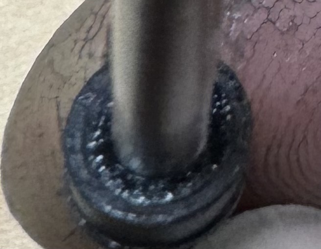

So I went in and found the piston dirty and hard. I cleaned everything and put silicone on the piston and ordered a new seal kit and piston to reseal the whole gun.

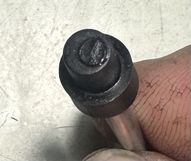

Looks like I need a new valve block and piston. I can’t imagine how many shots it takes to ware out but the valve has a depression that apparently should not be there. And the piston is worn down.
It’s only about 100 dollars in parts to make it all brand new.
Air leaks out the barrel if I increase the spring pressure it will seal but then the power is down 200 fps. So I ordered parts from England.

I replaced the valve and the valve block. It took a bit of fiddling to get the new seal to hold air enough to pump up and full seal. And after doing so the gun shot 150 fps to slow. I think I might have gotten a 12 ft lb firing valve. I ordered S370H . But after putting the old valve in the new valve body it was back to shooting 850 fps with 10.3 gr pellets.
It is holding air and shooting like it was before.

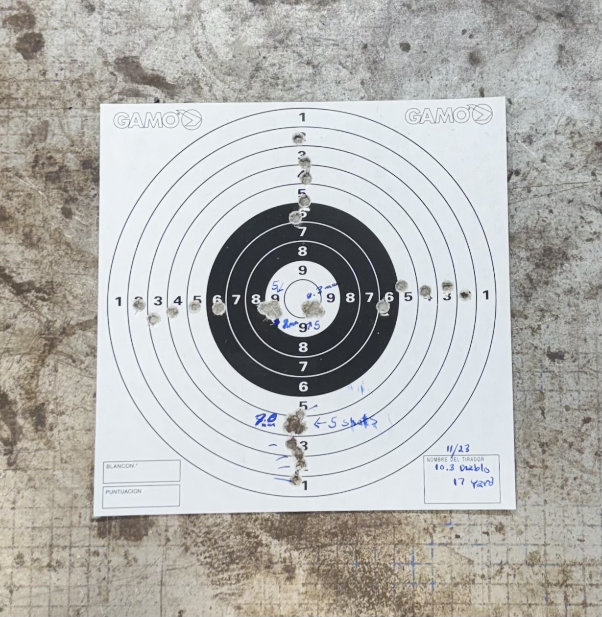

This is 35 warm up shots with 3 groups of five in the 7-8mm size. All shot from 17 yards on a cold blustery morning. So I’m happy to have it fixed.
