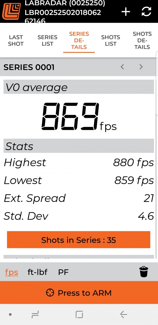

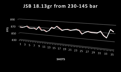

Been leaning about Dreamline proficiency today and check this out... With the power wheel set to position 3 and with the reg pressure set to about 145, tune the JSB 18.13 gr to 870 fps average. You'll get 35 shots at 30 fpe with an extreme spread of 21 fps!

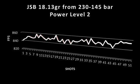

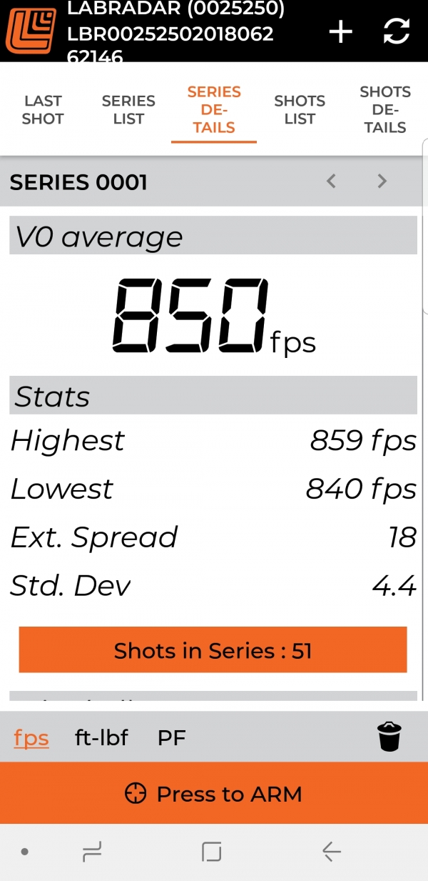

THEN, dial the power wheel back to position 2 and you'll get 51 shots at 29 fpe, with an 850 fps average and an extreme spread of just 18 fps!!
