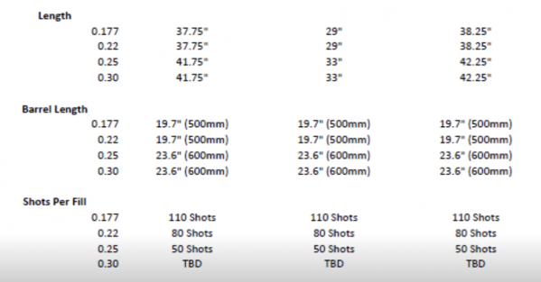

AEAC says 35 shots at 880 ft/s. Utah Airguns says 60 shots at 30 ft/lb? The FX press release says 80 shots in .22? Something isn't adding up here.

I understand the valving and transfer port on the Dreamline is the same as the Streamline . My Streamline .22 cal shoots 860 fps with the JSB 18's and gets 60 shots on the regulator and comes off it at about 125 bar. That is with a 190 cc air tube. It would make sense with a 250 cc air tube it would get about 80 shots. Bill
This makes good sense.
Just want to step in and clear up the shot count for the Dreamline. The press release is based on the Swedish factory settings. They are coming out of the factory geared around the 16gr JSBs which are much more common in Europe (it's hard to even find the 18gr in some countries in Europe). The settings are around 110 Bar and FX USA can confirm that at that setting you can get 80 shots per fill.
We realize that the American market most likely wants to shoot the 18gr with a little more heat behind it to get in the 30+ ft/lb range. So we are having Ernest tune each .22 caliber gun, increasing both the Regulator setting and hammer strength.
Much like our other adjustable guns, you can tune for optimum shot count, or optimum ft/lbs depending on your application.
Hope this clears things up.
