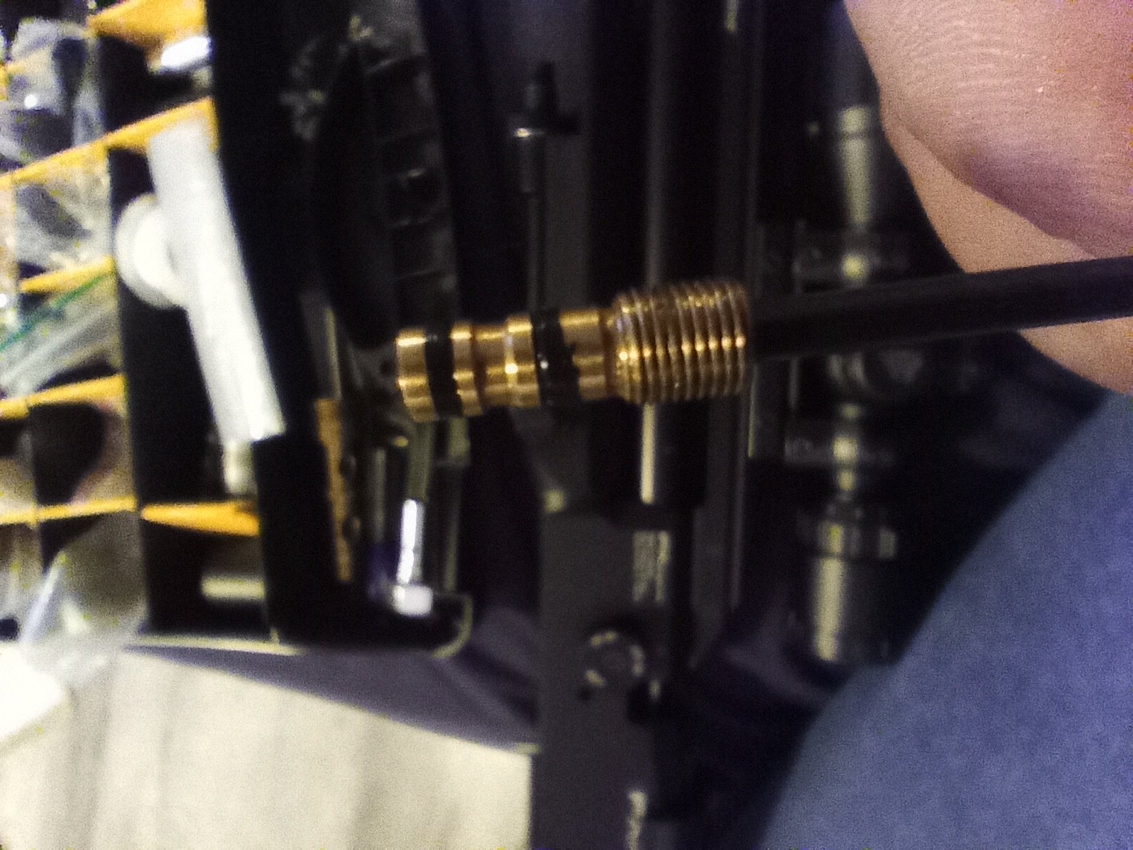

My dreamline has had regulator creep but it didn't really bother me much as it was only about 10 bar over where I had the reg set.. now it's matching the bottle pressure which is way over.. I looked on YouTube and seen that it could be the reg screw o-ring.. so when I went to check it, this time I had a leak.. filled the bottle back up and heard all the air coming out.. I put my finger over the reg screw housing and all the air was coming out.. I removed the screw and the orings are damaged... Does anyone have these orings or know where I can get them from?? Kinda frustrating because I just grabbed one of my other guns and now both of them have leaks also.. have to find out where the leak is on those as well...
