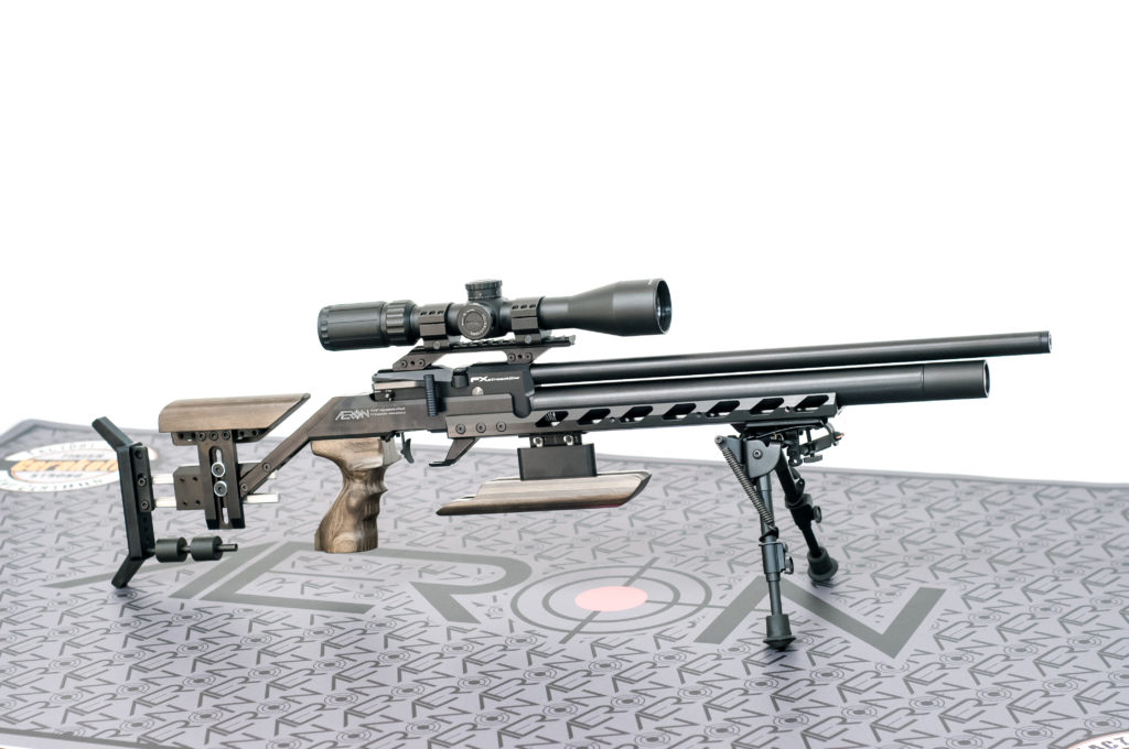

She (the .177) may end up looking something like this some day.

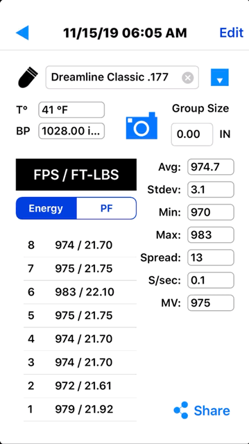

This morning I eked out a little bit more fpe from the Dreamline Classic.177 by adjusting the AMP regulator up 5 bar. Taking from 110 to 115 bar it gained 15 fps and 1 or so fpe. Accuracy is still the same.
Joe, I’m a sucker for nice stocks, & that stock right there is the one thing that almost had me buying an FX. I have personally not been big on FX. I remember Mat in SA talking it up when it was announced, remarking on how good a hunting platform it would make.
Yeah, that Aeron FT stock has the right stuff, adjustments for just about anything. It seems very kool! Seen Matt Dubbs video also..
