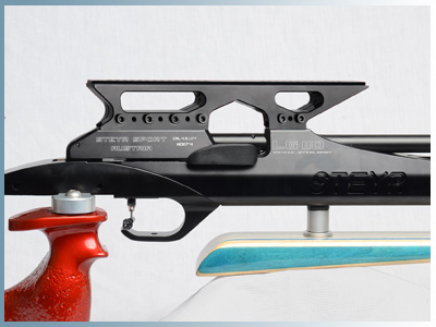

I think a bigger barrier than the barrel is the various and seemingly many parts in an FX. When you experience a temperature shift of 20+ degrees or more in a match the simpler the gun the better. This is because different thicknesses and materials expand/contract at different rates depending on temperature. So the smaller and more intricate parts that make up many of FX's current lineup are susceptible to this type of movement. Which will have you chasing your zero throughout the match.

It's not an issue specific to FX, but to all overly complicated platforms. Steyr, Anschutz and FWB can suffer from the same issue resulting in an increase or decrease in fps, as well as frame movement. The fps change is managed with a chronograph and hammer spring adjuster if caught before the match. As for frame warpage/movement a very sturdy bridge is used to help with frame flex. So those fancy risers on the brands mentioned are more for platform stability than getting the scope up for proper eye relief.
