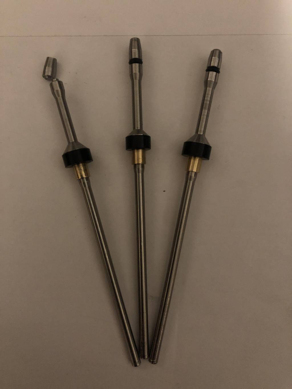

If anyone is interested here are some valve pin pics.
Left is my broken pin (obviously). note the cone (black) on my broken pin is wider than the middle pin (20153c). 1/2mm to be exact, but the tip is the same length and shape as my broken pin.
the one on the right (20153c-1) has the same shape and scone (black) size but the tip is shorter and shaped differently.

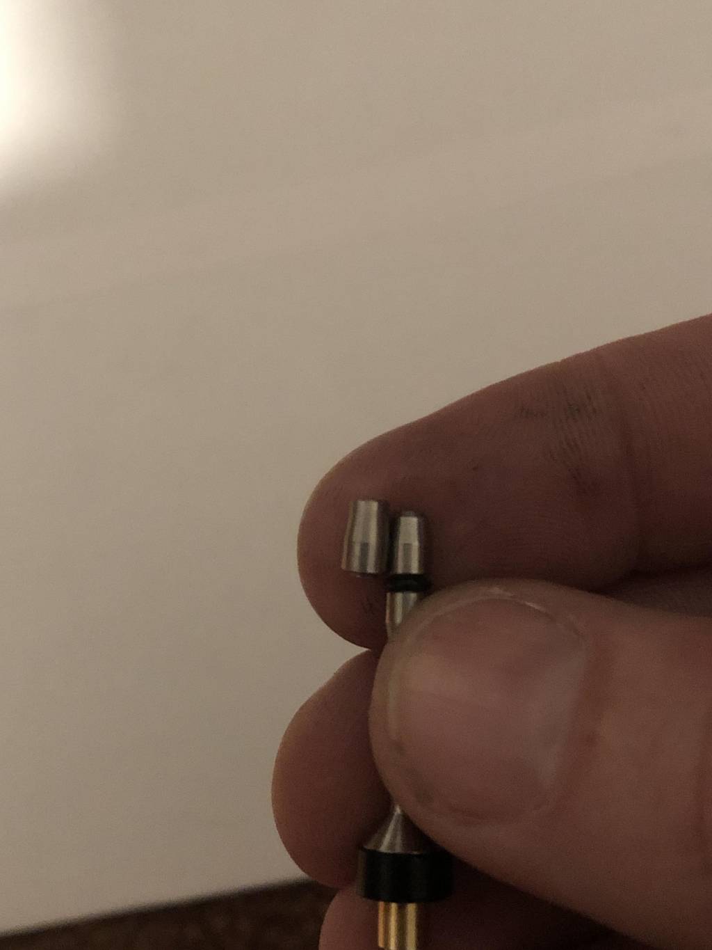

side by side, and yes it’s just the tip :) tried to align them to show that one is slightly longer
