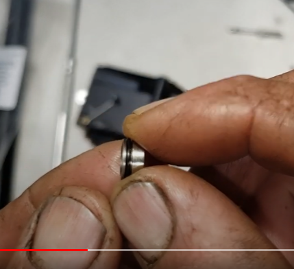

I'm helping my friend with his dreamline, the valve pin snapped. FX sent replacement valve pin and valve seat, install was easy and done in no time. HOWEVER, I could not get the valve to seal. Every time I put air in the air just rush out the TP. Talked to FX tech and tried a full 250 bar bottle with reg closed and open quickly. Dry fired a bunch of time but still not able to get the valve to seal. Check valve seat orientation and everything looks good, anyone has any tips to get the valve to seal?
Thanks in advance
On the outside of the valve seat, it has a wide side, the o-ring, and a narrow side. The wide side needs to be facing out. What cfs916 said. Fat side in that picture is to the right.

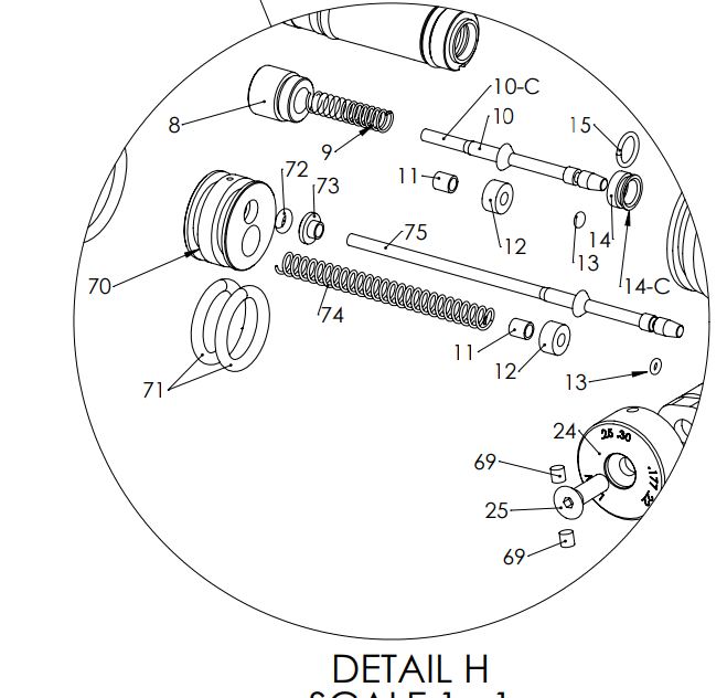

Edit: Really there’s only three components... Valve pin, seat and body.. Got to be 1, two or all three.. I'd try new valve pin and seat..
