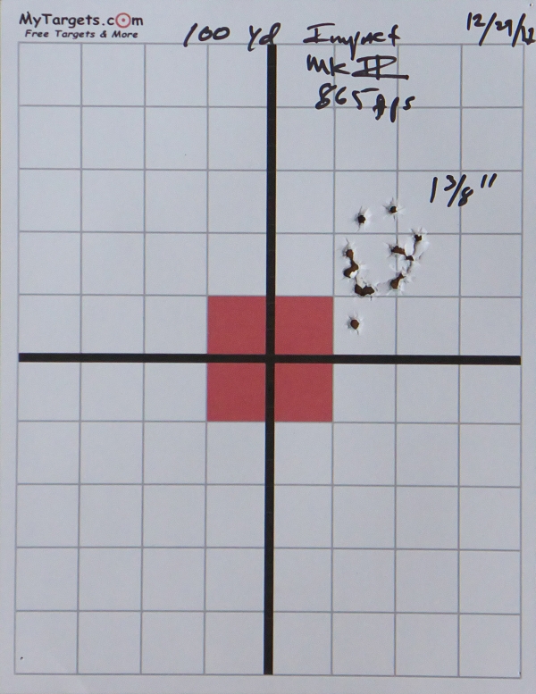

So I’ve double checked the scope, lined it up square using a plumb line. Zero’d dead center at 30. I have a bubble level mounted on the scope but at 100 yards it has drifted to the right about 1.5” on a totally calm evening. It generally drifts.
What am I doing wrong other than being a bad shot. Mind you the group was 10+ shots at just over 1” (personal best).
Using exact heavy MKll in my Impact.

Thought I'd post the target. The group is high, went by Strelok. Actually, I took 16 shots; fifteen were in the main group and the last shot was the low one and checking showed I was off the regulator...honest, ;) Will be checking the scope and testing once the wind dies down. It's honkin' out there!

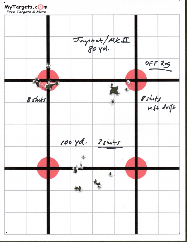

I re-checked scope (w/ plumb line) and gun and found that the rifle cant level was off just a hair. Re-aligned it and the gale force winds died down enough today to shoot. I shot groups at 60, 80 and 100 yards.
While on the regulator, groups were well centered but as the gun went off the regulator, the 2nd 80 yard group drifted a little to the left. At 100 yards and back on the reg., once again things went way right even against a very slight/steady right to left wind.
I'm wondering if things might stay better centered if I slowed down to maybe 830-840 fps? Maybe the pellet starts to become unstable at 100 yards at higher speeds (865fps).
I'll try that when conditions approve. All thoughts/ opinions welcome.

Your still shooting some amazing groups. You might try backing the speed off and see what that does. Also try the MK-I's and MK-II's. Then try just a little lube on them. Somewhere right in there it's going to come together I would think. BUT, then I have days were I wonder. Whats wrong with this gun! Next day it will be fine again. Wasn't gun at all. It's me. sylvan
Sylvan, the last thing you said couldn’t be more true. One day great another day WTH?!? I too figure it’s me.
What lube do you use? That might be worth looking at again but the left drift at 80 yd, when the gun got off the regulator has me interested in experimenting with speeds. Barrel harmonics might also be coming into play along with diabolo design and stability. Thanks for the input.
