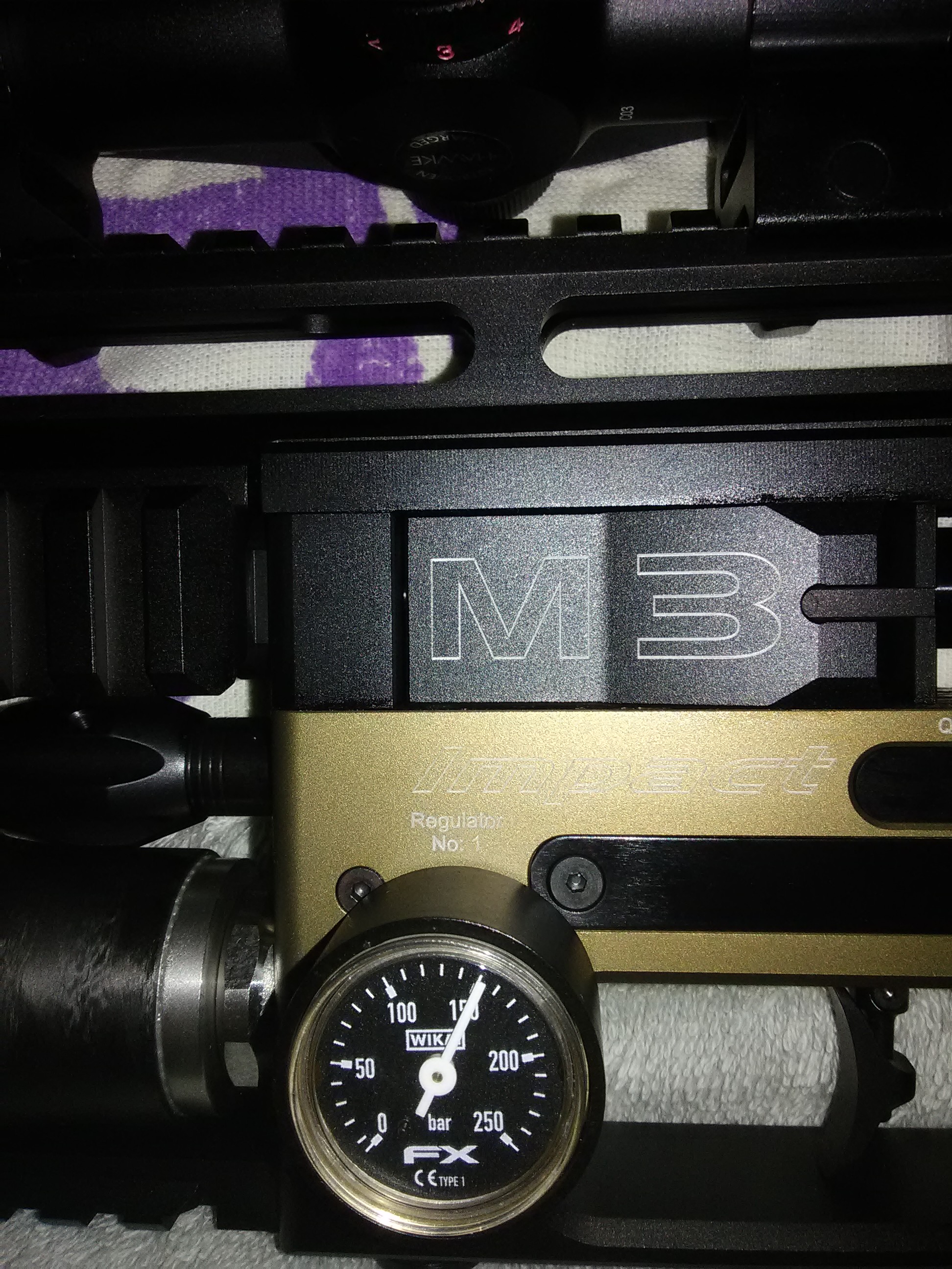

Indy,
My M3 has two regulators and three manometers (gauges). Gauge with "Max Pressure 250 bar," labelled behind on receiver, is for bottle. Second gauge, labelled, "Regulator No. 1" is for first regulator and third gauge, facing down, located towards rear, is for second regulator. My first regulator is pictured, I don't shoot lower than that setting. WM
