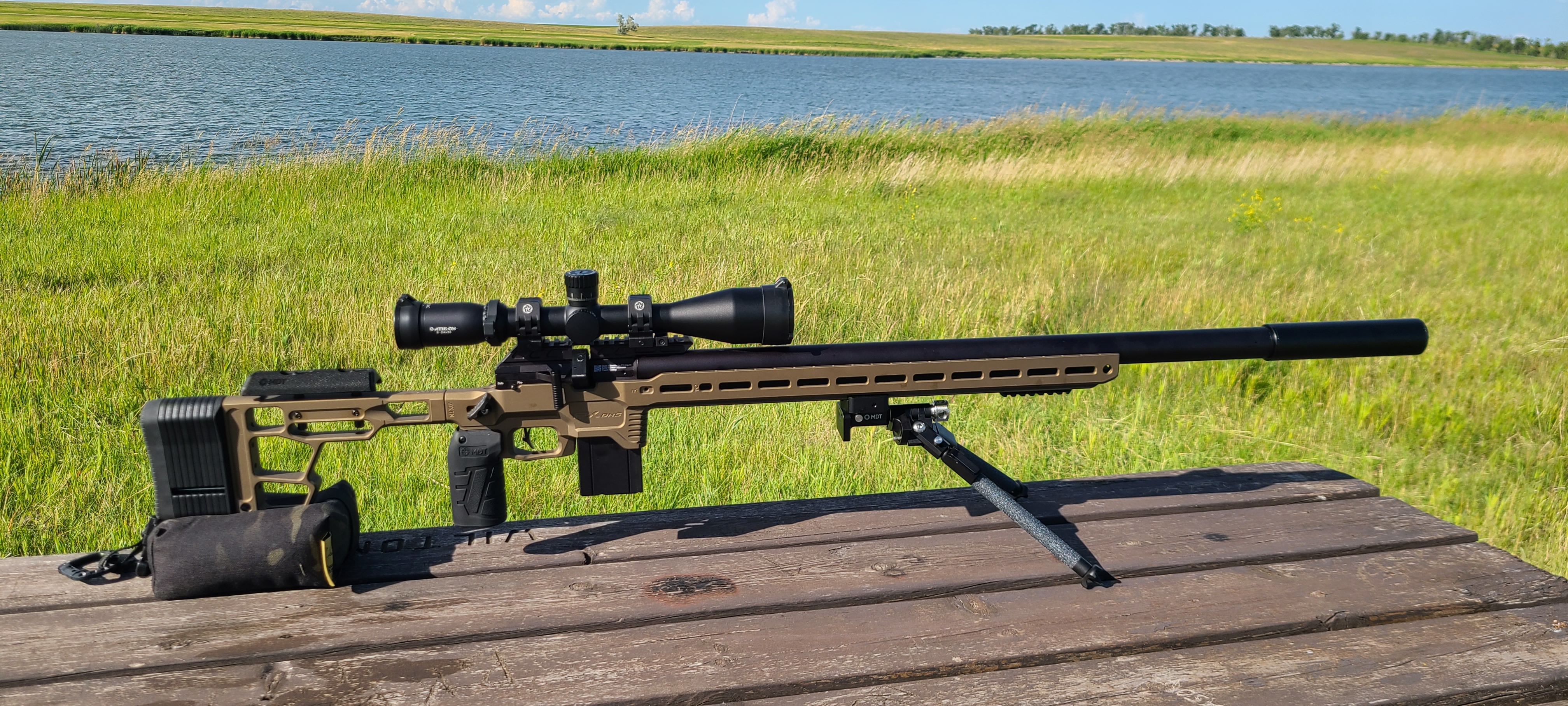

I just received a DRS 25 700, it is even better than I thought it would be.

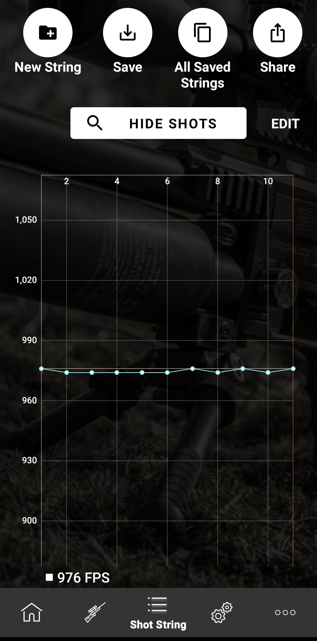

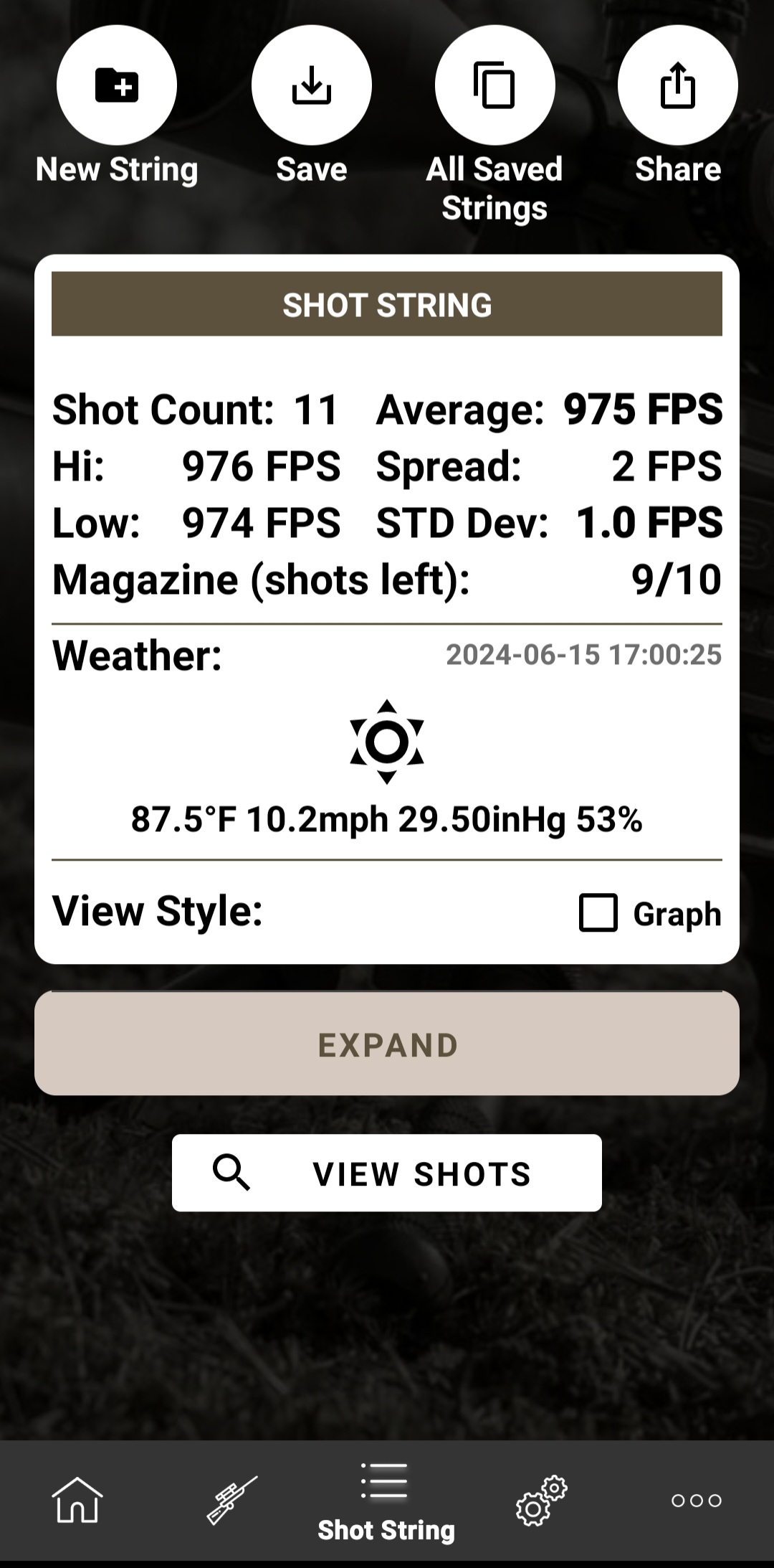

Out of the box the reg was set at 128 bar, this shot the H&N 40gr heavy at 935 fps.

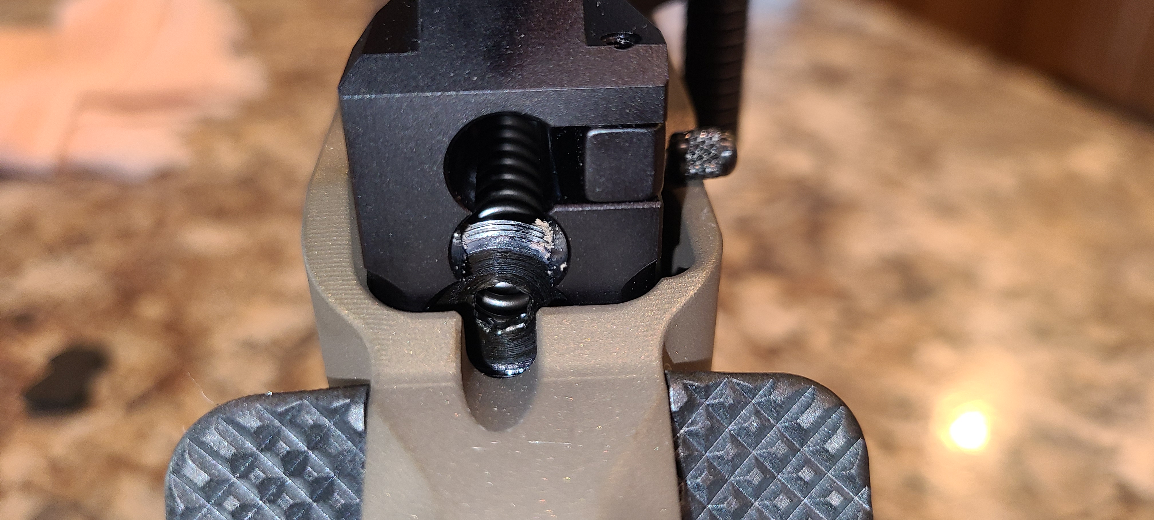

I set the reg to 150 bar which gave me 970 fps without touching the hammer tension, but it wasn't very consistent, my experience with my DRS 22 700 was to reduce hammer spring tension to get a more consistent shot string.
This made it worse, so i slowly increased hammer spring tension until I got this shot string.
I was only able to get it set up and sighted in.
There will be more to come, like shot count and accuracy.
Just in case anyone is wondering the DRS has become my favorite rifle.
