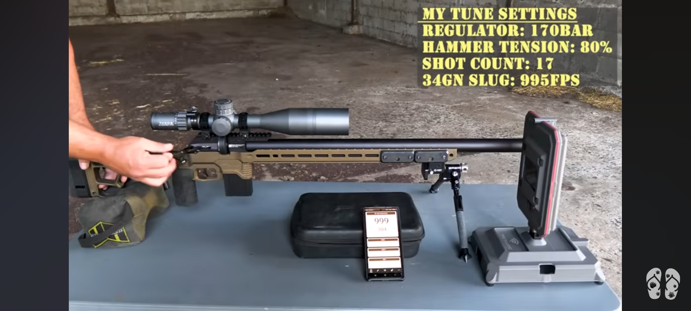

I haven't tried setting my reg above 155bar yet on my 22 700. That will shoot the .218 34gr H&N Heavy 945 fps.
At 4:12 in this video
