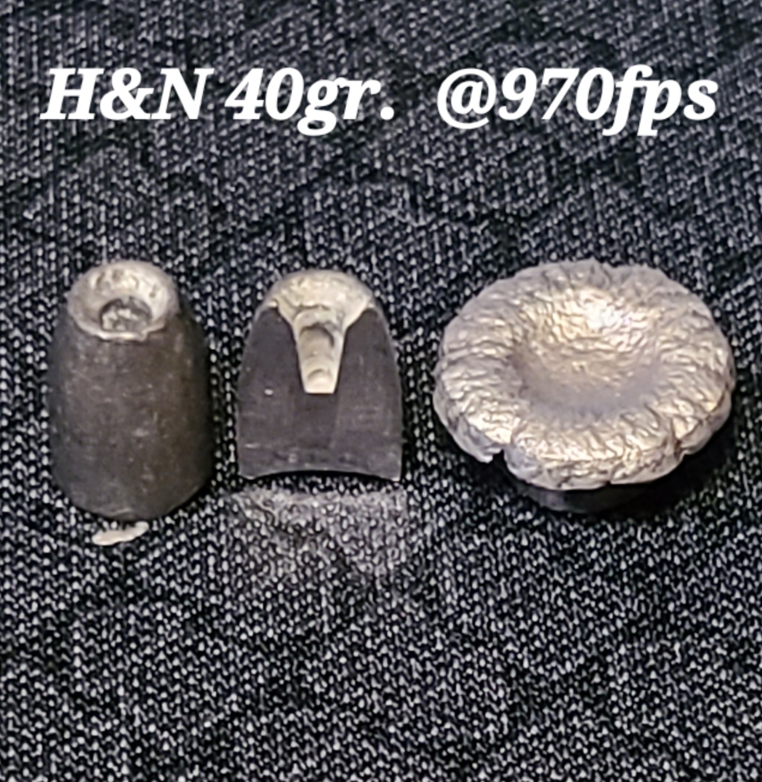

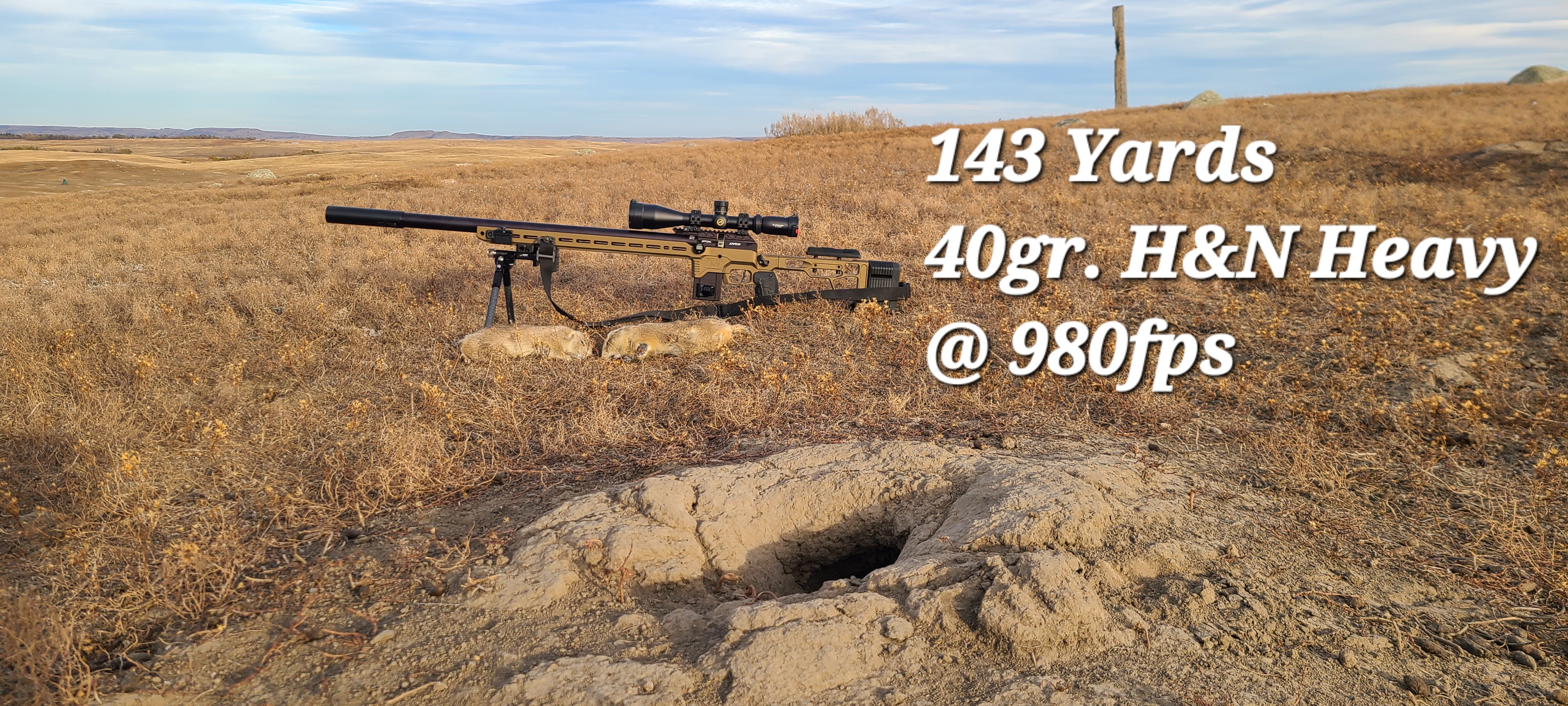

H&N Heavy 38gr to 46gr. are extremely accurate from my DRS Pro 25 700.
I use the 40gr at 980fps
My DRS Pro is also extremely accurate with the 40gr Javelin slugs, but they don't expand as well as the H&N Heavy slug
This slug was recovered from a 90 yard target.
Shotcount with that setup? And what preassure? :D
