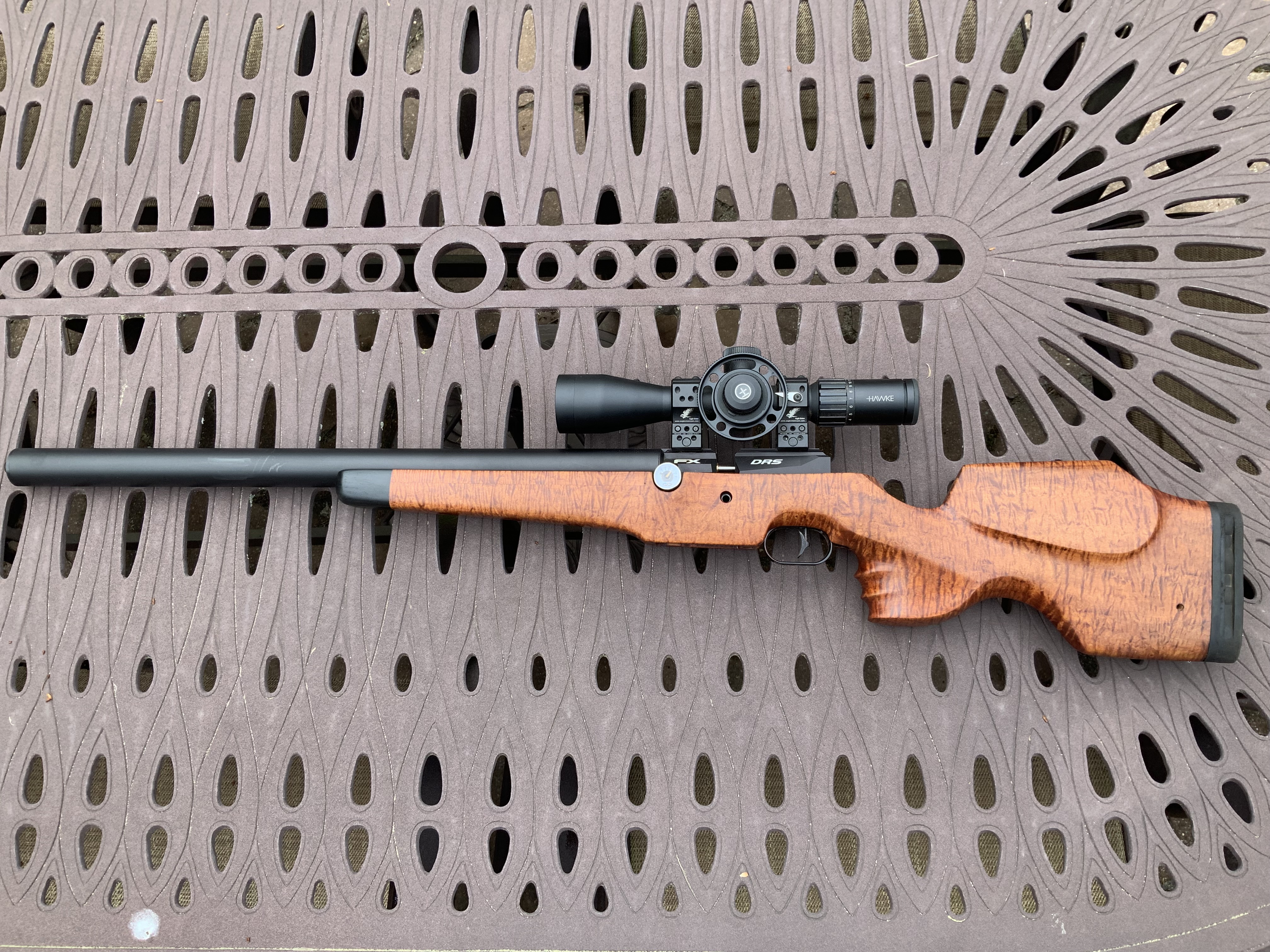

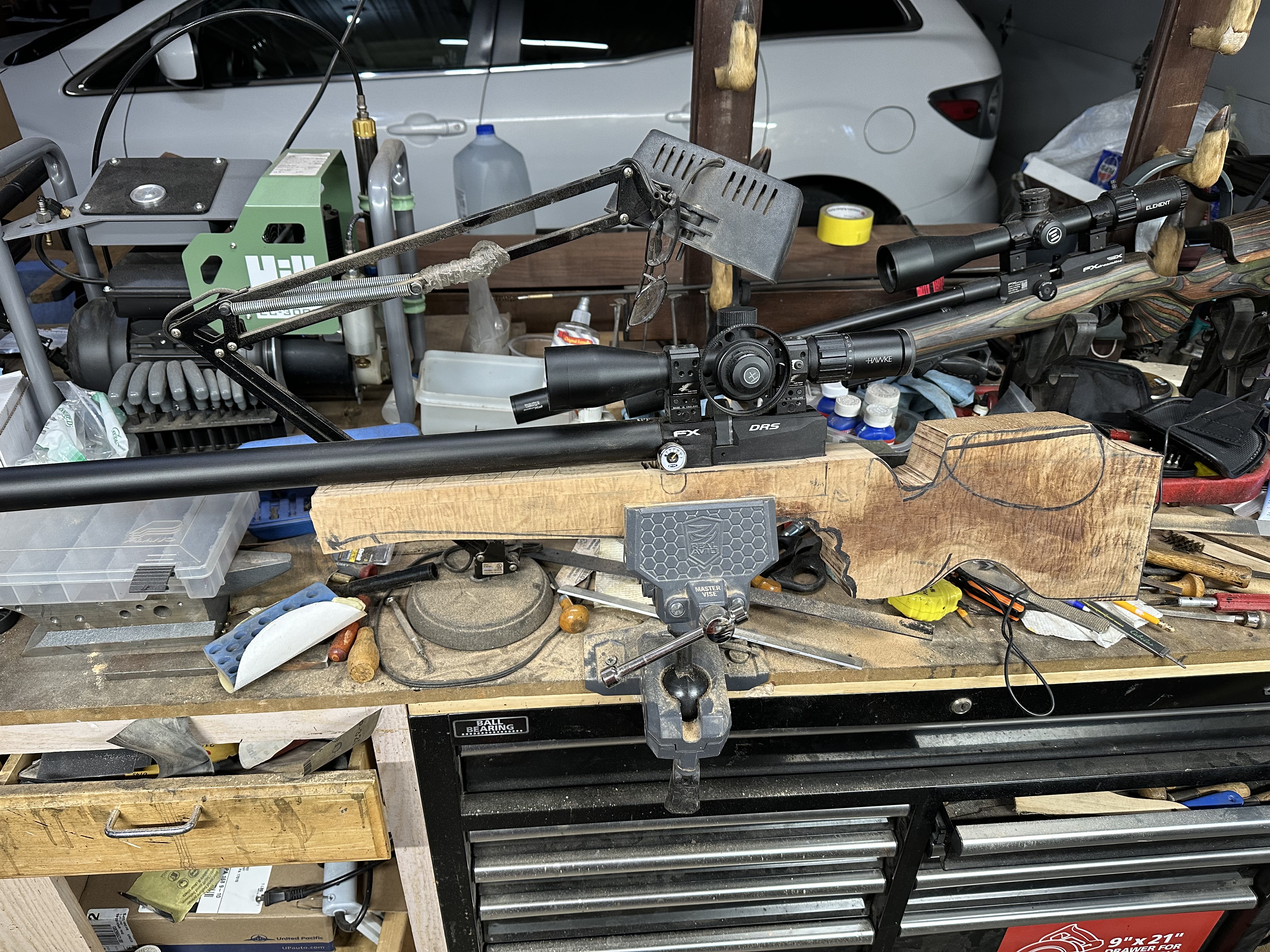

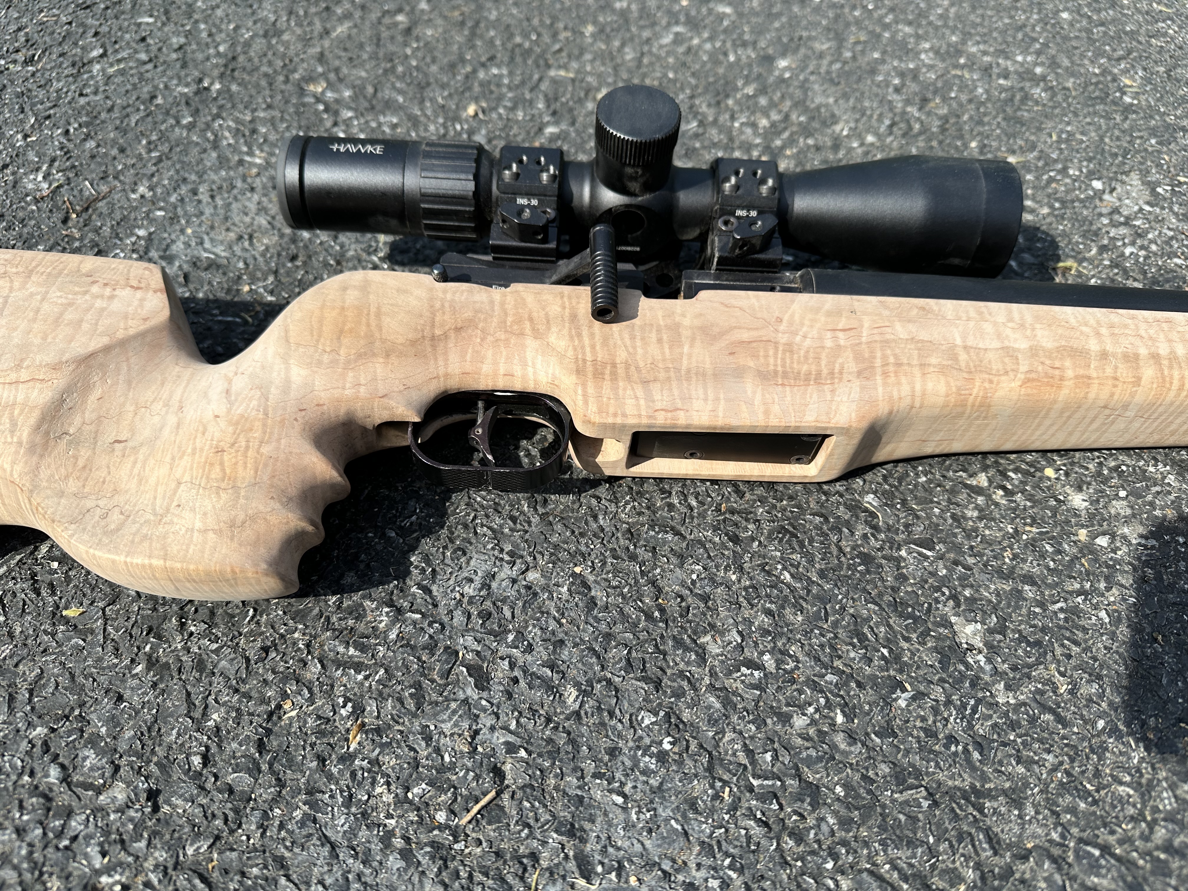

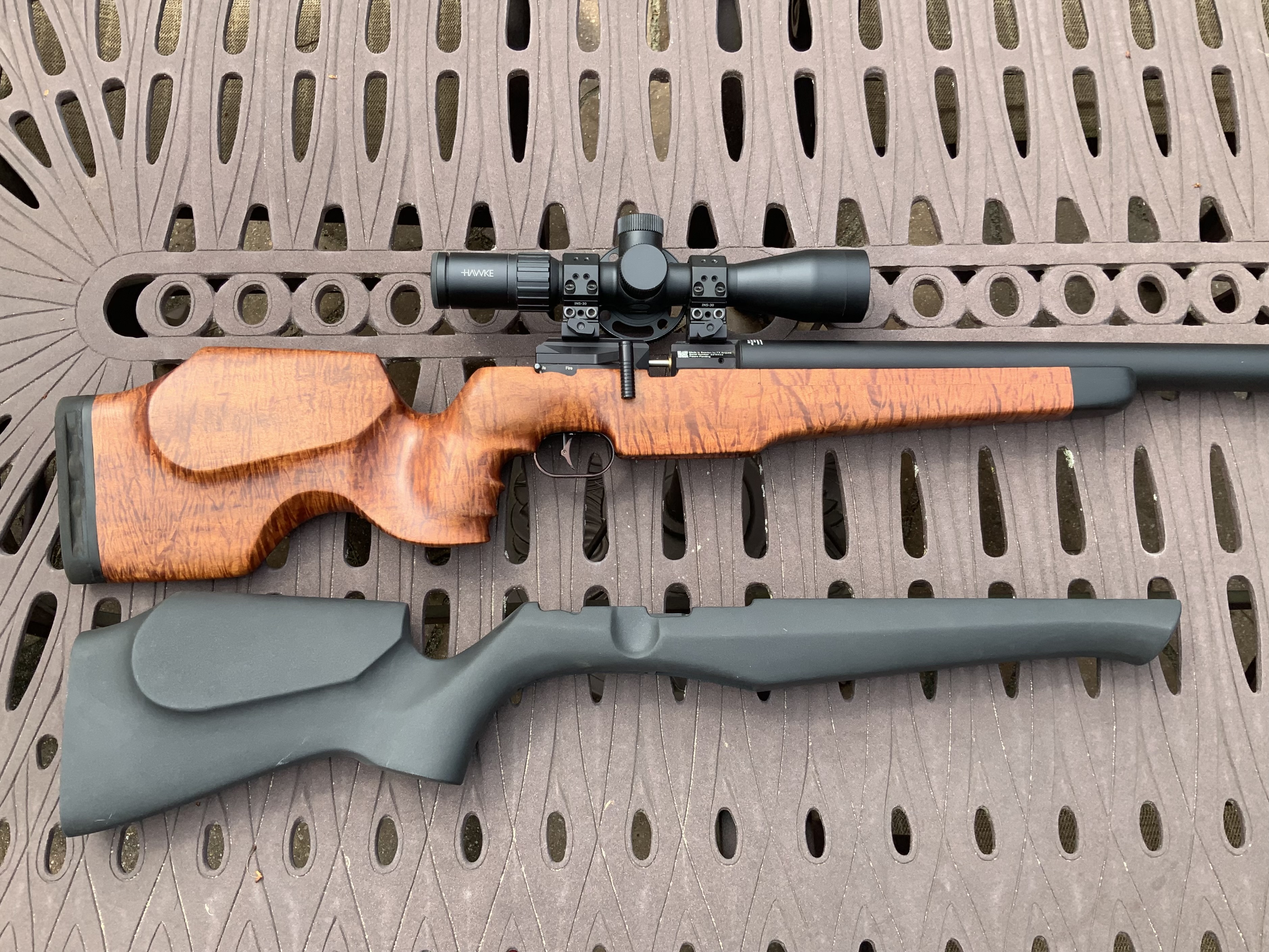

Here is my custom stocked DRS. I copied the grip of the GRS stocks the cheek pad of the DRS adding another 1/2” in height to offset the picatinny rail height and added some wood at the plentum in case a midsized plentum is ever available. Sort of looks a little like a Rigby rifle. I now have the large plentum with the two long chambers plugged. The maple wood is a soft silver maple and only added 6 ounces over the standard synthetic stock. The added weight of the moderator and the larger plentum helps with the handling of the rifle. I found the stock synthetic stocked rifle to be too light for my taste. It feels good to me now.
Beautiful work , great to see people using softer lighter woods , no reason to use hard woods on an air rifle or most PB's .

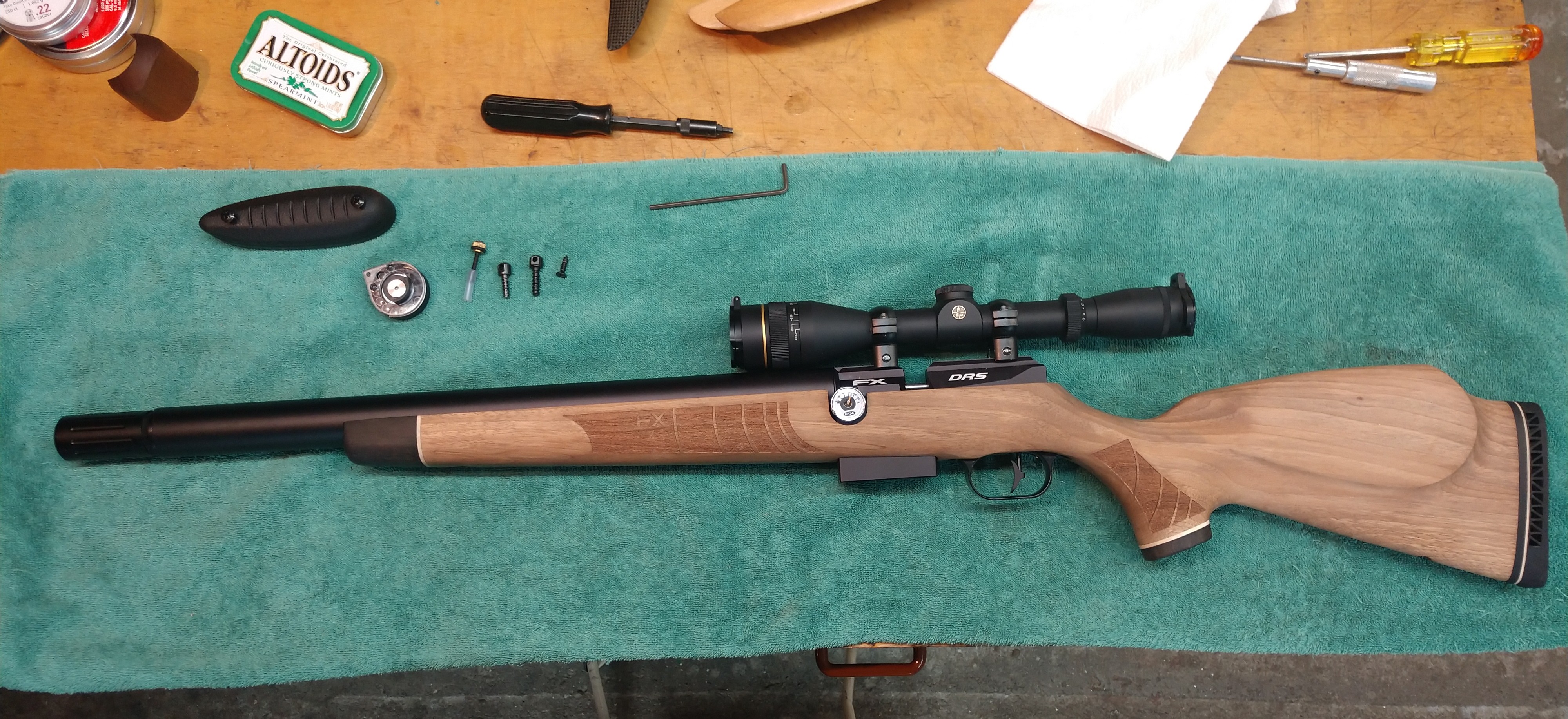

I wanted the Grade 2 Walnut, but couldn't find it in stock anywhere. Utah Airguns said there should be some Gr-2 walnuts coming soon, but couldn't really be sure when.

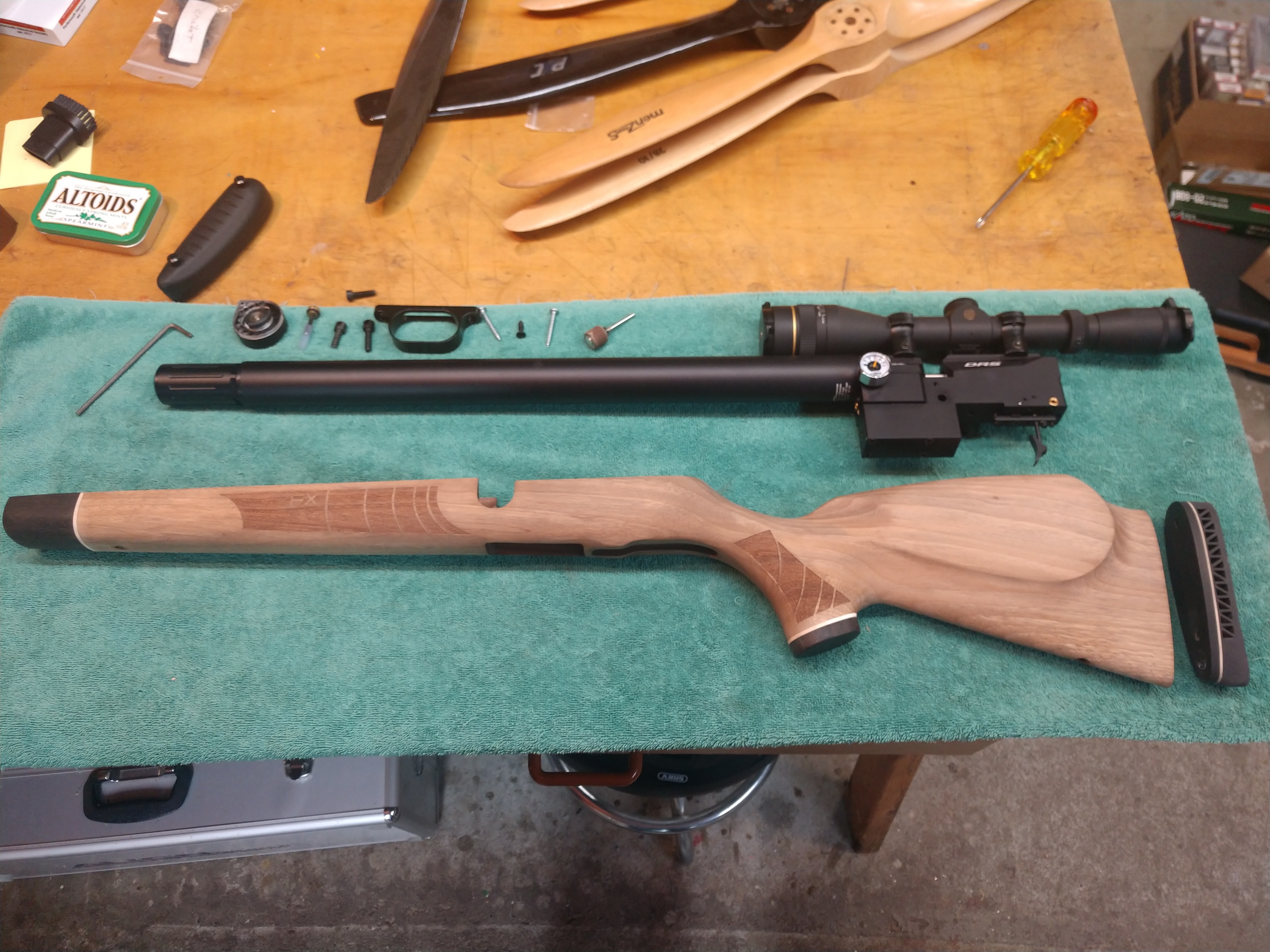

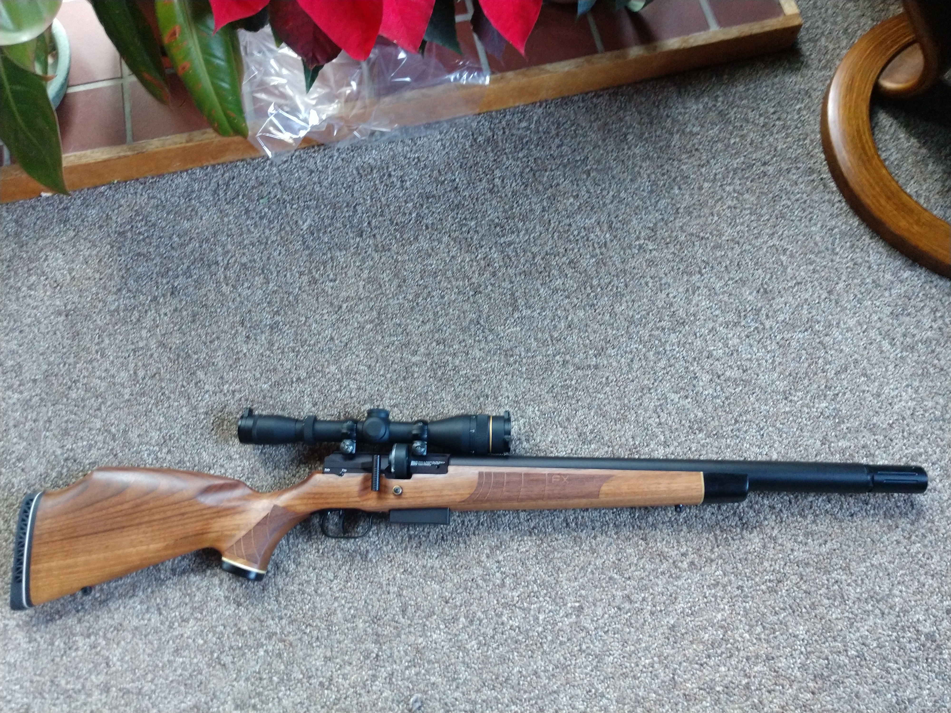

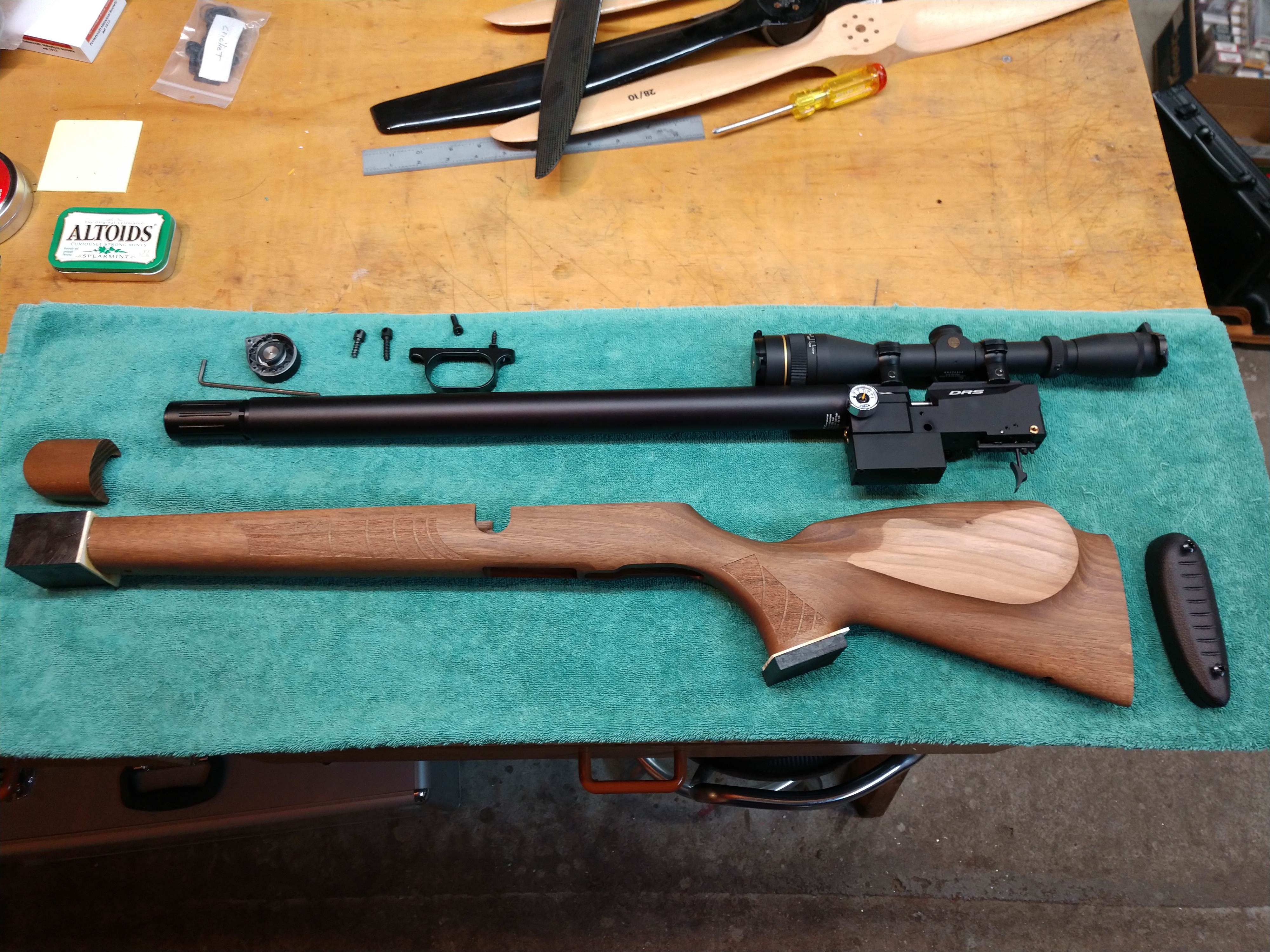

So, I decided to buy the Grade 1 from UA, and add some features myself.

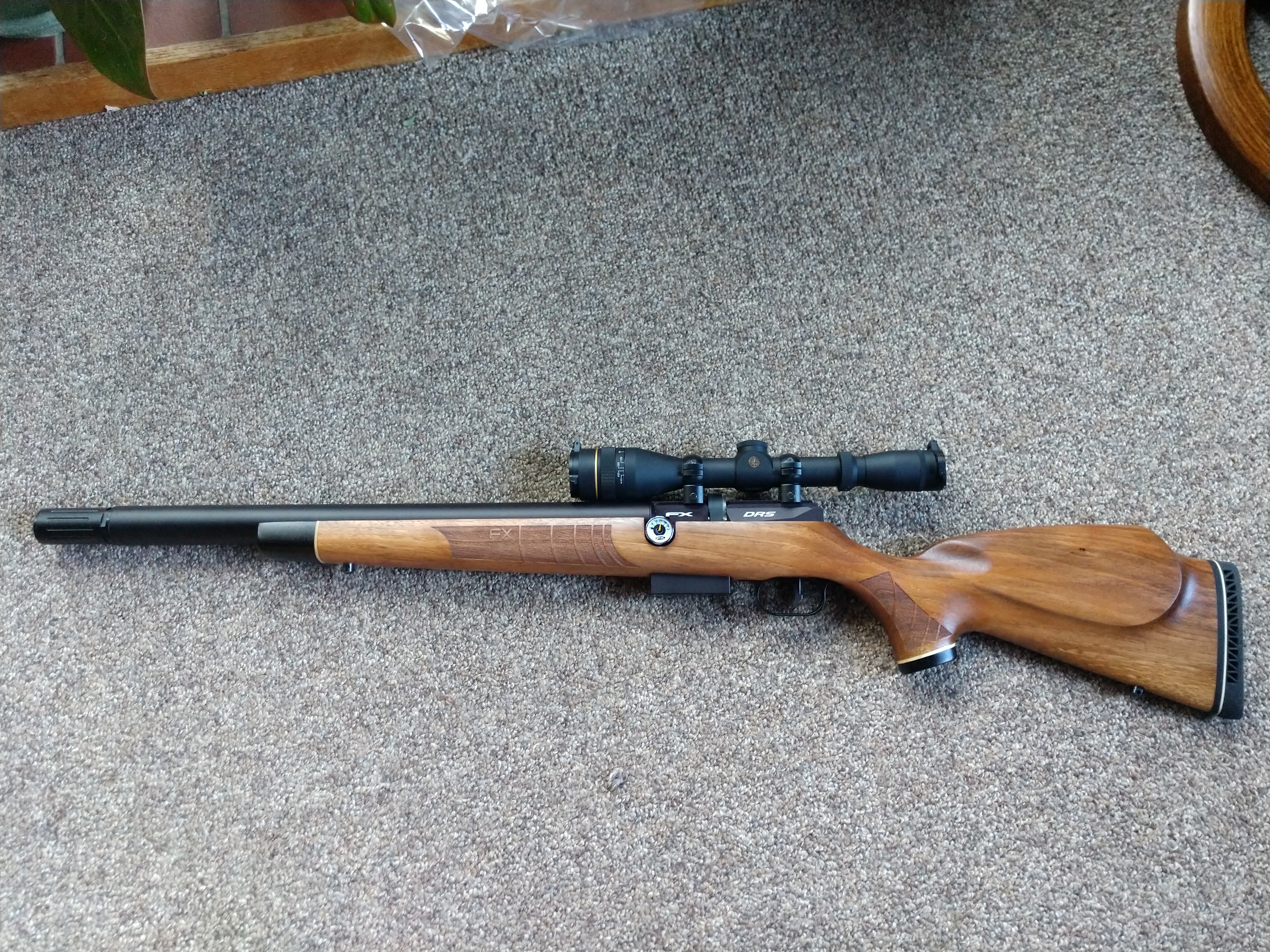

I went with Ebony caps, with English Holly spacers, on the grip & forend. Installed a white lined recoil pad, and front sling stud.

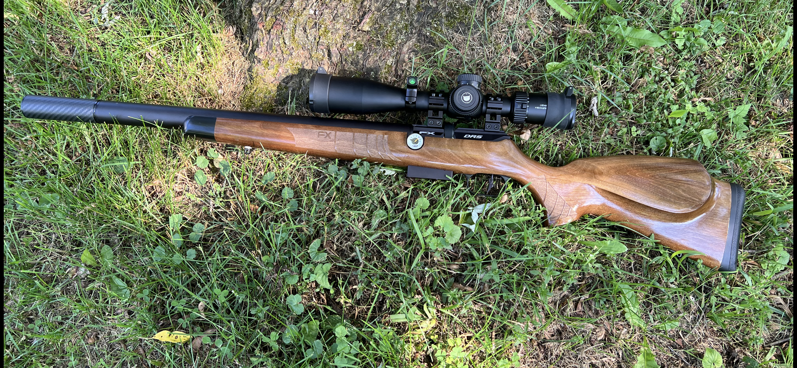

I'm really liking this new FX platform, and it shoots as good as it looks, (to my eye). Typical FX accuracy, and only weighs 5Lb- 15oz, with this light scope.
To help achieve this light weight....

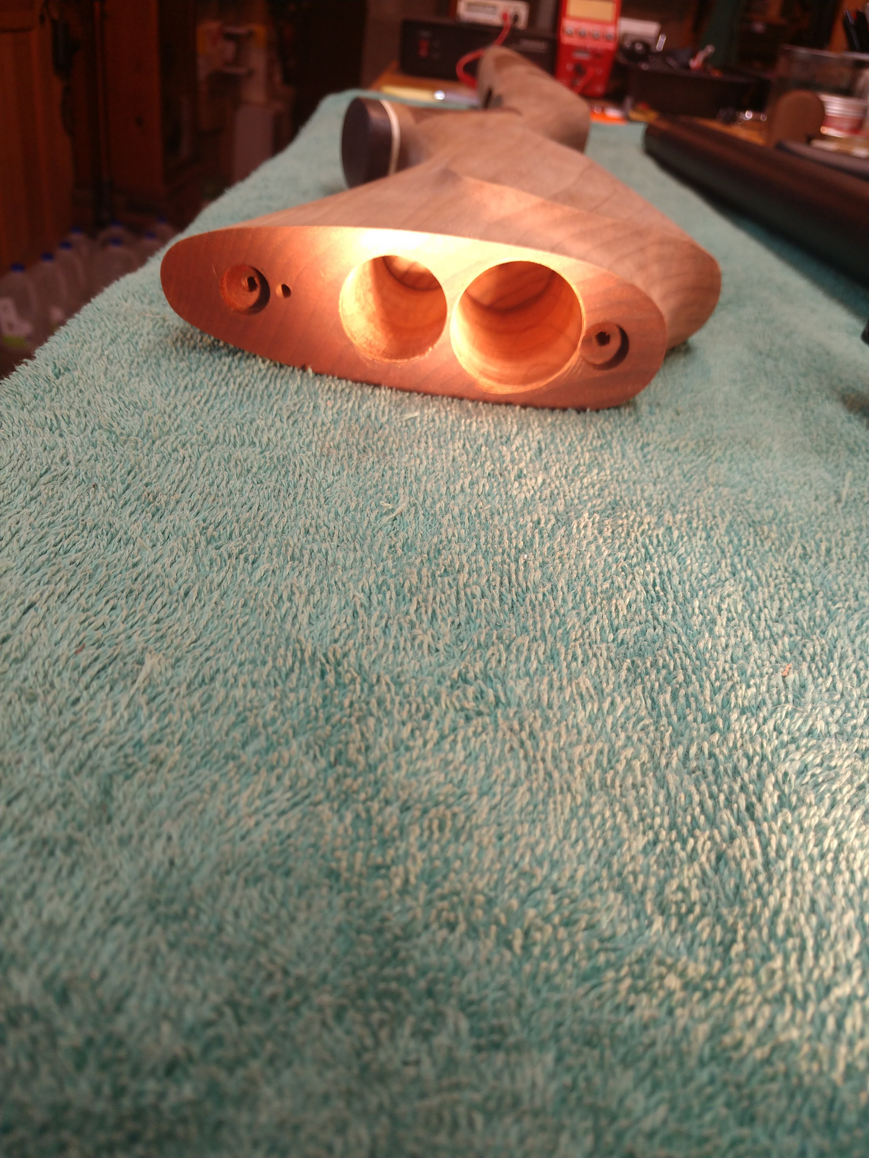

I drilled some large holes into the butt stock to lighten that heavy area up. (Actually saved 2.9oz with that). Also reduced the width of the raised cheek piece by 1/4". I kept the height the same. That gave me a better scope alignment, and also saved some more weight. The final task was applying four hand rubbed coats of Maccari Royal London stock oil, for a satin finish.
I'm using the Huma Mod-30 moderator, but only using the first section of the M30 to keep the rifle as short as possible. It only cuts the report by about half, which is acceptable for me. I don't have any noise restrictions at my home.
I wanted to share my excitement with this new FX rifle, by posting a few pics during the build sequence.
