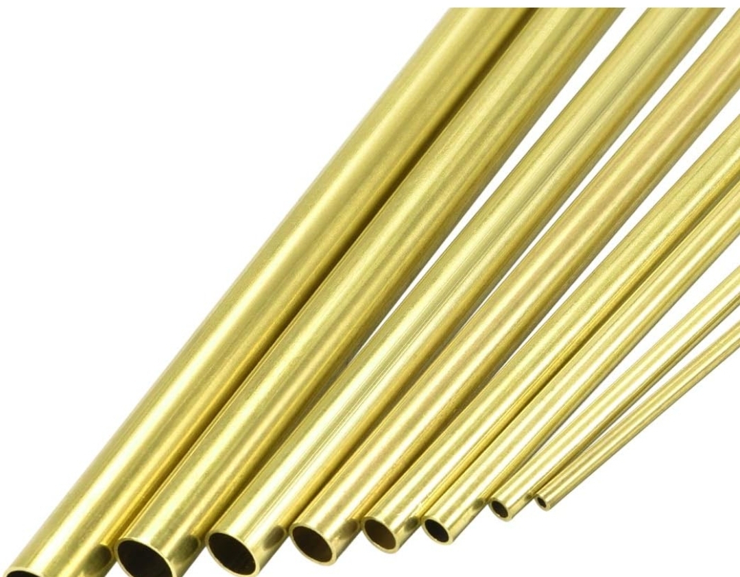

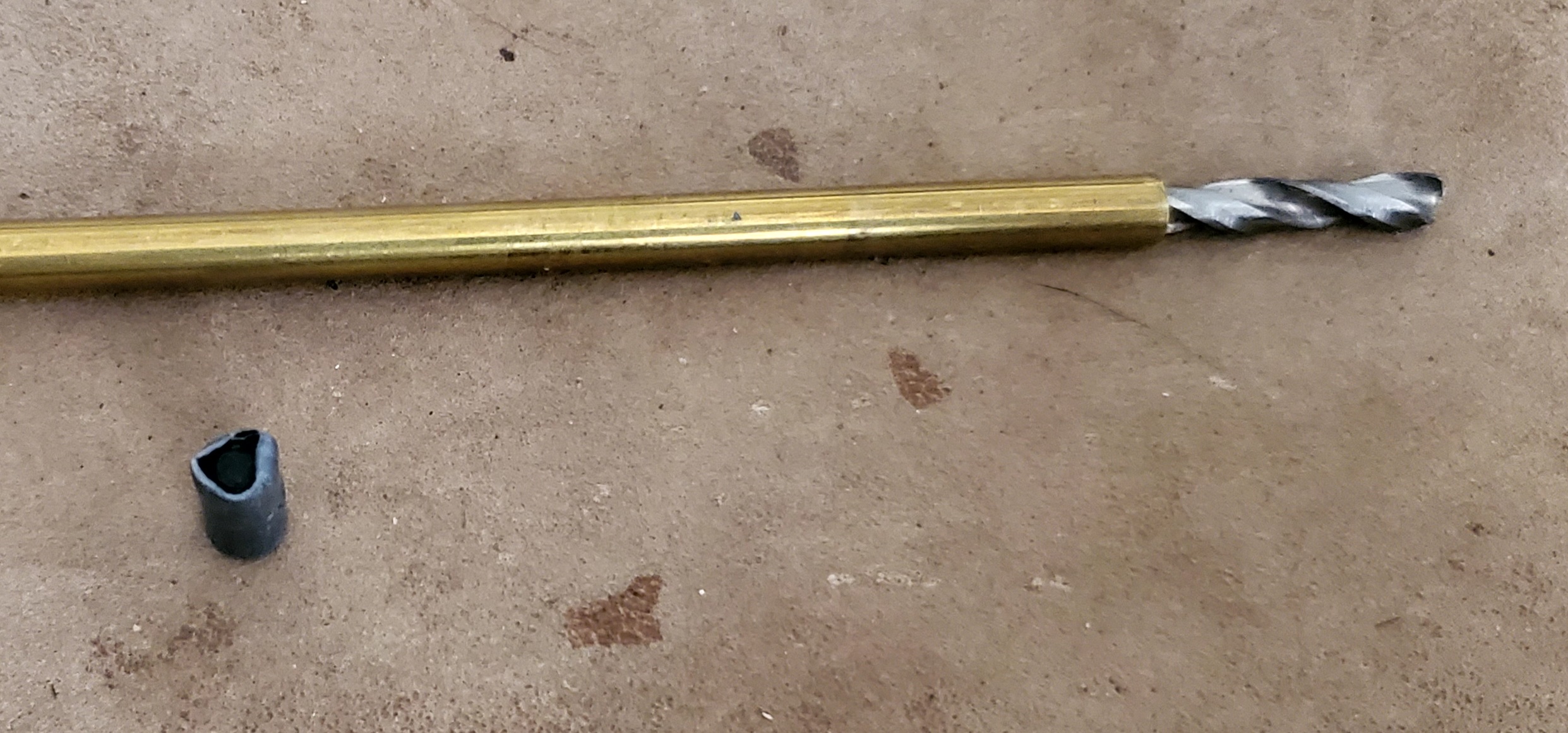

I think you got more than two stuck in there. Find a long thin wall brass tube that will fit into the barrel.

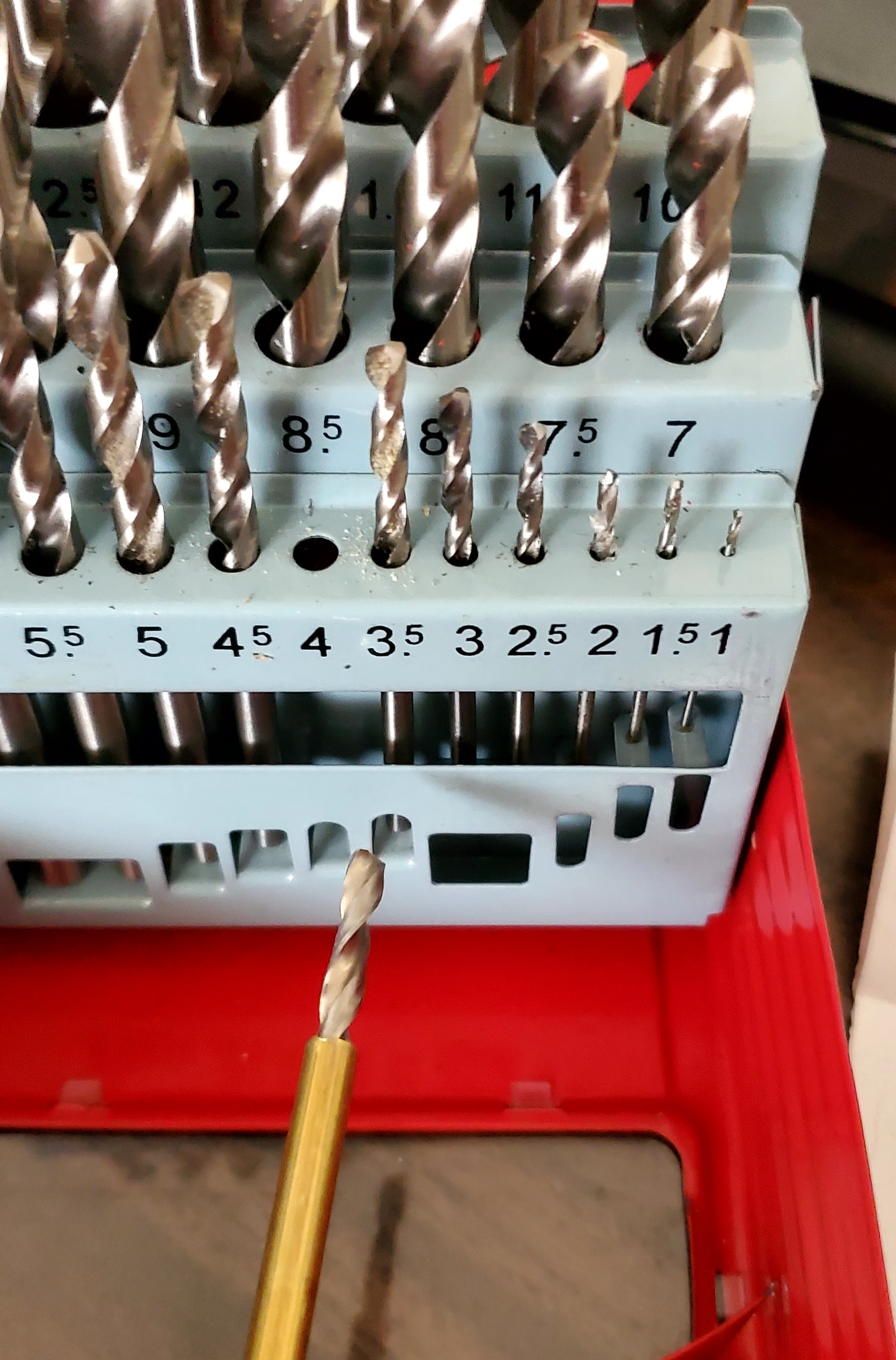

Then find a drill bit that will fit into the tube nice and tight without expanding the tube. Check to make sure assembly can still fit in the barrel.
For a .22 I got a 5mm brass tube and it so happens that I have a metric drill bit set. 4mm just happen to fit tightly in there.
Hand thread the tube holding the drill bit into the barrel cutting the lead out. Remove tube/drill assembly often and tip barrel to let out lead. Eventually you will get enough of the lead out that you can just push out the remaining lead out with a wood or brass dowel and not harm anything.

The brass tube will prevent the drill bit from touching the walls of the barrel.

I think you got more than two stuck in there. Find a long thin wall brass tube that will fit into the barrel. Then find a drill bit that will fit into the tube nice and tight without expanding the tube. Check to make sure assembly can still fit in the barrel.

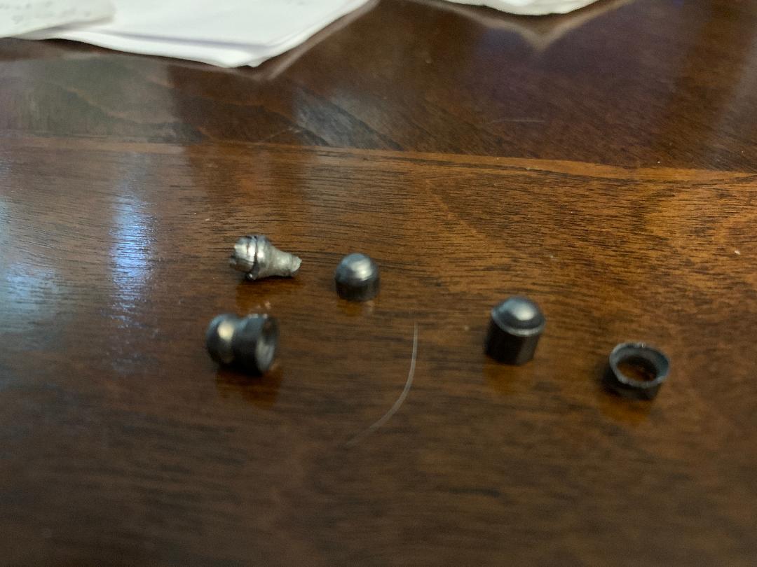

You were right there was more than one pellet stuck In the barrel , I found a aluminum cleaning rod that was a perfect fit but It took some effort to shift the blockage , there was some funky looking stuff that came out . All I can think of that the third mag was of the reg and not enough air to push the first pellet through . Just aired the gun up and shot another mag now all seems well .
