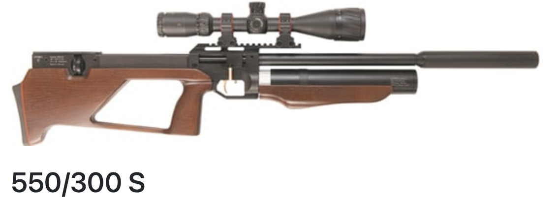

Well I sure as heck saw it in my Sapsan, happened after about 500 or so pellets, fill it up then every shot was 10fps faster than the last, fill up again and rinse and repeat. Shipped it to Joe B. back when Putin invaded Ukraine, haven't seen it since. Got yelled at for asking about it.
I don’t know what a Sapsan is, I thought it was the Russian bullet train…. I mentioned AGT, Cricket, and Taipan, all three are known for their top of the line regulators. Any others like the Peregrine Falcon I have no idea of their build quality.
Zaroia Sapsan, made in Ukraine, the company was/is a large producer of air guns, the thing was accurate as heck
