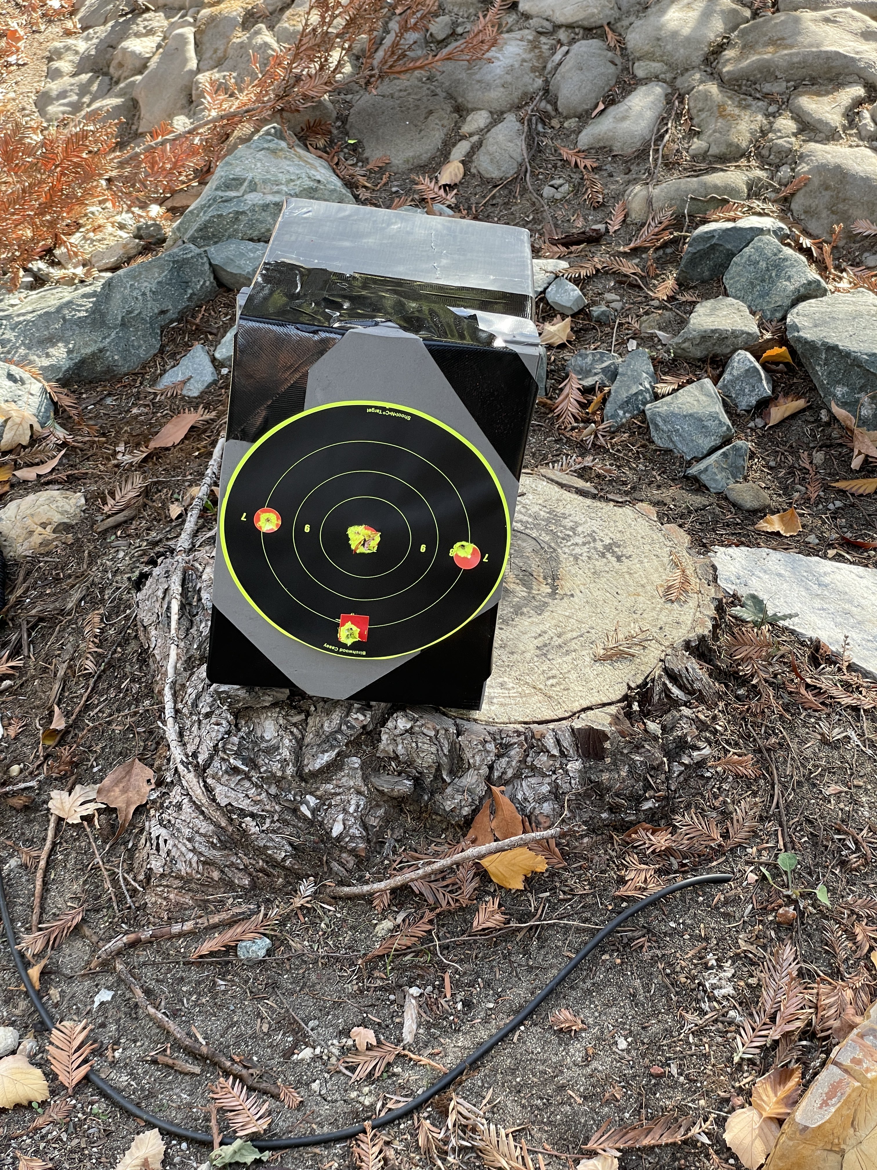

I stalk squirrel at varying distances in my small yard, at 8-25 yards. At this close range POI is very sensitive and I was having trouble hitting the exact spot I wanted

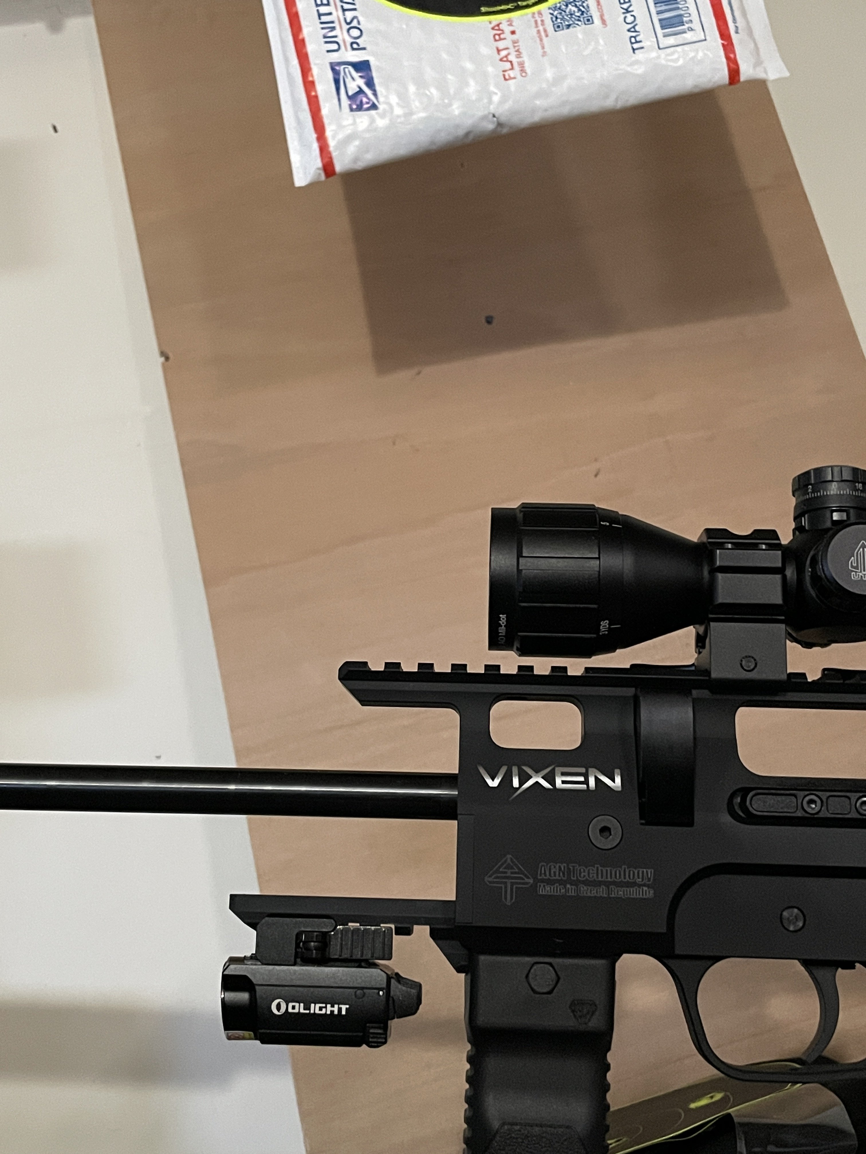

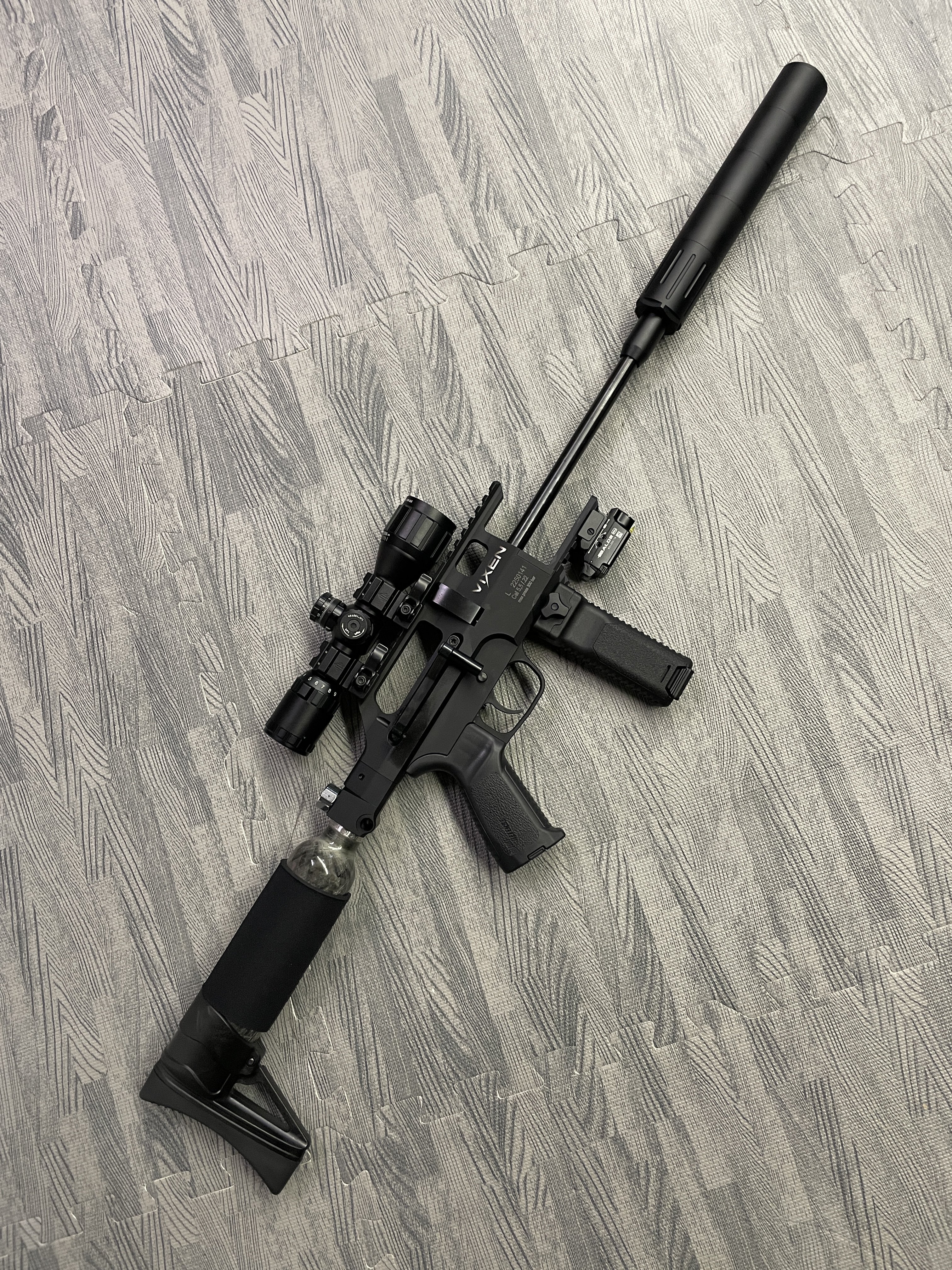

So what I did was put a laser under the barrel. Coupled with the optic on top, everything zeros at a set distance ie 15yards. Anything closer will show the laser below cross hairs, anything further will show laser above. Using this system I basically have a “kill zone” and since pretty much have my POI always between the two indicators.
I tested today and works great! No need to estimate range or hold overs!
Any top optic will work but I highly recommend the lower green laser.

You have a really nice setup. Love the Vixen with the OLight laser. In your system with the laser below the barrel, are you "bracketing" the target? i.e. centering the aimpoint between the laser and the crosshairs?
Your system is way better than mine! Yes I em estimating the point in between
