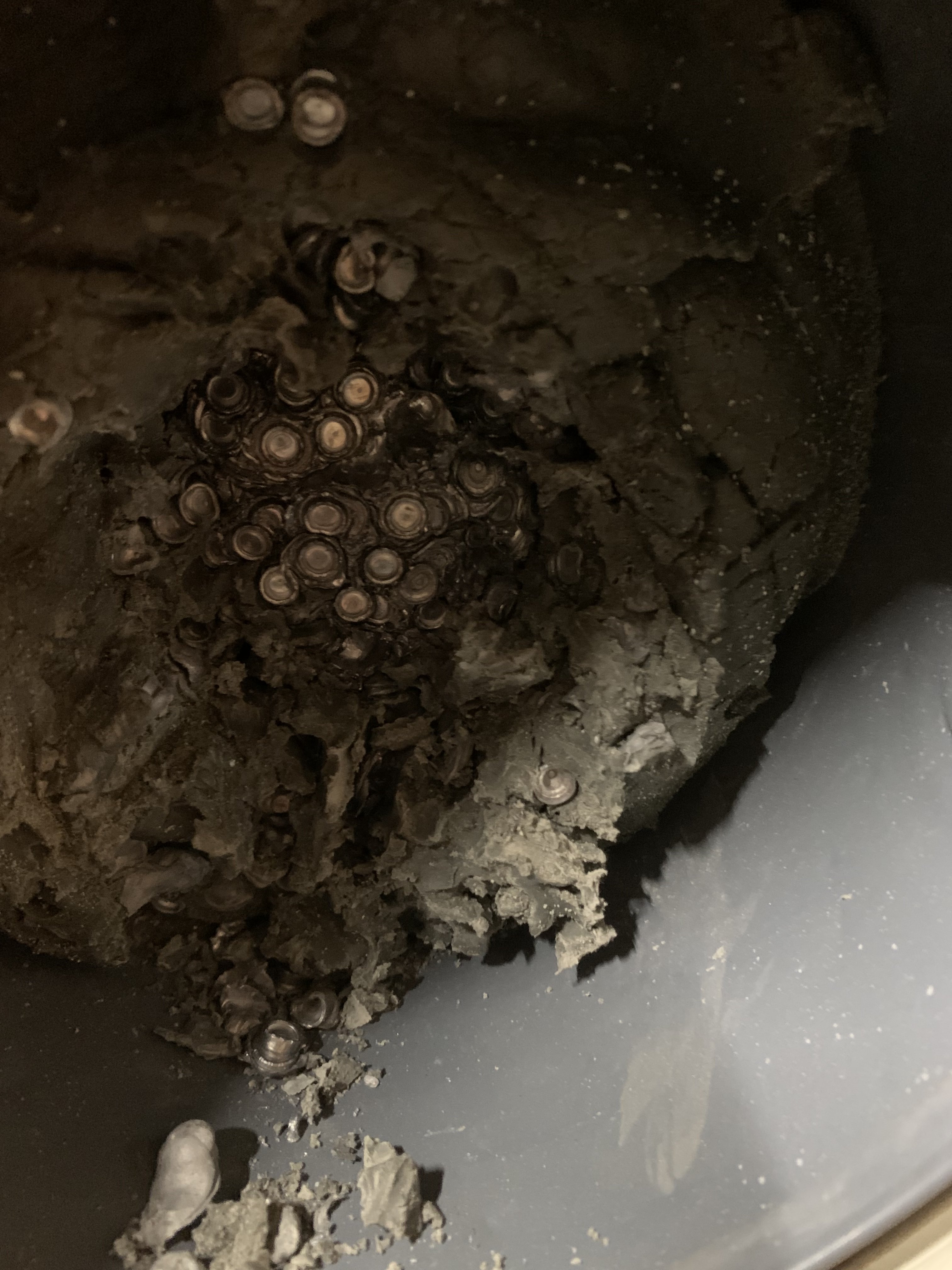

Duct Seal Solvent?
Fun stuff, totally awesome to light it on fire and play in the flames. (They're super cold flames, takes forever to burn you)
The issue with the more volatile solvents is their tendency to evaporate quickly. If I was using them, I'd either seal it in a can, or add something less volatile to keep it from evaporating as quickly.
I'm using covered glass containers for the small batch tests. Anything large scale will be outdoors believe me.

I would melt them as is, in an old pan over a cheap electric hot plate and skim off the top. Dit it outside and pour lead into an old muffin pan and make lead muffins about 1/2" thick. Use the muffins in Lee lead pot. I used to do wheelweights like that for my powder guns. dirt and steel clips float to the top in lead.
I can do better than that, got a LP gas burner I can rig up. The acetone and alcohol had zero effect. Will try the Goop-B-Gone then I use the nuclear option.

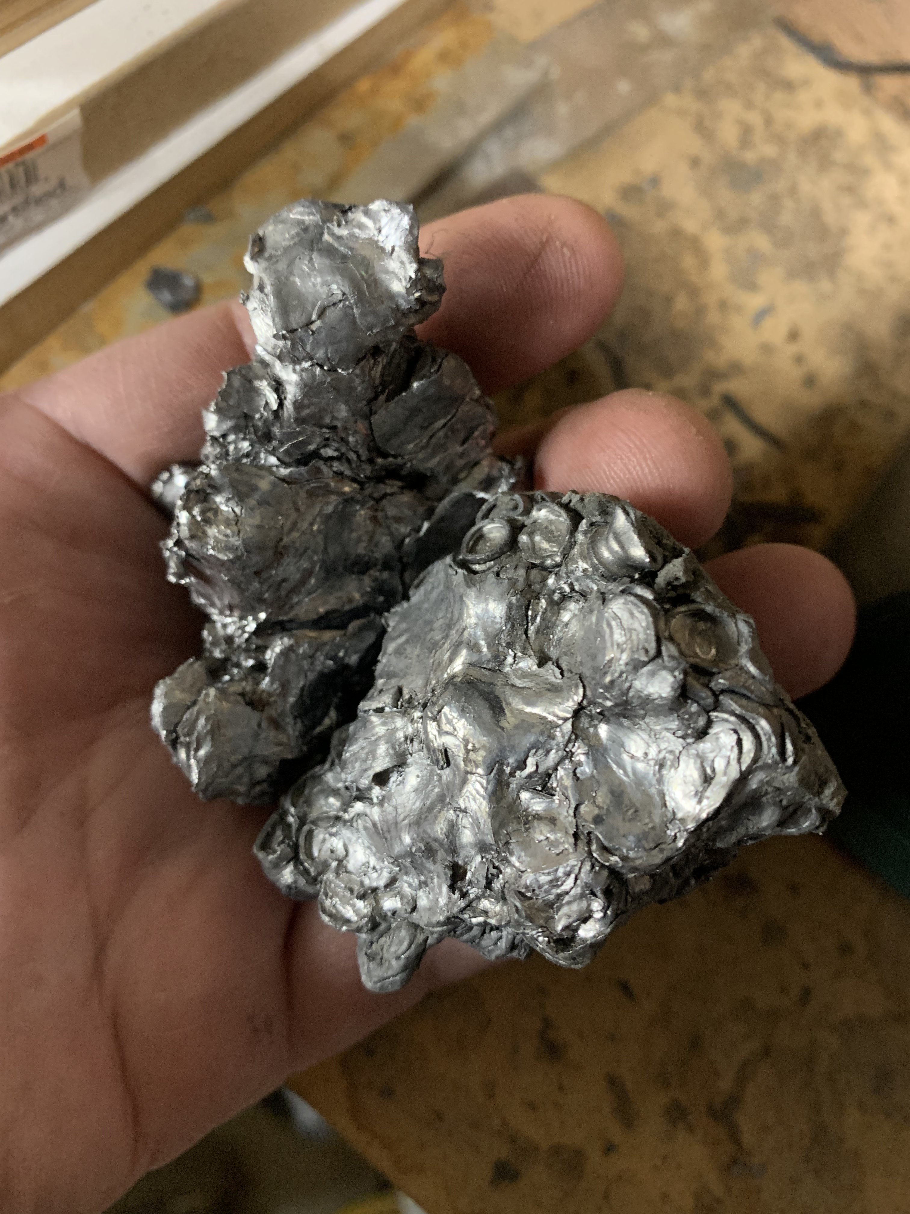

The Goo-B-Gone worked. Rinse in acetone and denatured alcohol then air dry. As clean as I can tell.
