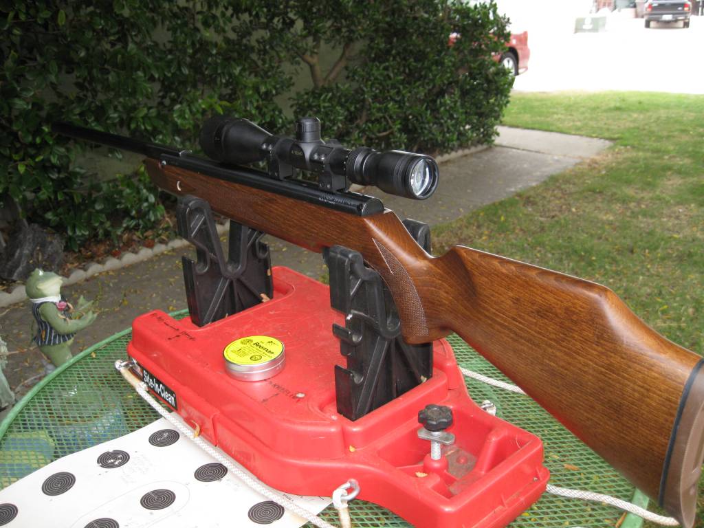

I just use my "minds eye" knowing drop is 2.58 " at 45 yards thru my Beeman 4x12 Duplex reticle scope.
