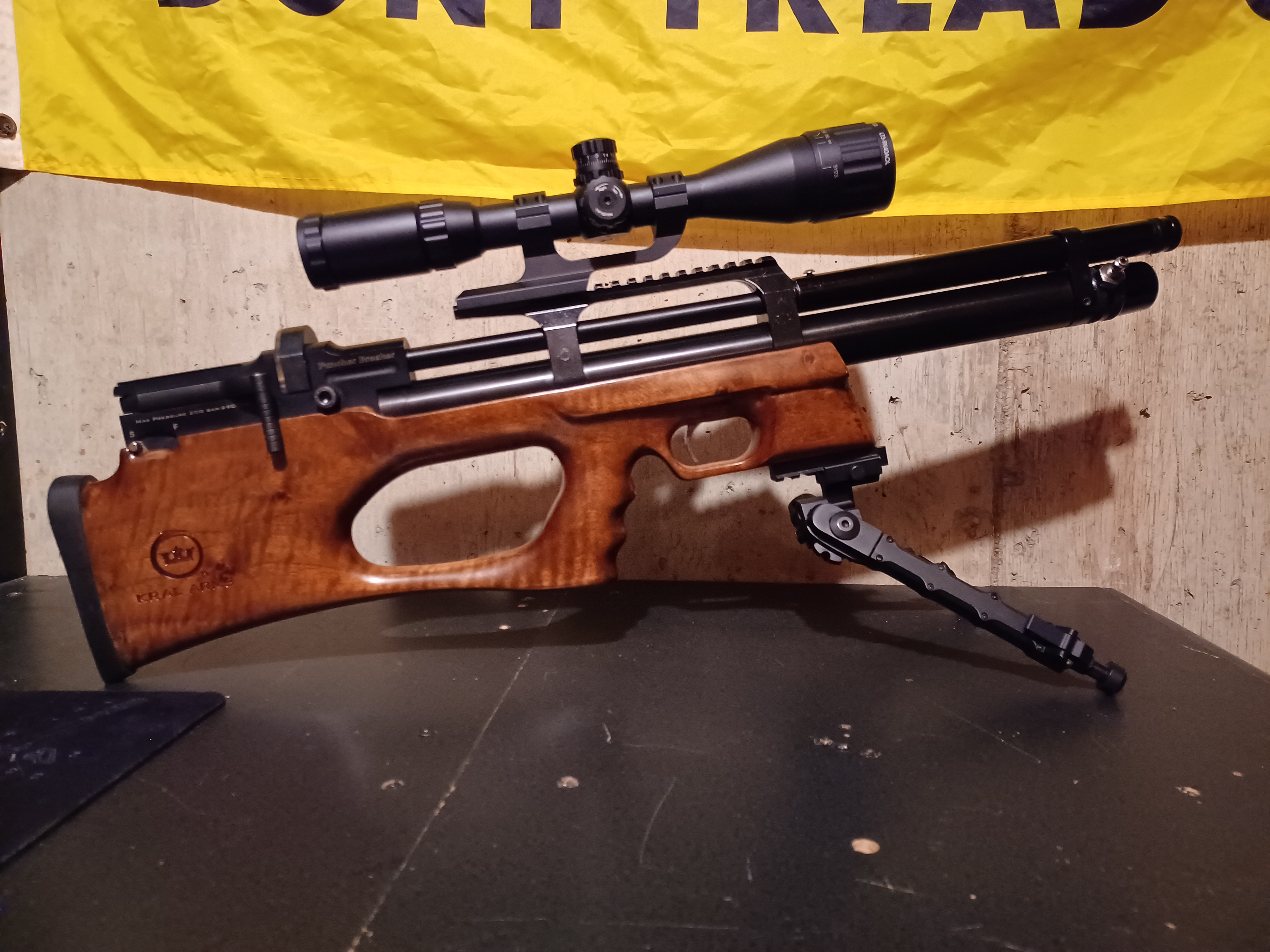

To get powerhouse levels you gotta have barrel length and/or high pressure. Just how it works. Best if gotten is my puncher breaker pup that's just under 27" and doing 60 shots at 35 fpe with hades 22s. Could be an inch shorter if I got a flat cap on the shroud vs the threaded one. It's fully baffled and has an air stripper.
Here's the issue. It's a PITA to cock because it's rear cocking AND has a dual stiff spring in it. I can shoot it just fine, but its not anything like factory. I also cut the stock down, put on a shorter barrel and ported it all out. It's shorter, quieter, better power and shot count than how they come new. Stacking hades at 40 yards so far.
It also STILL weighs 9lbs with the scope and bipod and really wouldnt be a backpack kind of gun due to the scope height. All bullpups are gunna get you in that department.
Nature of the beast for sure! Sounds like a critter getter! Maybe a bigger pack will help!
