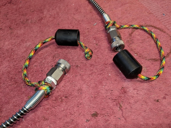

What do ya’ll use for keeping dust and debris out of fill lines when not in use? I’ve seen foster (8mm) metal plug caps available on various sites and “dead” head plugs for the female ends. I guess those would work. Any other options? I’m growing tired of wrapping plastic baggies around the ports.

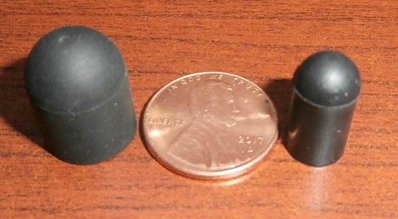

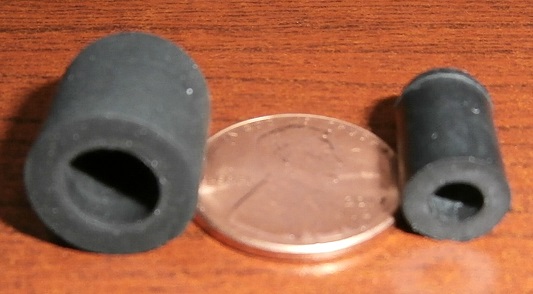

Rubber vacuum plugs from an auto parts store are what I use on both female (5/16" OD 3/16" ID) and male (9/32" ID 1/2" OD) fosters . Cheap, easy and if you loose one a replacement is easy to get. I bought a kit assortment from e-bay.
