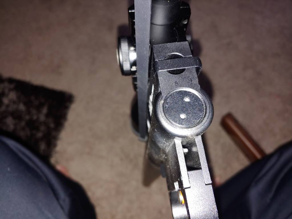

A view of the hammer spring adjustment
Well it looks like the shroud is an M18.5 x 0.75 thread.
I feel good about the thread pitch measurement...both 0.7 and 0.8 gauges slowly diverge while the 0.75 meshes perfectly.
I'm iffy on the 18.5mm figure. I expected an integer value. My end cap's major diameter measures 18.42mm (0.725")...too far away from 19mm to make sense. The tube's minor diameter measures 17.83mm (0.702") if that helps solidify it.
