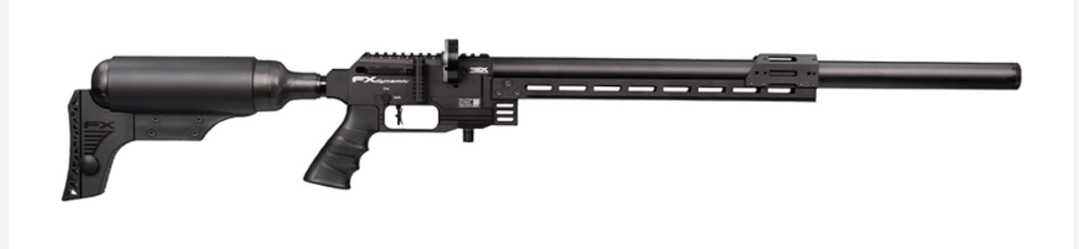

Would anyone care to explain what the difference is between the FX Airguns Panthera and the Dynamic? Is the Dynamic a Panthera?
I had a Panthera .22 and the Reg must have been broken. I couldn't get anywhere near the velocities others got at the same settings.
Please explain the advantages of a Dynamic, or a Panthera. Thanks

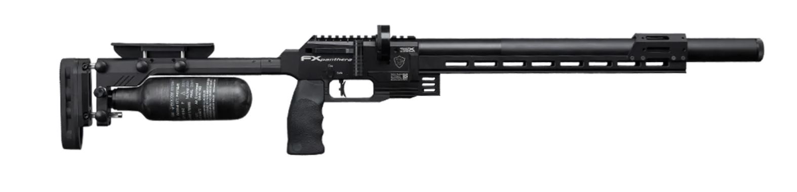

Panthera:

FX has been referring to the new breech/action as the "Dynamic". The Panthera is a specific configuration of the Dynamic series is how I would describe it. Both versions are modular and in theory you can make anything out of either with extra parts.

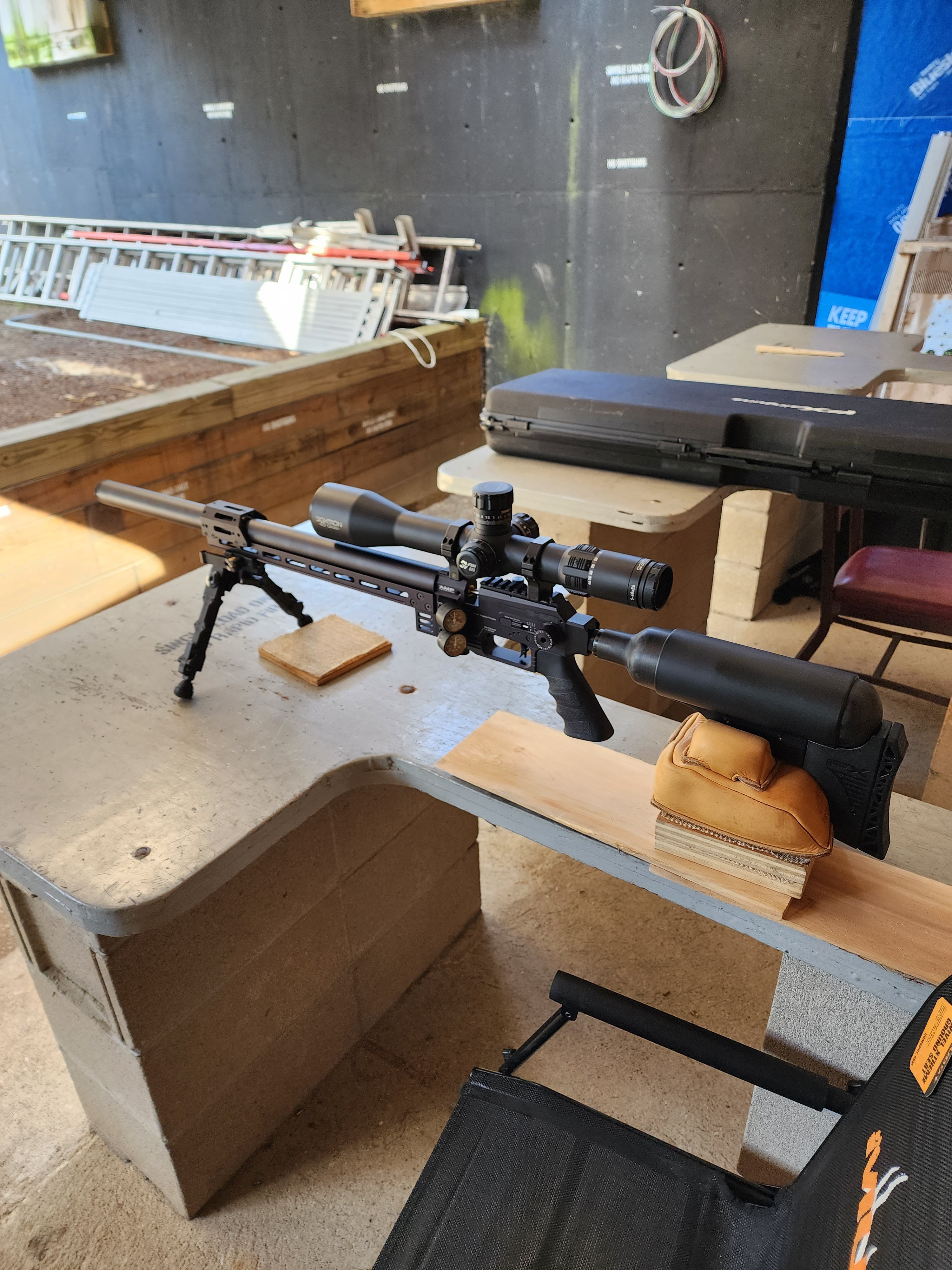

Yes, you can get a proper cheeck weld. The butt stock is adjustable for lenght of pull, cant and the butt pad is vertically adjustable.

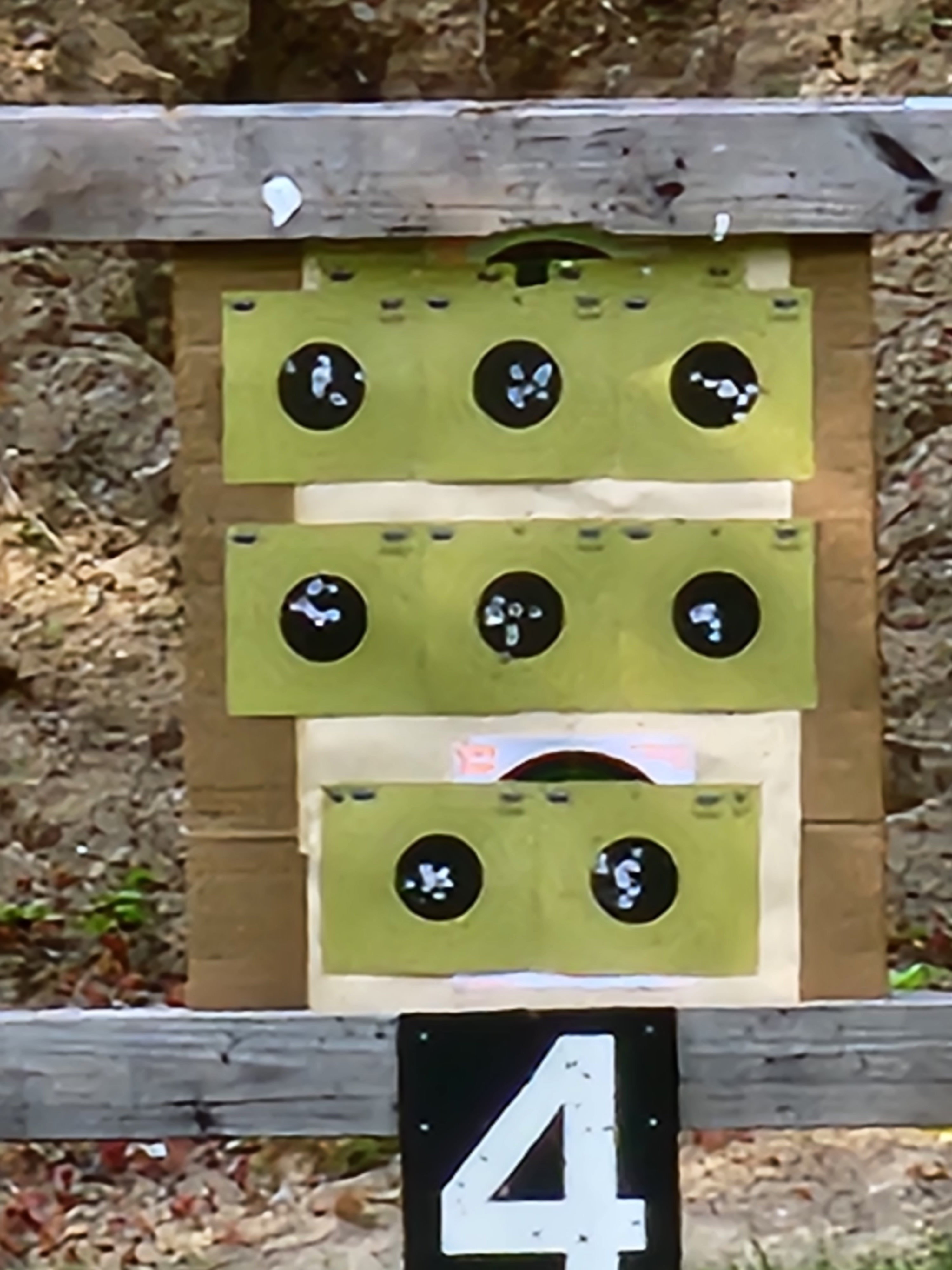

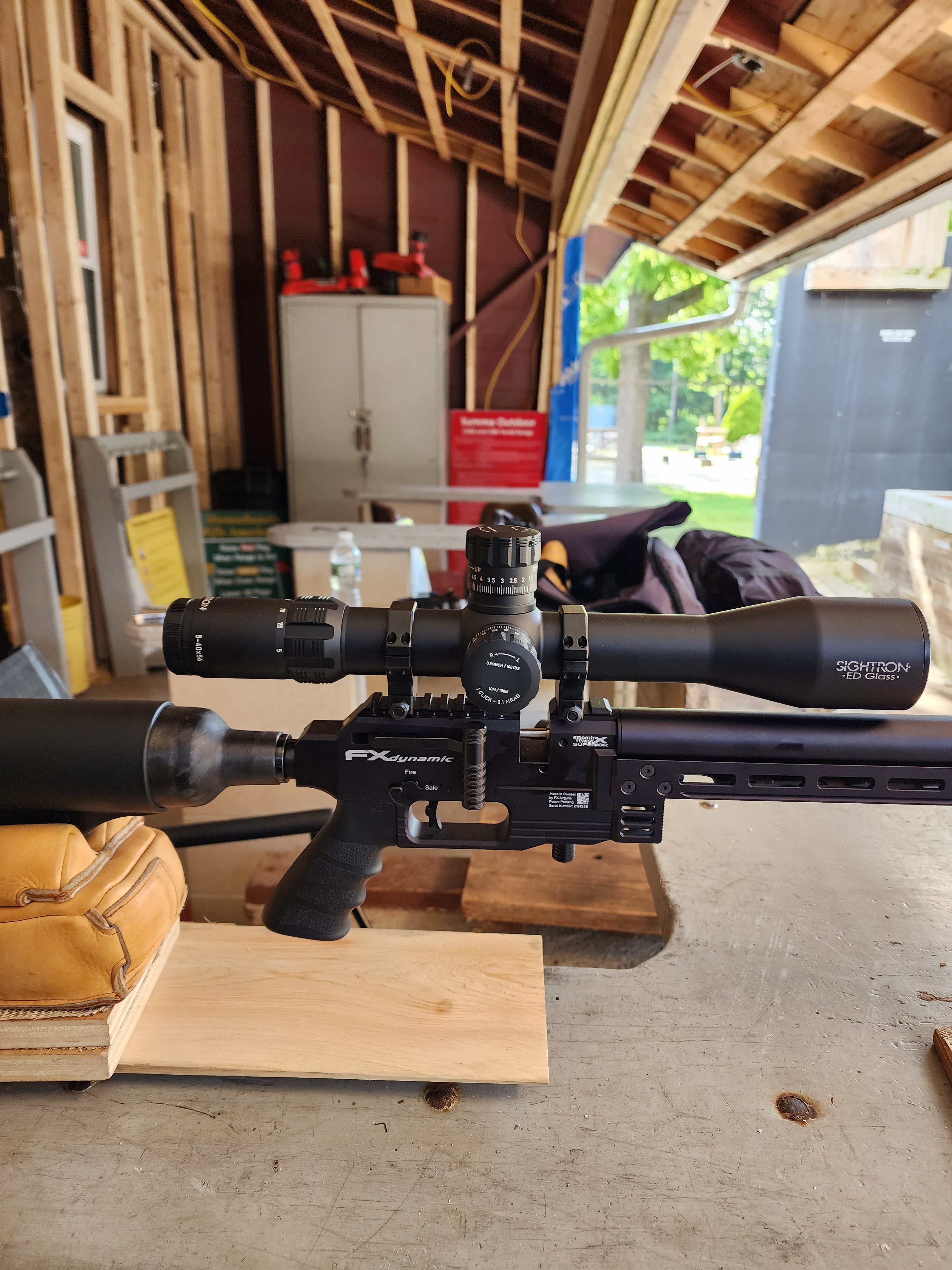

Mine is a .25. It shoots 34g FX pellets at 950fps out of a slug liner. The transfer port is wide open, hamner spring closer to 3 than 2, and the regulator is at 125bar. I get 50 shots on reg.
The last pictures are ten shot groups at 100yds. The PA Cup score was 224 4x.
On a side note. I've only cleaned the barrel and made the adjustments above. Otherwise this gun is stock.
