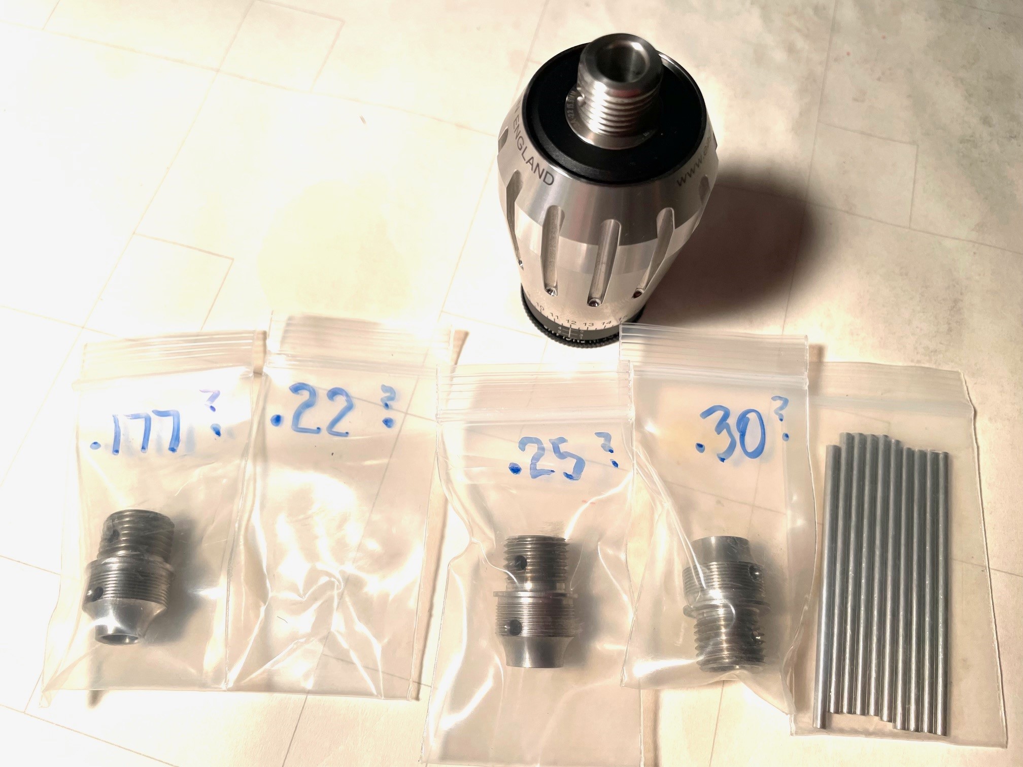

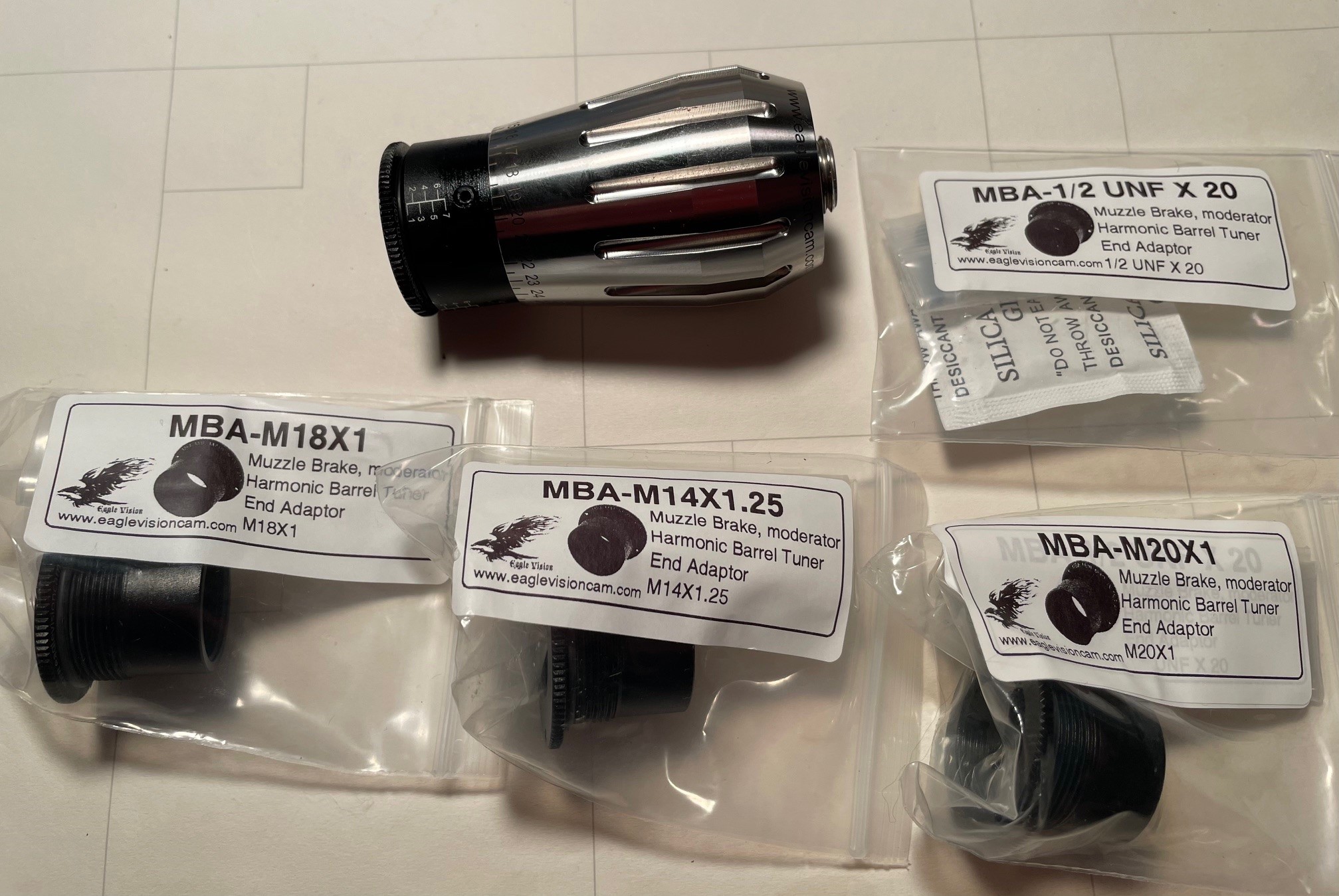

  • Where do the set screws included in the kit go? First, you pick one of the 4 "end adapters" from the kit that will screw on the end of your barrel or onto the end of your moderator adapter. I used the 1/2 UNF X 20. Screw that "end adapter" in snugly to the end of the tuner with all the numbers etched on it. Then, hold the black part (by the number end) and unscrew CCW the silver or black knurled knob a bunch of turns and about 1/2" up there will be 4 empty threaded holes. It appears to me the 4 set screws go in there to lock down the "end adapter" so it's solidly fixed in the tuner when you screw it onto your barrel or unscrew it from your barrel. ?? If that isn't it, someone please let me know, but they fit perfectly. Here's a picture:

    • I "believe" you install the proper "end adapter" to screw on your barrel.

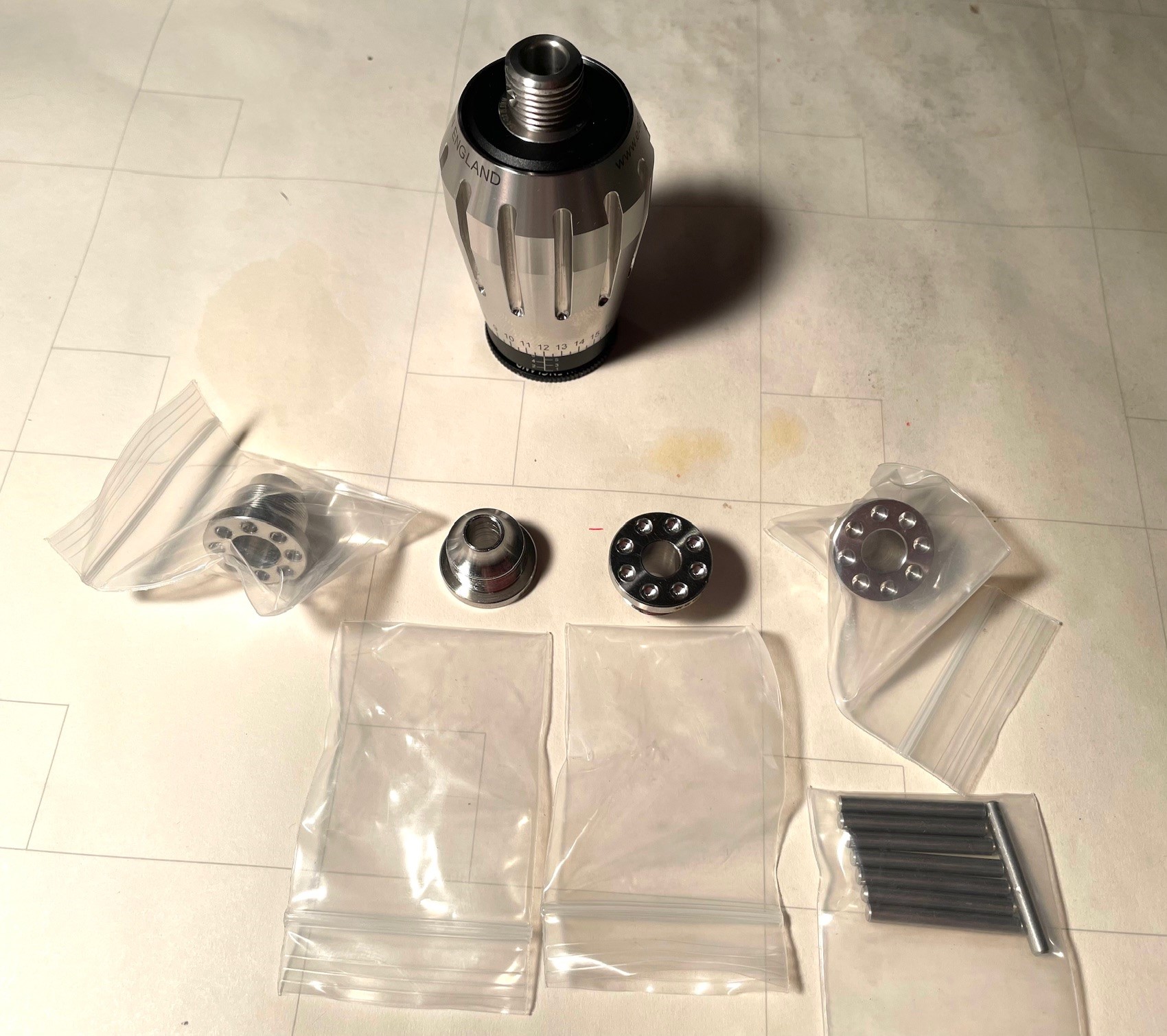

    • Then you either install the proper flat "end cap" for the caliber barrel you're installing it on, or, you use the "moderator adaptor" for the caliber barrel you're installing it on. Here's pictures of both those items. The weird little pins are supposed to fit through the drilled holes to assist in tightening the end pieces on. At least on mine.....it would be nice if the pins were actually the right size to fit thru the holes.

If you screw the adjustment collar several turns forward of the adjustment marks, you will find the holes for the set screws. The slender pins can be used to tighten the main body on to the black adaptor. The big pins are to tighten the caliber adaptor on the front end of the unit.
The front-end adaptor come in two kinds. one has a male thread to attach a moderator. The other kind doesn't. I have the second kind, but Eagle Vision sells a package of adaptors in four calibers for 25 Pounds.
