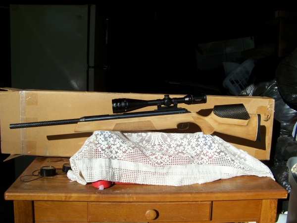

I've got my hands on a "new" Falcon multi-shot and thanks to Dirte's post (awesome looking), just ordered a Curly Maple tiger striped blank for the stock (I'm left handed and of course it came with a right-handed stock). Not sure if I should use Tru-oil or your Minwax Technique. I really been liking Linseed oil but with the light colored wood, I may want a higher shine.
What do you think?

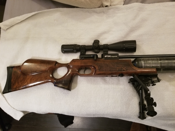

Hey Joe Wayne, just wanted to say thanks for the heads up about Tru-oil. I watched your video and ordered a walnut stock for my Royale, got it nice and dark how I like it. Also helped me fix some little imperfections with my other laminate stock.
Thanks again!
