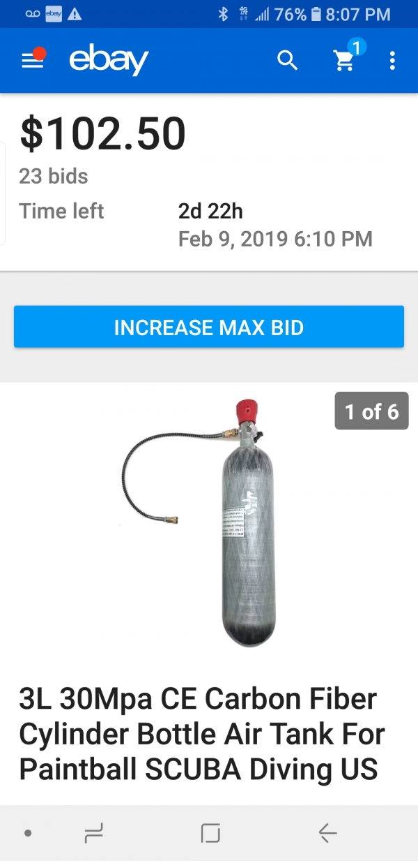

So i am Currently bidding on a small Carbon fiber Scuba tank....But im not sure if these tanks meet the US Requirements....this is the tank that i am talking about...i Looked at the same tank on Amazon and It appears to be this very same tank, a Customer who bought one gave a warning NOT to buy this talk because you cant get it filled due to it doesnt have the right Requirements for the good old USA....i am somewhat Relieved that i have been out bidded...i wouldnt pay no more than $135...just lookin for something that can hold me over until i can Afford a bigger tank....i have a big Scuba tank but its only a 3000 psi so i can only fill my gun up to 200 bar...can someone let me know if its a good buy...thanks

If you want to have a dive shop fill the tank, it has to be DOT certified and labeled on the tank. A tank with a CE certification won't do.
Most of these Chinese tanks don't have DOT certification, but there are some floating around out there that do. If you're looking at buying one of these tanks and it doesn't explicitly state its DOT approved, don't buy it with the intention of having someone else fill it. I don't mess with these Chinese tanks, so I couldn't tell you where to get a DOT certified version. I prefer SCBA tanks from Draeger or Interspiro even though I run my own compressor.

CE certification is what we use.

They might be fine but my local paintball field will not fill those tanks. I don't blame them. Who wants to take that kind of risk just so someone else can save a couple of bucks. Personally I don't want to be anywhere near
DOT is in US
CE is in EU
the tests “things” go through are the same
the quality of the “things” are 100% the same... so I don’t understand why they can’t stamp both certificates on “things” I guess it has something to do with money and paperwork.
CE and DOT are two 99% identical tests.
just a pond between the two stamps

LOL the day american standard organizations start accepting EU certification as comparable to US certification.. will be roughly 90 days after hell freeze over.

IF Acecare they are well know, ole mac-1 here in the U.S. has been know to sell them - for those in the U.S. it IS possible to get one with DOT cert but might have to purchase a pallet?- .

After looking around, comparing prices, weighing options, etc.
I decided to get a tank via eBay, and components from 2 other vendors.
In the end, I saved over $100, and if I have the tank pressure tested / certified,
any place will fill it.. I just opted to skip that part for now, and fill mine at home.
This is the tank that I went with:
https://www.ebay.com/itm/9L-Compressed-Air-Cylinder-Carbon-Fiber-88cf-Scuba-Diving-Air-Tank-USPS-Ship/283004776537?ssPageName=STRK%3AMEBIDX%3AIT&_trksid=p2060353.m2749.l2649
It is listed as DOT approved, and, I can confirm that it IS in fact DOT approved.
The quality is fantastic! I couldn't be happier with this tank, and, I definitely recommend them.
