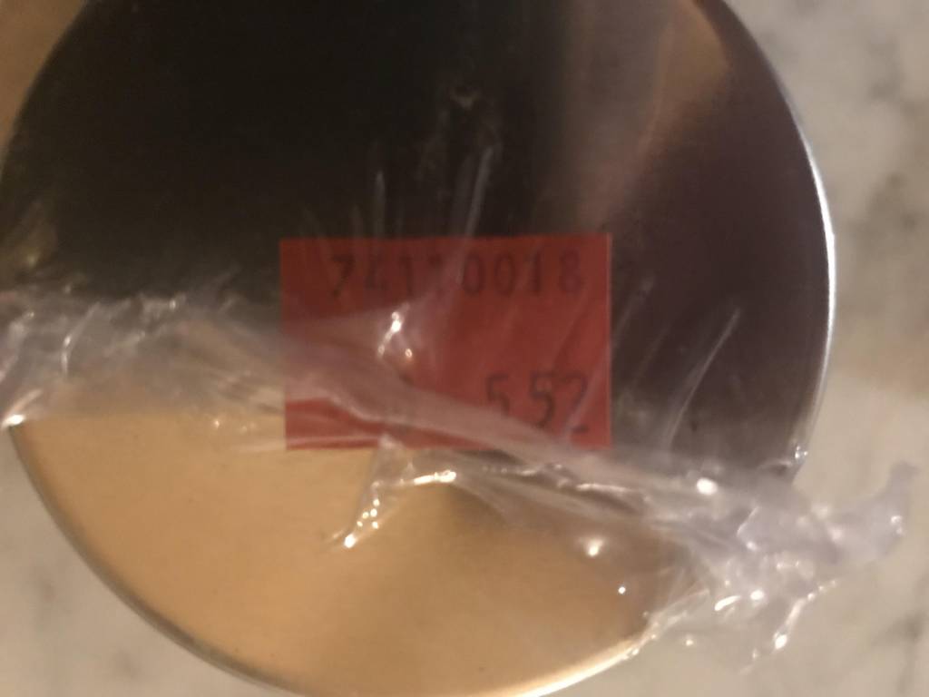

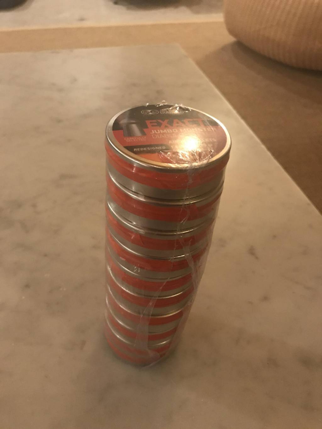

They don’t mix dies at JSB. All the pellets from a single machine are packaged together.
Die 13 177 monsters have been very good pellets for 5 years. Sometimes they do screw up their labeling. Retailers remove the die stickers from the tins because they don’t want people calling in bothering them for specific die numbers all the time.
Mike
As far as I know they all leave the Jsb factory with labels. I’ve never had any without. I import them directly from someone who drives and picks them up from the factory. Haven’t bought any for a while but this is how they come Sleeves of 10 tins
