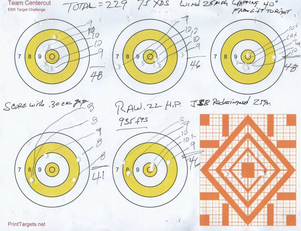

This target was shot in typical EBR conditions at 75 yards (the longest distance at my house; it’s also the qualifying distance for EBR). Head winds were 20-30 mph whipping back and forth at 40 degrees each way (80 degrees total); temperature was 90f. The winds at Rio Salado Range (EBR) are like a redhead, you never know when it’s going to go crazy (based on personal experience). One hour it’s beautiful, the next hour its nuts. The POA can be at the next target over. Anyone that has been to EBA will tell you to practice in as windy condition as you can! It would be interesting to see targets posted in high wind conditions to simulate EBR. Thanks Mike for setting this up, it's lots of fun, Stan
Note: EBR uses .35 cal scoring gauge, I used a .30 cal for this target,

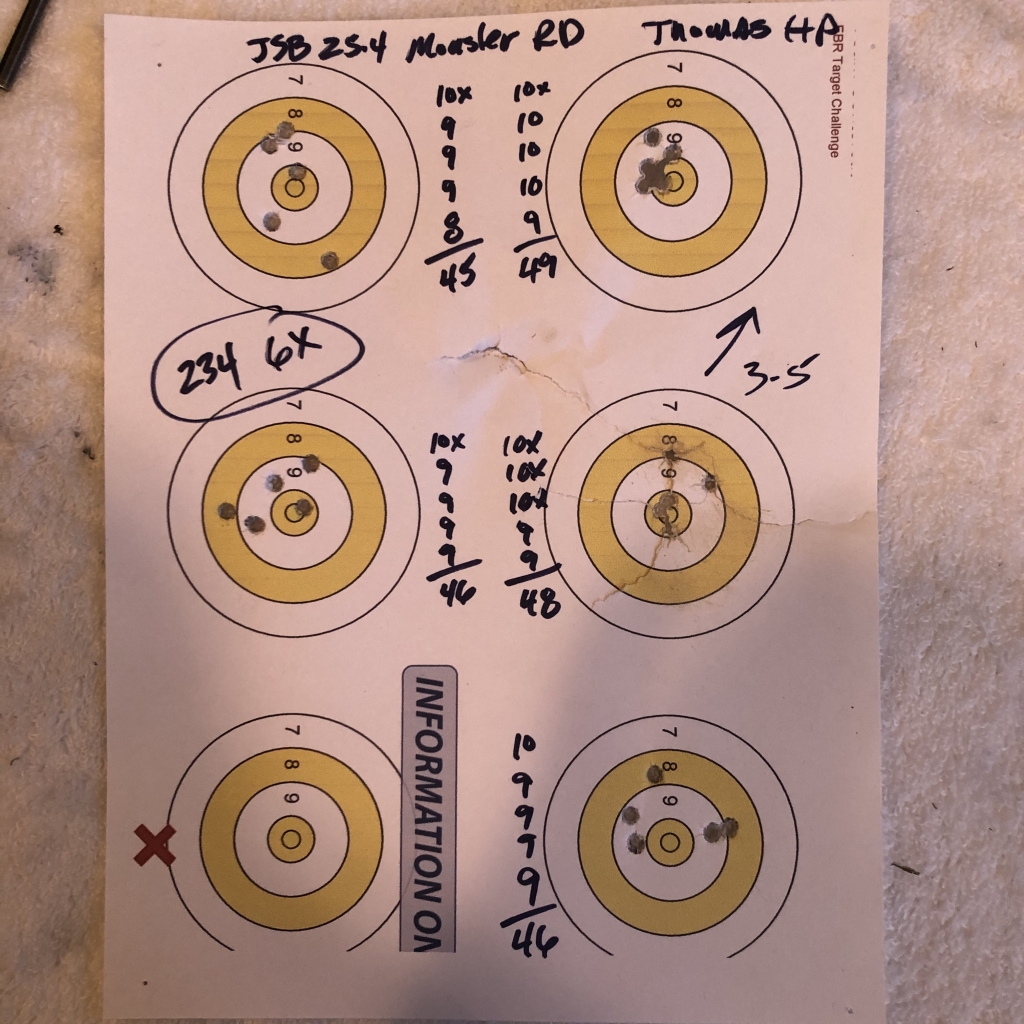

This is my best so far. I’ve shot 5 targets in total with my first goal to keep all 25 shots inside the 8 ring. I had 1 outside 😒. It’s 100y
Im really enjoying this. I usually just shoot away at my steel plate. With a single point of aim.
It has slowed down my shooting. Learning to be more patient and understanding a little better why slugs end up where they do!
As I understand it the shot must break the line to score? I used one of my .22 slugs as a plug to check the close ones.
Mike has set a very high bar with 237.....
More practice required 🤓
Nice shooting Michael. If your hole is touching the line it counts. So for your upper left target on the left side. The upper is an 8 and the lower is a 9. On the upper right target the lower center shot appears to be a 10. So from the photo it looks like you’re two points higher than you scored yourself. The hole doesn’t have to break the line, only touch the line. I need to try some slugs this weekend and see if I can get close to Mike’s score. Yeah, and when pigs fly... ;)

Took 2 tries this morning with Thomas HP 22 shooting JSB slugs at 925. The other card was a 236 7x. I need to focus a little more and I think 240s will come. This actually mimics the precision of 25m somewhat...unlike pellets. I shot no more than 2 sighters per card. I waited for conditions and adjusted holds only on flag position when I couldn’t get the condition I wanted. Still...both cards were shot under 15 minutes each. I think this could possibly be competitive with Rimfire at 50y. I will try it when I get a chance.
Between the 2 cards I shot there were six 5 shot groups under .550” Center to Center.
5-8 mph wind

I wonder why those two shots hit so low in the right middle bull??? It'd be interesting if you used a chrono next time you shoot this to see if the fps is lower when shots hit lower.
I just don't understand why it's so prominent that slugs have such big flyers that ruin groups??? I experienced the same thing when I shot slugs out of a RW.
Steve, I've got some chrono data from slugs and pellets for an upcoming write-up that is directly related to your question here. Very interesting and Ive been pondering on it for about 36hrs now. It only gets more intriguing the more I think about it. (Sneak preview, you're onto something, and I was able to capture it with a chrono and document enough about about it to see some trends)
I'm looking forward to that. Anything that I can glean is helpful.
Steve, those were not flyers. They did what the should have. I just missed the wind. It was moving between 9:00 and 11:30. I shot both of those as if they were 9:00...but I did not see that the flags had flipped to 11:00. I have shot very little outdoor BR since 2016. I’m no where near being on top of things right now. This is precisely why I’m certain I could get into the 240s pretty quickly. If this target was plugged, it would already be in the 240s.
This setup has a pretty big slant. 10:30 L to R wind pushes the pellet down at almost 45 degrees. 9:00 pushes down around 20 degrees. 11:30 goes nearly vertical. The velocity spreads for 40 shots were around 10. Not flyers at all.
Mike
Interesting that a wind change would make those two shots drop an extra inch with slugs?!
