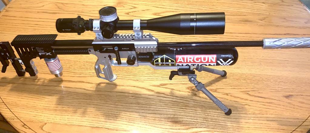

My Impact is the gun I shot the 238 9x with the other day. I was leery to do it because the gun was dialed in and shooting very well but my carbon fiber tube finally arrived after 2.5 weeks, so I used it to tension the barrel and hopefully reduce any remaining vibration. I had tried this in the past with not much luck so this time I got thick carbon tubing that it much more rigid. I’ll test it tonight or tomorrow morning. For now, I can tell you that it is definitely a lot stiffer than it was, a lot! Whether or not that equates to improved accuracy, we’ll see.

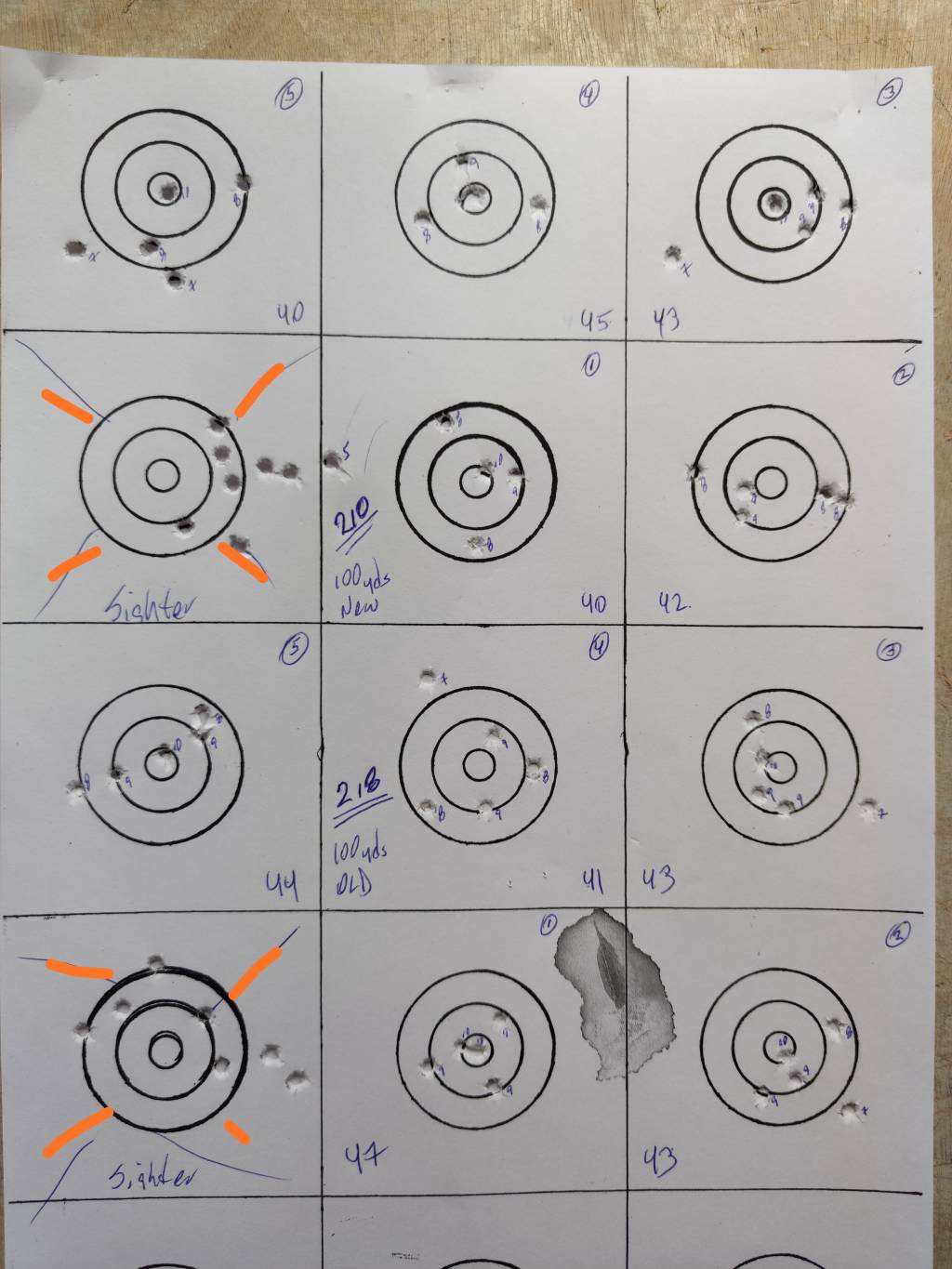

Here is my 100 yds try. I had a bunch of cards which I use for practice, they have the same size as the EBR.
RTI prophet 22 cal shooting Jsb RD Monster old and new design. New at 985-990 fps and Old at 995-1000 fps.
210 with new and 218 with old design.
I hope I scored it well.
Wind was 3 to 5 mph from 8 to 2 shift due to orographic issues at the place.
I think this could be the best I can do with this AG.
I will try tomorrow at a different range to see how the score goes.
