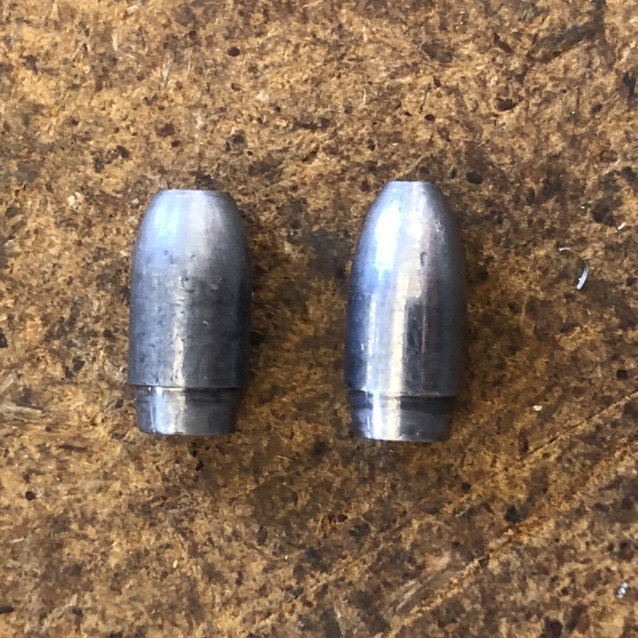

Thanks...3s 40.2 gr boattail .223 shot from a Muller 4 groove MI barrel. Thomas BR rifle. Slug on the right.
Mike
Hey Mike,
Just out of curiosity, how does that Muller barrel shoot the 25.4 Monster RD’s?

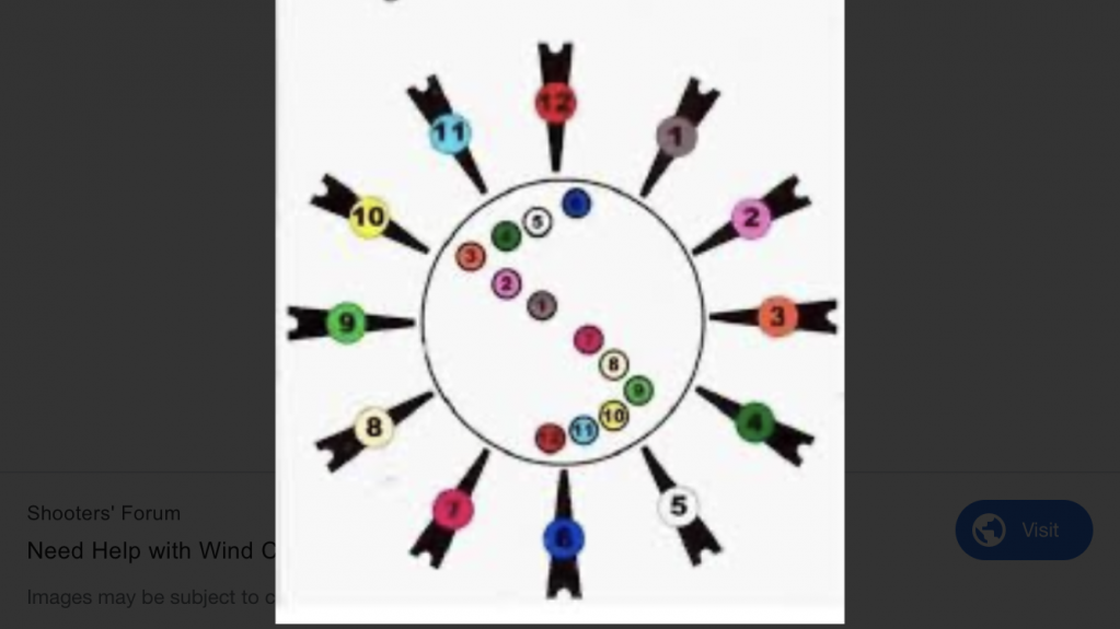

Take a look at this chart. This is a Rimfire wind rose, but it is pretty close to what I’m seeing with slugs.

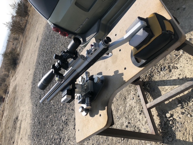

I’m shooting free recoil from a front rest and rear bag. I touch nothing but the trigger and trigger guard.

Hey Mike N. Happy belated Thanksgiving.
Can you explain ( clearly ) how to use/interpret this wind rose? My assumption is that depending on the wind direction on the wind rose, ( let's use the number "1" in this example), does this correspond to the number '1' inside the circle? And, is this generally where the pellet will land inside the circle ( bull? ) ? I realize this is heavily dependent on wind speed, but I want to understand the idea/concept.
I'm sure I have it wrong, but I'm trying to learn how to use this as a guide with 100 yard Bench Rest. Assume nothing here, and I am slow with wind reading.
Thanks, Tom
You have the understanding of use correct.
The problem is that the chart is for a spin stabilized projectile from a RH twist barrel.
Pellets from a RH twist barrel will rise in a left to right and fall in a right to left.
If you mirror that chart top to bottom it will be more correct.
These charts only going to be a suggestion, really. Different barrels, power levels, pellets, and distances will yield different results. You are going to have to figure it out for your own combination.
If you want to learn the subtleties of the wind, you are best to shoot at much shorter distances where you will get proper feedback each shot. 100y is too far for that to happen with a pellet. The best you can do is make educated guesses. At 50y with a good 50 plus fpe gun and pellets you can learn about this stuff.
Mike

Had two wind flags out today at 75 and 95 yards in a 3-5 mph wind. Shot several 100 yard and 75 yard EBR 8X11 targets at my local outdoor range. Had a 206, 208 and 214 at 100y. Also had a 230 and 217 at 75Y with Safari .22 HP shooting MRDs and Knock outs.
Might move back to 50Y next week and try your suggestion.
Thanks for responding
Tom
Hi Tommy...flags that far out will not help you much. If you put a leaf blower on full blast just in front of your muzzle....you would see that it would blow your pellet way off course to 100y. If you then put the leaf blower at 99 yards in the pellet path...you would not see it move the pellet any. Once the pellet is blown off path by wind it will continue on that vector even if there is no wind at all beyond where it went off course. It’s path has changed forever.
if I were to use only 2 flags for 100y, I would place them at about 18y and about 72y. Each of the flags would then represent a zone of about half of the overall drift that will be seen at 100y. If one flag is facing right and one is facing left at the same mph velocity...the pellet will not move in windage. This is settled science...not opinion. You can research it on your own if you would like.
